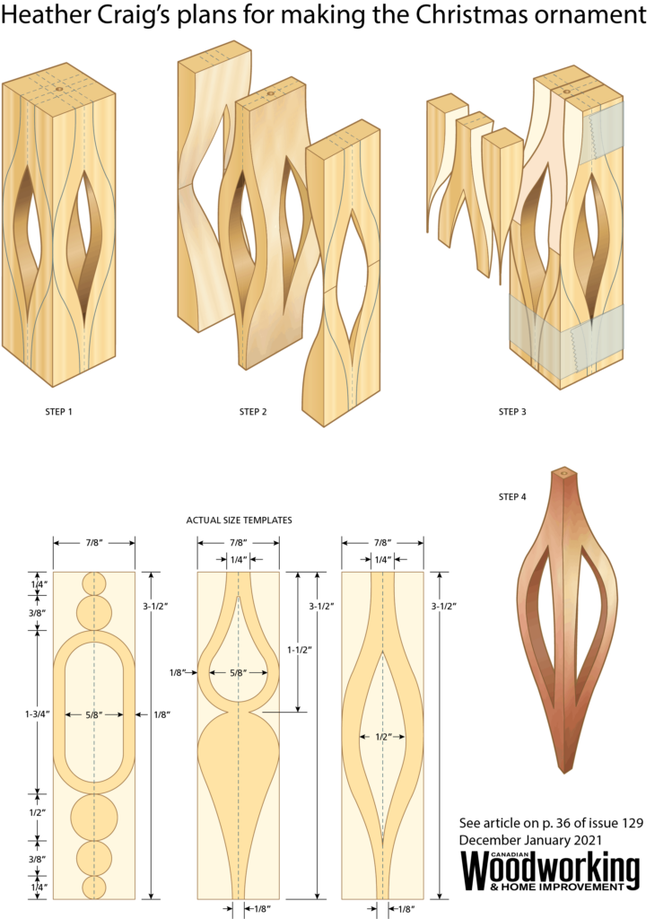

The traditional ornament pattern I have selected is 7/8″ wide by 3-1/2″ long. Cut a blank to that dimension. I tend to have several cut-offs from other projects hiding in the corners of my shop. I start with a piece at least a foot long, rip it to within 1/16″ of the width, then put it through my thickness planer, bringing it to the final width.
Fold the pattern along the length and position it on the blank. Verify the pattern doesn’t extend past the edge of the blank. If it is slightly within the edge, that’s okay, but if it extends past the wood, either cut a new blank or change the size of the pattern. Use spray adhesive to glue the pattern to the wood. If you’re making more than one ornament, glue several patterns to the piece. Leave at least 1/8″ between them to allow for waste when cut to length on the mitre saw.

Even though thinner blades are generally recommended for thinner wood, they can still be used in thick wood. I used a #3 to cut out the more intricate portion of this pattern. Don’t force the blade. It takes a bit longer, but it will get the job done. It won’t make the corner in one swoop, but there is a way around that. I cut into the corner along the line, then back out slightly. Cut into the corner again, but to the open side of my original cut, the width of the blade. Then back off again. Now there is enough room to turn the corner and continue along the line.

Now that you have the right blade and transparent tape at the ready, cut out the center of the ornament and discard the pieces. Using the cuts you made earlier, at the top end of the pattern, cut along one side. Put the piece you just cut off back and tape it into place. Cut off the piece on the opposite side and tape it back together. Rotate the block, cut the next piece and tape it back into place. Continue cutting each section and taping them back into place. Once you’ve cut the last section, no need to tape it into place. Reveal the magic and peel off all outer pieces.

Adhere the Pattern
A pattern will go a long way to keeping the ornament symmetrical and even if that’s the look you’re going for. Use spray adhesive to affix the paper template to the blank. Repeat the same on one of the adjoining faces.

Cut, Tape, Rotate, Cut
Craig made some cuts in one face, taped the waste back onto the workpiece, then rotated the ornament 90° to cut in the other direction. It’s a process that’s similar to making a cabriole leg.
