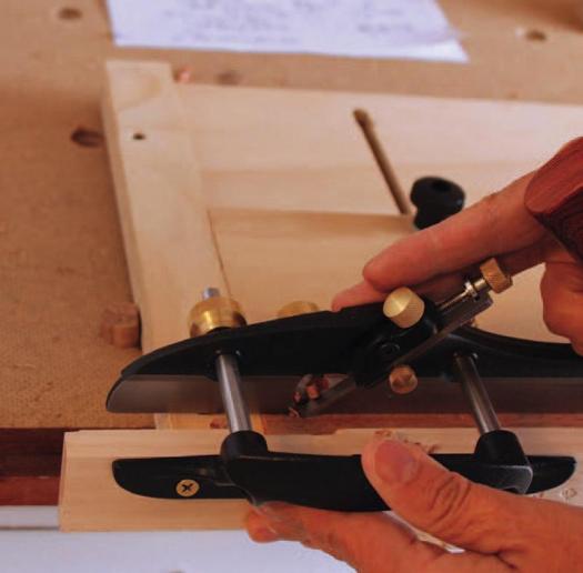

To set up the plow install the cutter and, as with a hand-plane, set the depth of cut first; say, to 0.005–0.010″ for light cuts. A plow also has two other settings to make before you can use it. The depth stop is used to determine the depth of the groove and the fence setting to determine the position of the groove.
You can use a steel rule to set the stop to the thickness of the inlay. A more direct way is to use the inlay piece to set the stop. For the fence setting, position the fence against the workpiece so the cutter is in the middle and then lock the fence. After set­ting the plane, secure the workpiece on the workbench and apply wax to the skate and fence to ease the work.

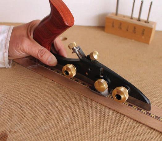

Cutting the grooves
It’s common for a new user to make grooves that are either not square or not parallel to the face side. Such errors are easy to avoid if you learn and remember two key points.
First, always keep the plow upright and the fence in good contact with the workpiece throughout the planing. In prac­tice, place one hand low on the fence, pressing it against the workpiece at all times, and use the other hand to push the plane forward. To avoid tilting the plane as you push, hold the handle loosely: extend both your index and middle fin­gers forward.
Second, start the plow cut at the far end of the work and progressively move backward until you establish the groove. Make, at first, short strokes, gradually taking longer and finally full-length strokes. After cutting a groove in one side, flip the stock and cut a second groove on the other side of the blank.

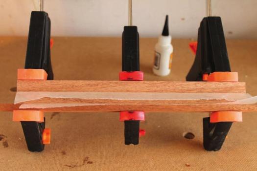

With the two grooves cut apply a small amount of glue to the grooves and press the inlays in place. Clamp them for the glue to set. Once the glue is dry lay the earring template(s) on the workpiece and trace all the profiles on the work with a pencil.

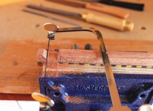

Clamp the workpiece in a vise and use a coping saw to cut out the rough shape of the earring, leaving a small part of it attached to the stock for now. Continue shaping with rasps and files to create the profiles desired. Ease all the sharp edges.

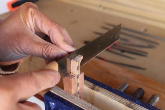

To make a pair of symmetrical earrings, saw the workpiece in half and then separate the earrings by completing the pro­file with the coping saw. Repeat the shaping and re-sawing steps until complete.

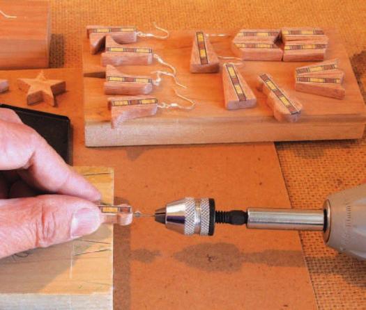

The last construction steps are drilling holes, gluing the wires and attaching the hooks. Apply a few coats of the finish of your choice to bring out the design and grain.

Depth Stop
Place the skate next to the inlay and lower the stop to touch the inlay.
Plow Cuts
 Point the index and middle fingers forward and start from the far end.
Inlay on Both Sides
Clamping cauls and wax papers are great helpers when clamping the inlay in the groove.

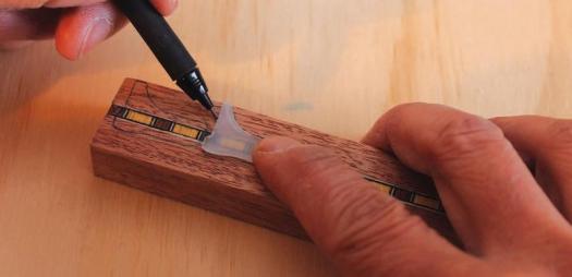

Transfer the Design
Trace all the designs onto the stock.
Resaw the Piece
Cut the workpiece into two pairs and file away any saw marks.
Drill Hole
Use a pin vise or a drill positioned horizontally for precision drilling.
Cut out the Shape
Remove the waste with a saw then shape the profile with rasps and files.
