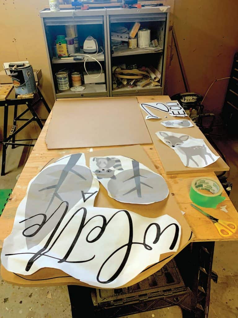

Since I needed to only stack cut the sections with the trees, and my design was so large, I cut my design so I could work on it in sec­tions. To create the stack-cut portion, I glued the 1/4″ board and the 1/2″ board together using super glue along the outside edges.

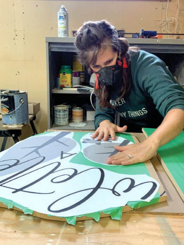

Covering the top of my board in painter’s tape also allowed me to tape the edges of my stacked materials together for extra reinforce­ment. If you wanted, you could also nail your boards together, or even use spray adhesive between boards. Using painter’s tape on the top of your material and between sections protects the material when you’re adhering your design to the board.
I use spray adhesive to stick my paper design to my material. If I glue it directly to my material, it creates a lot of work to sand off. By gluing the design to the tape, I am able to peel the tape and design off once I’m done cutting.
While your glue dries for your stack cuts, now is a good time to cut out your sign backer. For this sign, I cut a 30″ round out of MDF. MDF is a great material to use when creating a painted backer since you don’t risk it yellowing like wood does over time. Cutting rounds can be done a variety of ways, including using a band saw, jigsaw or router. All of these tools have jigs that you can purchase or make to make circle cutting simple and safe.

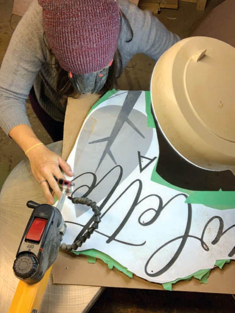

Starting with interior cuts allows you to cut out the smallest sec­tions of your design while keeping your project stable. To start, you will drill pilot holes in each of the interior sections so you can feed your blade through. I work on a DeWalt scroll saw, which takes pinless blades. This style of blade is very thin, so you can drill small pilot holes if needed. I use micro drill bits when doing small detail work. Once you’ve drilled all your pilot holes, you can start cutting the inside sections.
Using a scroll saw takes a lot of patience and practice. For me, cutting out a design like this is fairly consistent in terms of the blade and speed/tension that I use on my saw. I will typically use a #5 Pegas modified geometry blade or a #5 or #7 double reverse tooth blade for 1/2″ to 3/4″ thick materials. Both styles of blades are designed to cut from both the top and the bottom. This prevents tear-out and also cuts fairly quickly. Due to the speed of the blade, I usually set my saw speed midway for the interior cuts. For the out­side cuts, I increase my speed to 8. To set your tension, you need to ensure that your blade isn’t flexing too much, but also not so tight that it will break. Again, this comes with practice (and likely a few broken blades).
If you find that your material is jumping around, and you have to hold it down to prevent it from vibrating, your speed is likely too low, which is causing your blade to catch the material and pull it. Conversely, if you find yourself losing control and not able to stay on the lines of your design, your speed may be too high or your blade TPI (teeth per inch) could be too high for the material you’re using. Switching blades and adjusting your speed/tension until you find the right setting is the best way to perfect your scrolling technique.
Once the inside sections are cut, I move on to any puzzle cut sec­tions of my design. In this case, the main word “Violette” and the trees would be cut first. For these detailed cuts, I keep my speed around 6 to ensure I stay as close as possible to my design since all the puzzled pieces will need to slot together.

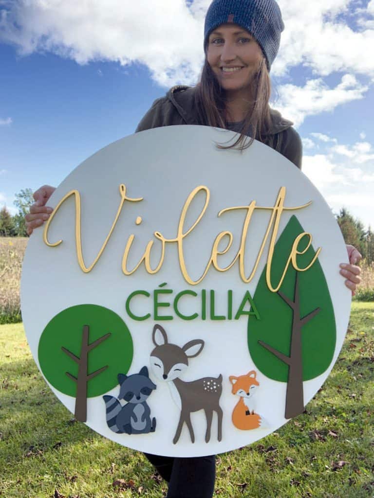

The large gold name was the exception in this project, and to get the metallic finish, I used spray paint. To begin, I primed the name in black, as in my experience using a dark colour beneath metal­lic allows for a brighter shine. Once primed, I then sanded by hand with 320 grit sandpaper to ensure the sides and top were smooth and ready for the metallic spray.
Spraying from a distance, and focusing on the edges, I coated the name lightly in gold. Spray paint can be very finicky, especially to temperature, so it’s essential to spray in a well-ventilated area that’s not too hot or too cold. Reading the recommendations for the spe­cific spray paint you’re using is important. With gold, drying times are necessary to follow, otherwise you’ll end up with a murky finish. Waiting 48 hours can test your patience, but it’s worth it in the end.
After the first coat is fully dry, I sand again at 320 grit, wipe the piece clean with a microfibre cloth and spray another coat of metal­lic on the sides to ensure they’re fully covered. I then focus on the top. Once it’s dry, you can be the judge if the process needs to be repeated. For this project, I sprayed the metallic name three times, sanding in between each coat. And if you do that math, it was in fact six days of drying and waiting to get the finish I wanted.
The eye details on the deer and fox were painted by hand using a fine-tip paint brush and black acrylic paint. For the eyes on the racoon and the dots on the back of the deer, I used the bottom end of a paint brush dipped in paint to make the perfect dots, a handy trick.
