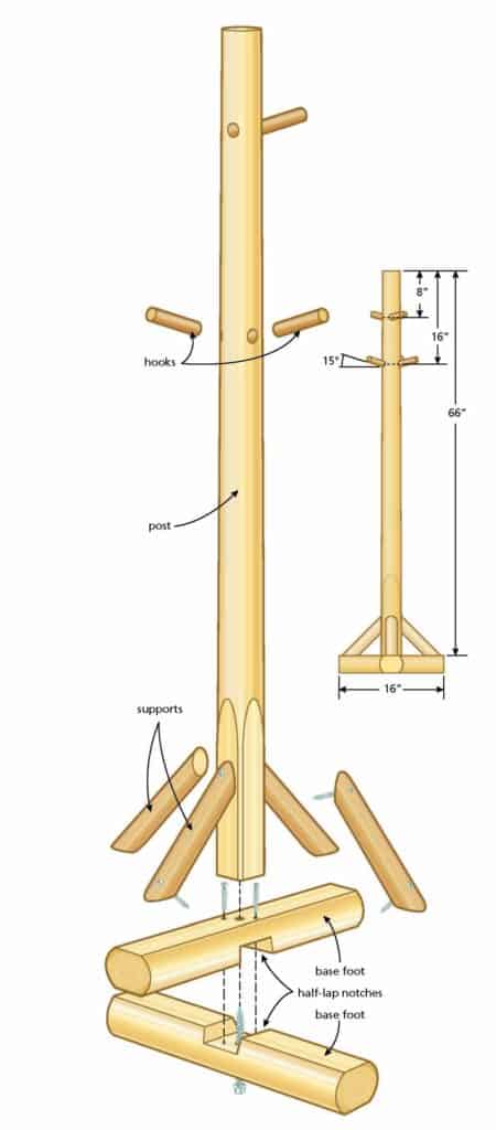

Start cutting
Start by cutting your log down to size. You’ll need the log to be at least 3-1/2″ in diameter. Cut it to 66″ long. Cut off all the stubs of the branches with a hand saw.
Now work on the bark. If you don’t peel the bark off immedi­ately it will all fall off onto the floor and make a big mess in a year or two. Trust me, I learned this the hard way. To do this you can just use a chisel, but it takes a long time. I usually use a drawknife to make it easier, so if you have one, use it.
Roughly square up a 10″ high section from the bottom of the post. Use a chisel and a hand plane. To make it easier to get it square, screw a 3″ × 3″ piece of wood to the bottom end of the main log or just trace the square onto the end of the log. If you’re using a larger log, attach or use a larger square. Then use a chisel to remove wood until you reach your marked lines. I cleaned it up with a hand plane to even it out.
The final step to prep the post is sanding. For this project I used an orbital sander to sand the post. Start at 60 grit and work up to 120 grit. You’re now done with the post and it’s time for the feet.
Two feet
The first thing to do for the base is to cut the feet to 18″ long. Do this with a log that’s about 4″ to 4-1/2″ in diameter. Chisel the top and bottom off the logs to square them up a bit and give a flat sur­face to work with. Next, hand plane them to 3″ thick. This might take a long time. If you want to speed up the process, you can do this on your bandsaw with a proper jig or use a thickness planer to bring them to an even thickness. If you use any machines, hand plane the surfaces to get rid of the saw or machine marks.
Now you’re ready to cut the joints that allow the two base pieces to mate together and then fix the main post to the legs. A half-lap joint will accomplish this. With the two feet prepped, trace one foot onto the middle of the other one and make two saw cuts half­way down into the foot. Hog out the material with a chisel. Do this to both logs on opposite sides.
Once the joint is cut, predrill and then use two screws and some glue to fasten them together. Next, predrill a 1/4″ hole for the 6″ lag bolt; don’t forget to add some glue before bolting the base on. Even a bit of construction adhesive would work nicely here.
Base supports
The supports are next, but you’ll need a jig to cut them accu­rately. Get a piece of melamine or other sheet good 8″ wide and about 16″ long. Cut two 45° angles on the ends to form a trapezoid. Now draw a line 3″ away from the short edge of the jig to use as a reference to screw on your supports so you can cut them at the cor­rect angle. The supports should end up around 12″ long, but their exact length isn’t crucial as long as they’re all around the same length and they fit.
Now to cut the four supports. Find a log that’s 2″ to 2-1/2″ in diameter. Cut it into four sections. Screw one section to the jig. While it’s by no means a fine art, try to use the jig to guide your saw as best as possible.
Glue and screw the supports to the base. Don’t forget to predrill and countersink the holes so you can fill them with dowels. You’re now done with the base and ready for the hooks.
Add hooks
The hooks are fairly simple. Branches of between 1″ and 1-1/4″ in diameter work well for the hooks. They should also protrude at least 3″ when installed. Find a branch that fits the diameter of the spade bit you have on hand and drill the holes with that bit. Some sanding, carving or chiselling might be needed for each hook to fit nicely. Mark two lines on the post. The first should be 8″ down from the top and the next should be 16″ down from the top. Make three marks evenly spaced around the post. There’s also nothing wrong with spacing out the hooks a bit more, as that will also cause the hooks not to collide with each other during the installation process.
Use the spade bit to drill all the holes for the hooks. Use a block of wood with a 15° angle cut into its end to visually guide the drill bit angle. You can now put some glue in the hole and hammer in the hooks. If you made the hooks the right size, they won’t need to be clamped.
More sanding
To finish your coat rack, you’ll need to go over the whole thing with a sanding block. Finish sanding when you feel the look and feel is even across the entire coat rack. When sanding is done, check it over for dried drips of glue and then coat it all with var­nish. I used a water-based floor varnish, though almost any type will work. While you can also use a linseed oil or a stain, I like to use a thick finish that will seal in everything.
The coat rack is ready for its first customer, and I think that should probably be you.

Illustration by Len Churchill
rustic coat rack
