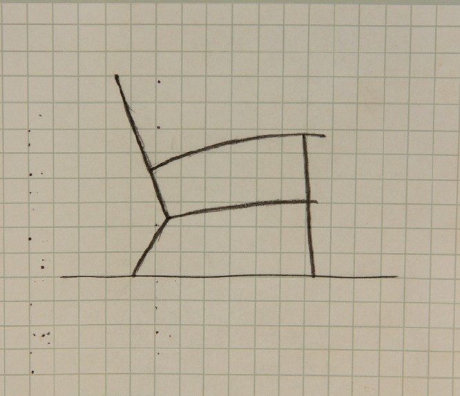

I need lounge seating; cushioned but not cushy, reclined for supported relaxation, dynamic yet inviting, and equally attractive from all sides. After a few moments’ thought, an image came to my mind’s eye. A quick five-stroke sketch reveals my imagined direction.

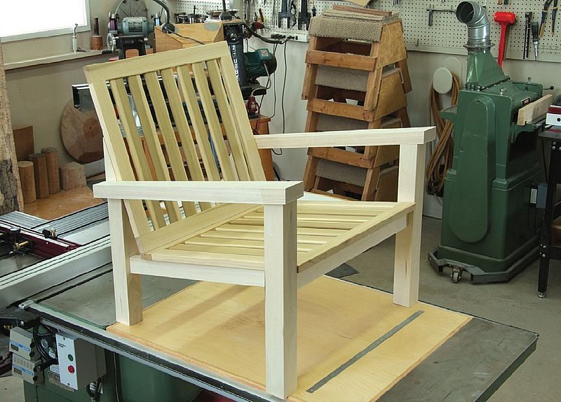

Next comes the prototype
A prototype is 3D proof-positive that reality matches imagination, or at least comes close, with ample opportunity for “seat time” and to tweak things before wasting time and ruining costly materials. I hate those “doh” moments.
I build prototypes from 4/4 or 5/4 rough kiln-dried poplar (aka American Whitewood). Well-priced, straight, medium density, it’s great for many projects plus it accepts stain very well, mimicking cherry surprisingly closely. “Fat” 4/4 stock, when cut to rough component size and dimensions, dresses down to the 7/8″ thickness I was after for most of my parts and 3/4″ thick to make the legs. Needing legs 2-1/4″ in cross-section, with 3/4″ stock and a lock-mitre bit, I easily fabricated four “tubes” with 3/4″ voids in the center that I filled with 3/4″ square stock to make solid legs once glued up. Hollow legs would have compromised the strength of the planned joinery. Arts and Crafts makers have used a similar method for decades to “build” their hallmark quarter-cut figured white oak legs.

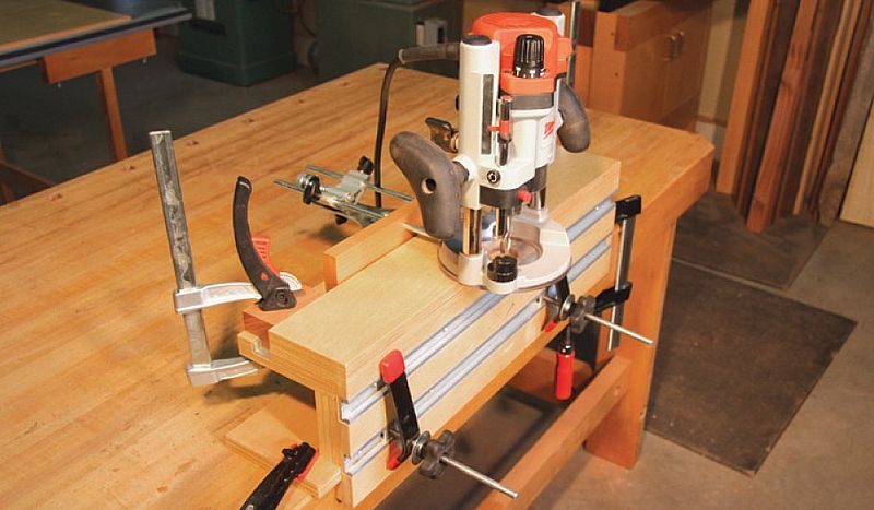

At my workbench, a plunge-router is set up on my shop-built mortising jig. Costing maybe $30 to build in 2005, I’ve used this simple setup alone and with effective fixtures to create mortises in almost all the furniture and architectural pieces I’ve made ever since. Today it will accurately hold and align my chair parts for mortising in ends and sides so floating tenons can be inserted and each part will mate exactly where intended without doubt or shimming. Slip fits set for glue-up. Having that confidence adds to the pleasure of the project immeasurably. (See sidebar “Floating Mortise and Tenon Jig”)
One by one, the mortise cut in one part is referenced to the mortise to be cut in its mating part without altering my router setup; no chance of misalignment. Next, tenon stock is ripped and sized to mate perfectly within the mortises. Tenon stock comes from manageable scraps cut away earlier, large enough to safely dress to exact thickness and width, measured with a vernier caliper, ready for rounding over the sides to slip-fit within the mortises. At my router table, jigs (fence) and fixtures (fingerboard) are located so a round-over bit will yield as much tenon stock as I need, uniformly.

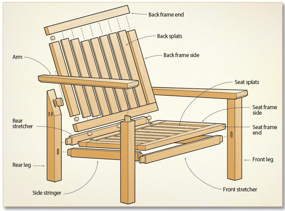

Just as the seat and back were my first consideration when sketching, they are also the foundation members for assembly of the chair physically. Seven splats are inserted into mortises in the top frame member, then side frame members are inserted. Next, working from one corner, mortises in the bottom frame member slip over the end of the left side, splats and right side member forming a seat frame. The process is repeated for the back frame assembly. Everything fits, the process proven … it’s time for glue-up. A thin application on all mating surfaces, and there’s no rush as epoxy offers plenty of working time.

A new morning brings my prototype’s much anticipated dry-assembly. Back and front legs unite with their respective stretchers to create subassemblies. Next, side stretchers join rear and front subassemblies. Then the arms drop into mortises in the side of the rear legs and top of the front legs. Now the seat and back frames I assembled the previous day glide into place exactly as expected.
For making furniture, cabinets, architectural doors and components mortise and tenon joinery, with floating tenons are exceptional. Stronger than traditionally cut mortise and tenon joints, very precise, repeatable and often faster to make; this mortising jig makes this all possible.
With floating tenon joinery, project parts are cut to exact exposed length with no allowance required for cutting tenons afterward. Then, by keeping all mortises the same width and thickness, tenon stock can be made in long lengths, then cut to create slip-fit joinery at exactly the tenon length required for each joint.
My mortising jig is “C”-shaped, in cross section, and is built of Baltic birch ply. “T” tracks, set into the front face, allow for placement of work-piece hold-downs, and a “C” channel at the top/rear accepts clamped stop blocks, as well as the routers wooden edge guide fence. Tongues on both ends of the jig’s base allow it to be clamped to the bench.
Epoxy, used to bond the joints, lubricates the parts so they slip together effortlessly and cure far stronger than the surrounding wood. Tenon stock can be made of harder wood than the project materials for additional strength, or made from off-cuts of the project stock for better stock utilization.

A simple sketch is a good place to start. Even though it’s not nearly enough to build the chair, it will set your mind in motion regarding general shape and style of your future chair.
The Prototype
A great way to see what your design will look like is to build a simple, quick prototype.

An edge guide fence made to precisely fit the “C” channel offers smooth lateral movement. Fore and aft adjustment is made using the router’s edge guide assembly. Mortise depth is controlled by the plunge router’s depth mechanism.

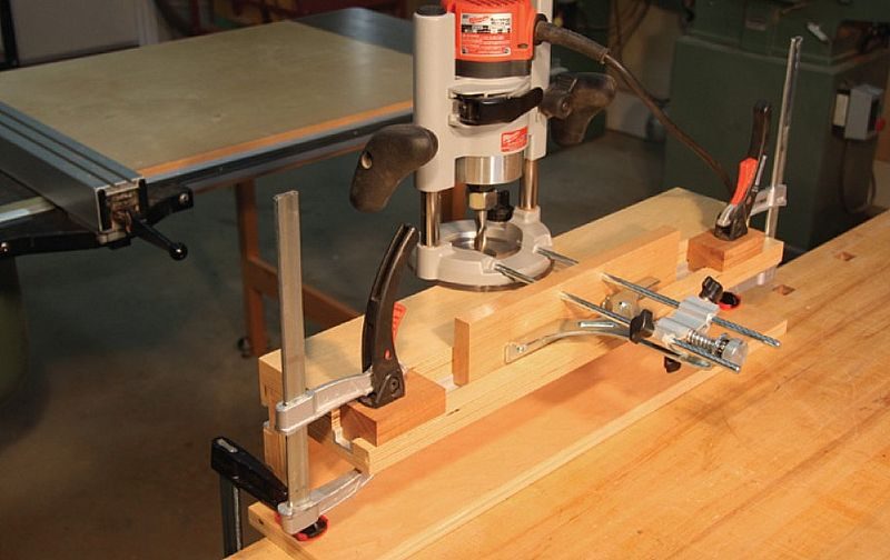

Stop Blocks Determine Mortise Length
With the router attached to the edge guide assembly, the guide’s wooden block runs in the rear “C” channel. Clamped stop blocks restrict the mortises length. A sharp “end cutting” up-cut spiral router bit makes for clean mortises.

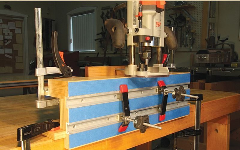

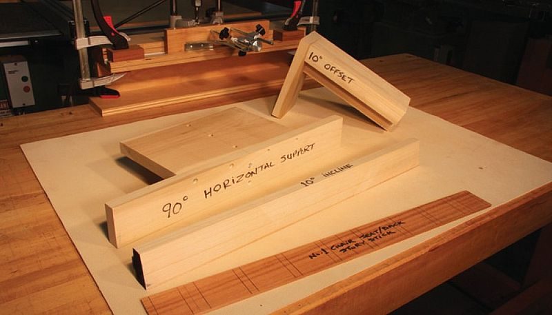

Secure the Work-piece
Hold-downs snugged with knurled knobs on shop-made tee bolts secure stock and jig fixtures of all sizes and thicknesses. Blue painter’s tape offers a replaceable face and ample friction to hold stock once located and clamped in position.
Angled Blocks
A story stick aids in repeatable, precise joint layout. Shop made jig fixtures support stock at custom angles. These blocks can be clamped to the face of the jig, then work-pieces can be referenced off them and clamped in place.

Used in conjunction, the support blocks, router, guide and stop blocks give almost unlimited options when it comes to routing mortises.

Illustration by James Provost
