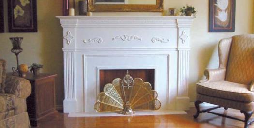

I was reminded about the warmth and comfort offered by a fireplace when an interior designer suggested that our living room needed a focal point. Initially, I thought that the perfect solution would be the standard chesterfield along the wall, with a picture above it. However, a faux fireplace was rather strongly suggested by my significant other.
With a bit of encouragement (and recollections of my childhood) I started shopping around, and quickly found that prices were in the $3,500-$5,000 range. I realized that like my brother, I could do it myself. After a lot of reading, I decided on a design consisting of a white mantle with a marble hearth. Once I envisioned what I wanted, I went about creating some drawings that would suit my living room’s size and dimension.
The accompanying illustration shows you how the mantle goes together, and provides some general width dimensions for the one I built. You’ll need to size the mantle to suite the dimensions of your room. The materials should be readily available at your local building store.

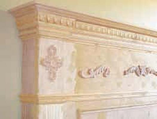

Mantle Trim
For the upper mantle I chose a 2 1/2″ Egg and Dart chair moulding and a 5/8″ bead moulding, attached across the upper mantle and along the sides. For the top I used two pieces of 3/4″ sheet plywood and 1 1/4″ x 3/4″ edge moulding to frame the smaller base panel against the top panel. I edge banded the top panel with 3/4″ x 3/4″ poplar and routed a 1/4″ round over along both edges. I chose a set of 3/8″ hardwood decorative appliquès from Lee Valley.
I covered nail marks with wood filler and exposed plywood edges with drywall compound. I sanded and primed the mantle and applied three coats of a semi gloss antique white paint.

All in all I spent about $480 for materials and estimate that it took me 25-30 hours to complete. It’s been a year since I completed this project and I am very happy with the results. The living room is more inviting than before and the mantle gives a warm feeling of comfort for all who sit in the room. My brother would be proud!
