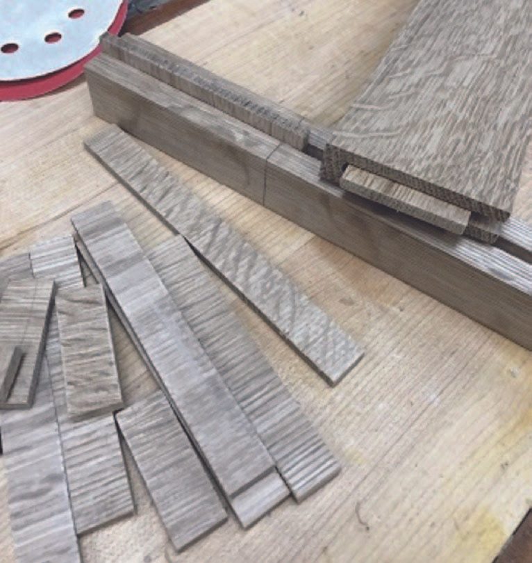

I used floating tenons to connect the rails to the legs. Therefore, a matching slot had to be routed into the ends of each rail. Make sure to orient the grain direction properly or the tenons will be very weak. Offcuts make good stock for creating the floating tenons.

Floating Tenons
When making floating tenons it’s critical the grain is oriented correctly or the joints will be very weak. Notice how the grain of the tenon that’s inserted in the rail is running parallel with the grain of the rail.

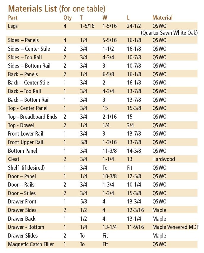

mission night table drawing
mission night table material list
mission night table hardware list
