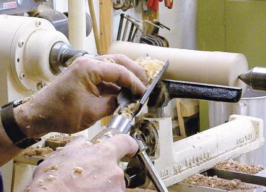

Next it is turned over so that the open side of the concave bead of the tool faces the opposite direction that it was facing. To cut the bead in the wood from the other side, you will cut back and forth on both sides of the bead, until the ring is freed. Start with a piece of wood that is suitable for the size of rattle. I started with a piece of 2”x 2”. Mount the piece between the centres and set the rest as close as you can. Make sure that the piece is able to rotate freely and that the rest height is a little below the centre of the spindle. With a roughing out gouge, turn the piece down to a cylinder as shown in Photo 1.

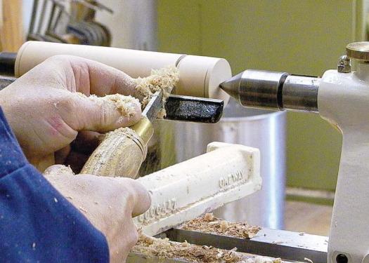

Next, with a parting tool, define where the rings are to be cut. Use the parting tool to cut the inside of the ball on the rattle,

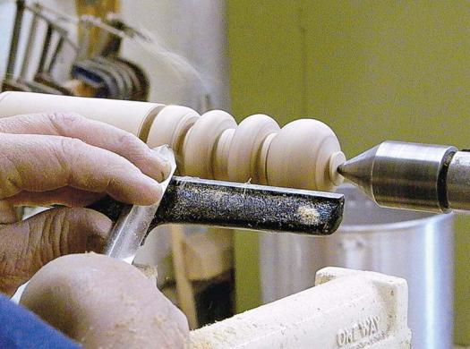

Lay out the rings with a pencil and part either side of them using a 1/8” parting tool.
Rough out the beads with a spindle gouge to make the rings.

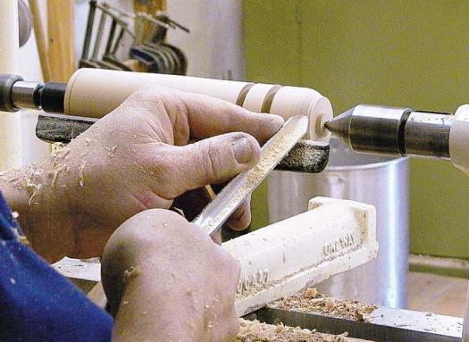

Then use the skew to undercut the rings. It is the long end of the skew, or the ‘toe’, that does the work. Material along the shaft of the rattle (the part where the rings spin freely) has to be reduced. This can be done with a skew or a spindle gouge.

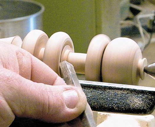

Keep under-cutting the rings with the toe of the skew. Reduce the shaft and the ring will come free. An alternative tool to undercut these rings is a 9-in-1 tool.

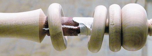

This tool is being used like a skew, although it is a lot narrower. When the rings are cut, shape the handle. All you need to do now is to sand it. To sand the inside of the rings, a piece of abrasive paper is taped to the shaft and the ring is then held over the abrasive.
