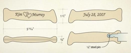

I chose to make the handle slightly longer than a standard knife handle; select a handle length that you are comfortable with.

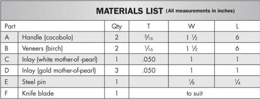

• Mill stock for the handle (A) and veneer (B). The pieces are fairly small, so be careful when cutting them on the table saw. Remember not to run stock shorter than about 12″ through your thickness planer; best to mill a wider and longer piece of stock, and then cut the handle pieces to size. For the veneer, start with a piece of birch about ¾” x 2″ x 8″. Joint one face and edge, and then rip a piece on the table saw just slightly thicker than 1⁄16″. Use a featherboard and push block. Use a sanding block or hand plane to remove any milling marks.
• Carefully remove the handle from the store bought knife blade. Take special care not to scratch or mar the finish on the blade.
• With a hacksaw, cut a piece of ⅛” steel rod, about ¼” long. The rod will be inserted through the hole in the knife blade and pin the blade into the new handle. Steel rod is available from most building supply stores or automotive supply shops.
• Plan the desired inlay and make sure that you have enough material on hand to complete it. I used gold mother-of-pearl for the text and white for the interlocking hearts.

• Drill a ¼” hole through both veneers. Be sure the hole in the blade lines up perfectly with the holes you drill.
• This hole also needs to be transferred into the cocobolo. Be sure not to drill any deeper than necessary into the cocobolo.
• Install the piece of ⅛” x ¼” steel rod to anchor the blade to the handle.
• Test fit the parts before applying glue. I used G-2 epoxy, but any waterproof glue will work. Apply the glue as per directions and clamp with three clamps, and allow it to dry overnight.
• Make a template of the handle shape from ⅛” MDF. Place the template on the assembled handle and trace carefully around the pattern.
• Cut the shape out using a scroll saw or bandsaw, and then sand the edges.

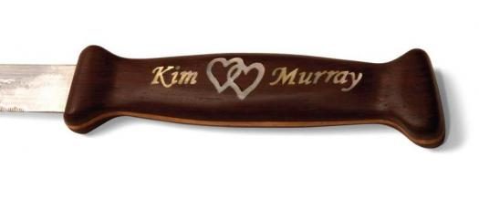

• Select the font and size of the text for the inlay. Print the text in the desired size and attach the paper to the cocobolo stock in the proper place with cyanoacrylate (CA) glue. Attach another copy of the pattern to the shells with CA glue.
• Use a jeweller’s saw with a 2 – 0 blade and carefully cut the shell.
• Debur the shell with a small file when the cutting is done.
• Attach the shell to the paper pattern on the cocobolo with balsa wood cement and allow to dry.
• With a very sharp X-Acto knife etch the cocobolo at the edge of the shell. The pattern helps you stay accurate.
• Using a rotary tool with a 1⁄16″ bit, rout the cavity. You want to set the inlay slightly proud of the surface. Make sure the inlay fits in the cavity. Do not force the inlay into place. When the inlay fits the cavity, insert it and flood the area with CA glue.
• After the glue has dried sand with a block and 80 grit paper.
• Using the X-Acto knife, clean out all the air bubbles. These show up as light spots in the glue. Re-flood these areas with glue, and then allow it to dry again. When the glue is dry re-sand with progressively finer paper, finishing with 220 grit.

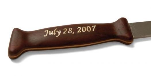

• Shape the handle using a rotary tool with a ½” sanding drum on the flex shaft, being careful not to sand through the inlay. Once shaping is done, sand the handle to 220 grit.
• Apply a water resistant finish. I use Tru-Oil, which you can buy at most sporting goods stores, though you could use polyurethane. Allow plenty of time for the finish to dry as any oil finish on dense tropical hardwood dries slowly. Once the finish is dry, buff it out with a soft cloth.
