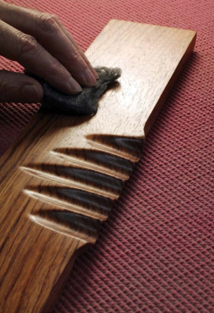

Rub Out the Finish
Once enough coats of shellac were applied, and cured, Brown used wax and #0000 steel wool to smooth the surface. A quick wipe with a clean cloth and the finish is complete.

I used shellac to finish the outer surfaces of this box as well. After everything was sanded I padded coats onto the main box and the lid. I also added coats to the two feet, but kept the bottoms free of finish for now, for simplicity sake. I needed the bottoms to be finish-free while I held the feet in my hands as I finished them. I also kept a large portion of the top of the feet unfinished, so I could glue the feet to the underside of the box once the finish was applied. Generally speaking I applied a few coats then let them dry for a few hours, then repeated the process until there was enough build. At this point, I sanded with 400 grit paper and applied another coat, leaving a very smooth, glossy surface.
Once fully cured, I rubbed the finish out with #0000 steel wool and wax, glued the feet on, drilled the base for press-in bumpers (Lee Valley #00S21.04), applied a few light coats of shellac on the bottoms of the feet, inserted the bumpers and attached the lid. I also added two small, clear plastic adhesive bumpers so the lid would contact the main box quietly.
