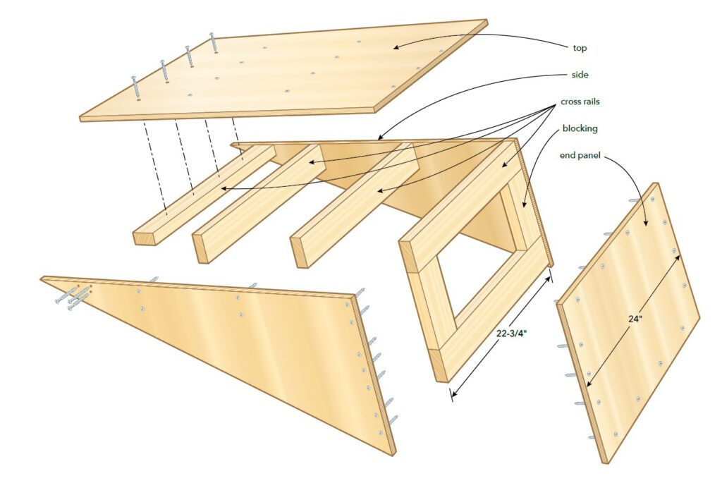

Start with the plywood sides
A track saw will quickly and accurately cut plywood straight, but a circular saw that runs against a straight 2×4 clamped to the plywood will also work well. Even a jigsaw that runs against a clamped 2×4 will give you a straight enough cut. Just be sure to off­set the 2×4 by the distance between the edge of your blade and the edge of the saw’s base.
It’s easiest to cut a blank that will provide you with enough mate­rial for the two sides, then cut the two sides from that blank. Cut your sheet to give you a piece of plywood 16″ wide by 48″ long. Next, cut that piece from one corner to the opposite corner, giving you two long triangles for the sides.
Next, cut the top and end panel to finished size. The end panel will be 24″ wide by the length of the shortest side of the triangular sides. In theory, this should be very close to 16″, but if not, adjust the end panel to be the same length. The top has to be the length of the second longest side of the triangle, plus the thickness of the end panel. This is because the top will overhang the end panel after everything is assembled.
Cross rails
We used five cross rails for our jump; four directly supporting the top and one on the bottom of the jump, at the end. If the rider is over 100 pounds, or you’re making a longer jump, add an addition rail (or two) directly underneath the top for extra support. This is especially true towards the entrance end of the ramp.
Cut the cross rails to length. They need to be equal the width of the top, minus twice the thickness of the sides. Although four will eventually be spaced out evenly to directly support the top, the one closest to the start of the jump won’t be installed until later. You can screw the other three to the side so the upper edge of each cross rail is flush with the upper edge of the triangular side. The cross rail at the take-off end of the jump will also need to be secured so its face is flush with the shortest edge of the triangular side.
Add the top and end panel
The top will now get screwed to the cross rails. It should be posi­tioned so its long edge is flush with the outer face of the side, and so the take-off end of the top overhangs the cross rail at the take-off end by the thickness of the end panel. This will allow the end panel to tuck in nicely underneath the top later.
The end panel can now be screwed in place. Its long edge gets screwed to the end cross rail and will be weak until we add the next few pieces.
Second last cross rail and blocking
The lower cross rail can now be added. Screw through the side into this cross rail, then through the end panel into the cross rail. Height-wise, position the cross rail so its lower corner is flush with the lowermost edge of the triangular side. This edge, and the lower edge of the side, will sit directly on the ground in use, so they need to be in the same plane.
Add two pieces of blocking (short pieces of 2×4 material) to increase the strength of the end of the jump. Cut two pieces to fit between the lower cross rail you just installed and the end-most cross rail. Screw through both the sides and end panel to secure the first piece of blocking at the junction of the side and end panel. The second piece of blocking will have to be screwed to the end panel so its outer edge is flush with the ends of the two cross rails.
Add the second side
The second side should fit nicely in place now, and can be screwed to all the cross rails and blocking.
The last cross rail
The final cross rail will support the take-off end of the jump. It needs to be positioned so it sits flush with the under­sides of both side panels and sits flat on the ground when the jump is in use. Ours didn’t sit perfectly so we had to shave some material off one end of the lower edge so it sat flush with both sides. This cross rail will provide a lot of support while a rider first hits the jump, so it needs to fit properly. If you’re adding extra cross rails they should be installed now.
Ensure screws are added wherever possible, as they are what pro­vide the holding power for all the joints.

bike jump illo
bike jump illo
bike jump material list
