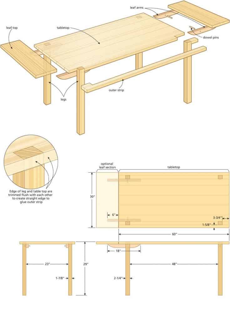

Because the thickness of the legs needs to be determined before cutting two strips from the main section of the table top, it might be a good idea to break the legs out now. I used legs that were 2-1/4″ wide × 1-7/8″ thick. It’s the thickness that’s important right now.
Accounting for the four leg-to-top joints is the tricky part of this build. Out of the clamps, I used my track saw to create one straight edge on one side of the panel. I then ran that freshly straightened edge along my table saw’s rip fence to remove a strip of wood about 1/16″ to 1/8″ wider than the thickness of the legs. I ripped this strip just barely under 2″ wide. I marked the strip and the panel so I could eventually reglue the strip back in place. This ensures the grain and colour will remain uniform, and the joint will be almost invisible.
Putting the strip aside for now, I cut the center section of the table top to width. For my table, this distance was 23″. This distance will be the exact distance between the inside faces of the legs. As with the first cut, I labelled the larger panel and smaller strip so I could reglue them later. The next cut was to trim the second strip to just under 2″, and I did that operation on my table saw.

Working with the two strips that would be positioned in line with the legs, I marked a line in from each end at 6-1/2″. The top is still 1″ longer than it will finish at, so this extra half inch will eventually be trimmed off. This marks the inner edge of each leg and determines the distance between the two legs at either end of the table – 48″. I made these two cuts on both of the two strips of wood, and made sure to mark both the 6-1/2″ and 48″ long parts, as they will all have to be glued in place carefully.
In order to keep the grain and colour aligned as much as possible, I removed a total of 2-1/4″ of length from the 6-1/2″ long piece to make room for each of the legs. This is where the legs will protrude through the table top. I made sure all of these parts were labelled clearly so I could put them back together in the position they were all cut from.

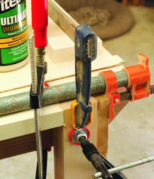

Before applying any glue, I positioned the leg against the table top and clamped a caul to the inner face of the leg. The caul was butted up against the underside of the table. This was done so that during assembly the leg would be much easier to position and clamp in place, square to the table top.
I applied a light layer of glue to the end grain of the piece of wood one leg would be positioned against, and let it dry for a minute or two. This helps stop the next layer of glue from seeping into the end grain too much. Then I reapplied glue to that end grain, and also to the edge of the table top the leg would get adhered to. Making sure the leg was positioned perpendicular to the table top, I used one clamp to apply force to the caul and bring the leg into proper position. I then added another clamp across the width of the top to adhere the leg against the table top. Before tightening this clamp, I added a third clamp (a pipe clamp, at least 5′ long) to apply force to the leg so it would butt up to the 48″ long strip of wood. A solid wood caul helps protect the side of the leg from damage.
When the leg was dry, I added the 4-1/4″ long strip on the other side of the leg, using one clamp to bring this piece tight to the leg and another clamp to ensure it was snug to the edge of the table top. Once I repeated this approach for all four legs, keeping all of my pencil layout marks in mind, I was ready to prep the table so I could add the final two outer lengths of wood to the table top to complete its width.

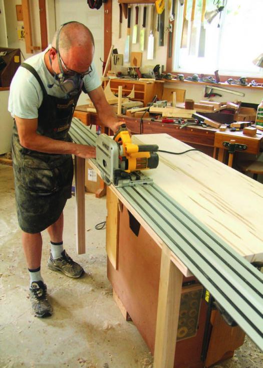

Before gluing the two outer 60″ long strips of wood to complete the table’s width, I needed to ensure an even, straight edge was cut into the two edges of the table. I used a track saw for this, but a router and long straight bit, coupled with a long straightedge, could also be used. I placed my 8′ long track saw rail on the table top, positioned about 1/32″ inside the outer face of both legs, then clamped the track in place. Once the depth of cut was adjusted so the blade ever so slightly cut deeper than the thickness of the table top, I made the cut. I repeated the process on the other side, proÂducing two straight edges for the next step.

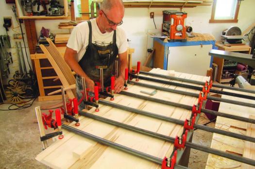

The final step to complete the top was to glue on the final two narrow lengths of the table top. I made sure to keep these pieces flush with the existing table top with the help of a series of F-clamps straddling the joints while a series of bar clamps closed the joint.

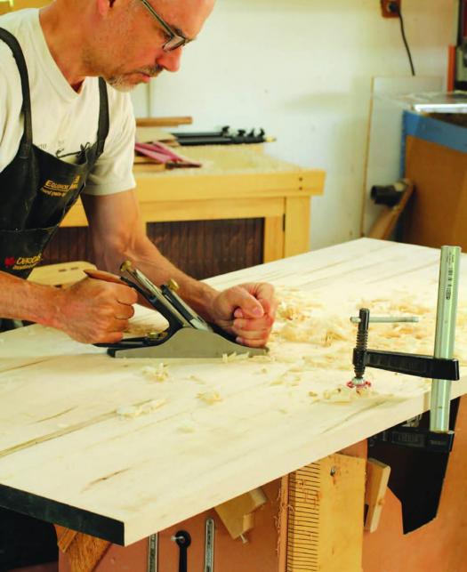

After an hour I removed the clamps, scraped off the glue and cut the table to finished length. After a day or so, I hand planed the surface even, then sanded it smooth. I routed a quarter round to the top, underside and corners of the top to increase comfort when seated at the table.

Each leaf consists of the top surface, two arms and two wooden pins to hold it in place. The arms fit between the table legs, and a wooden pin protrudes through the arm into the leg to support the leaf. I made sure to leave a 3/16″ gap between the outer faces of the arms and the inner faces of the legs so when the table contracted during the drier months it wouldn’t squeeze against the arms of each leaf. If you build this table in the middle of a hot, humid sumÂmer, you need to err on the side of leaving an even larger gap, as the table top will only shrink in the future.

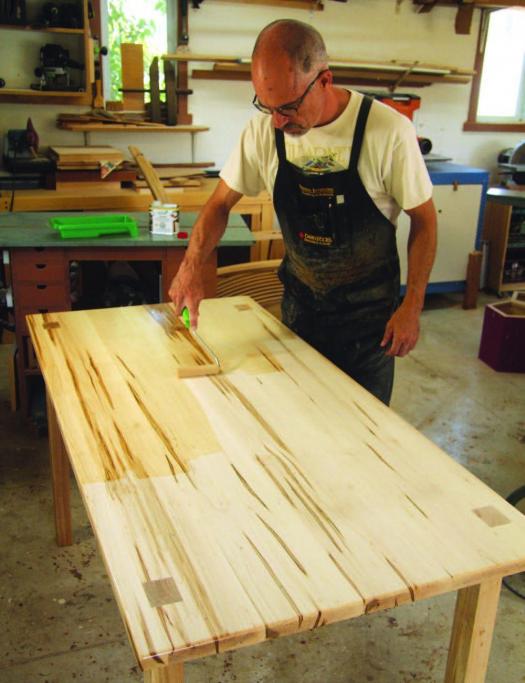

I was aiming for a finish that was easy to apply, easy to maintain, had a nice feel to it and wouldn’t yellow the maple much. I opted for OSMO TopOil. I rolled on the first coat, allowing all excess finÂish to remain on the wood until dry. At that point, I sanded with 320 grit and used a fine abrasive pad to apply an additional two light coats of finish, lightly sanding between coats. I applied finish to all surfaces of the table, including the ends of the legs.

A Nice Top

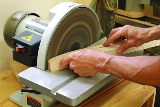

With the majority of the table top laminated, Brown used a hand plane to remove any minor imperfections in the top. A belt sander was the next step, used to further smooth the table top.

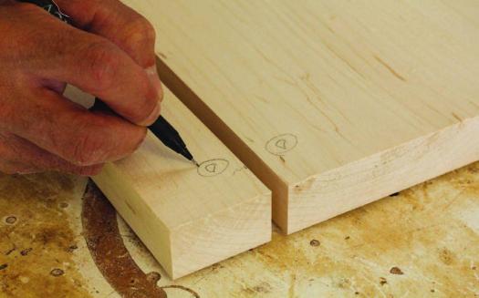

Keep Parts Aligned
When making the series of cuts to allow the legs to protrude through the top, Brown marked the parts with letters so they could be put back together how they were cut. This ensured the joints were virtually invisible, as grain and colour could remain constant and even. The narrow strip of wood in this photo is 1-13/16" wide, which is the width of the leg plus an extra 1/16".

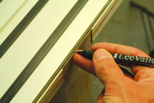

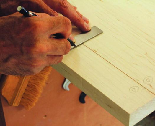

Mark the Leg Location
Once the first 3-1/2" wide strip is ripped off the top, it’s then ripped into two pieces. One is 1/16" wider than the width of the legs, and that’s the piece that’s being marked here. Brown is adding a mark at 6" in from the end, as that is where the inside of the leg will be butted up to the strip of wood during assembly.

Add the Legs
The lower red-handled clamp is clamping the leg perpendicularly to a temporary caul. The caul is then clamped to the underside of the table (with the vertical red-handled clamp). The orange-handled pipe clamp brings the leg into contact with the end of the strip of wood slightly wider than the leg, while the dark blue clamp applies pressure to glue the leg to the table top.

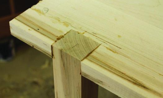

Almost There
With the leg glued into place, the outer block can be positioned and glued. Because the strip was crosscut twice, and the material where the leg is positioned has been removed, the grain of the strip continues on either side of the leg.

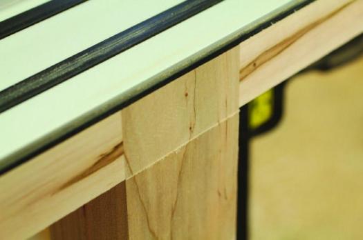

Just a Sliver
To create an edge on which to glue the final outer strip of wood, Brown uses a track saw, positioned ever so slightly to the inside of the leg’s outer surface.
Make the Cut
A track saw makes quick work of producing a good, square edge to glue the outer piece of material to the table top.

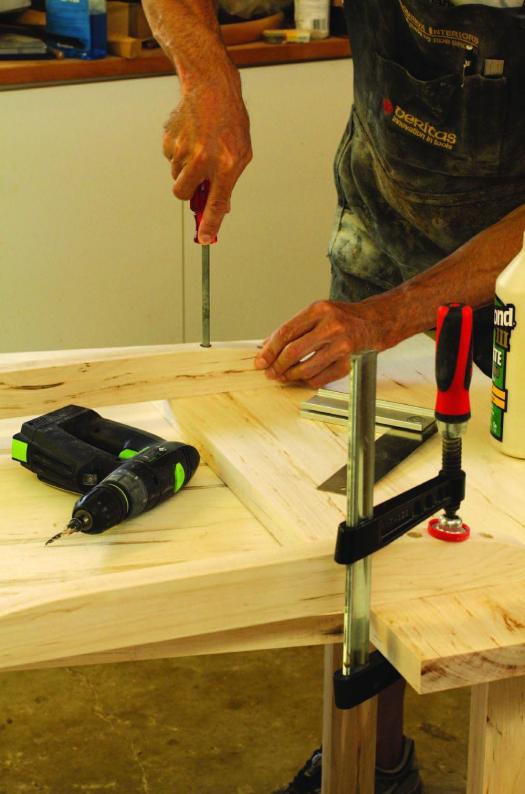

Secure the Arms
A couple of screws and some glue are more than enough to secure the arms to the underside of the leaf’s top surfaces. Ensure the distance between the arms will allow the leaf to fit between the table legs by adding a bit of extra room for seasonal movement of the table top.

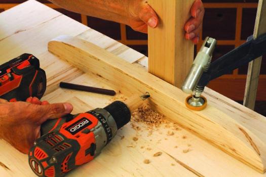

Drill Pin Holes
With the leaf in place, Brown bores a hole through the arms into the legs. Notice the solid wood collar placed over the drill bit. This is to stop from drilling through to the outer face of the legs.
A Good Finish
A finish on a kitchen table is called on to do so much. Brown chose OSMO TopOil to take care of this table.

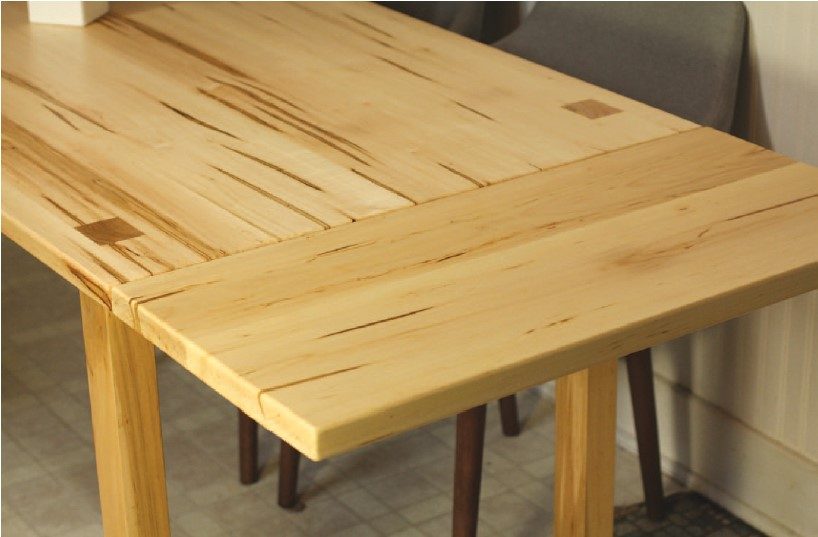

A Bit of Extra Room
The two table leaves provide enough room for a few extra people to join you at the table for a meal.
