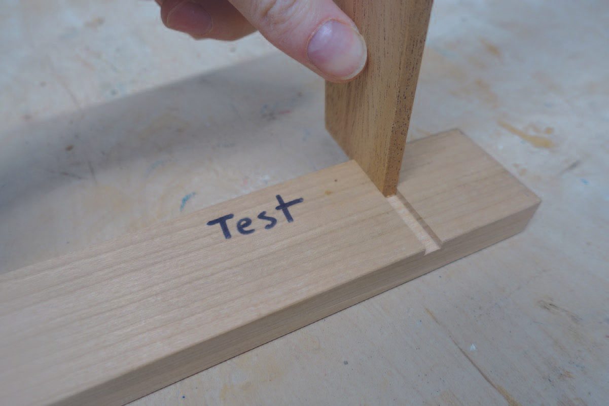

Dress the Dividers to Thickness
First, cut a dado using your preferred method, then plane all your work pieces to a snug fit in that dado.

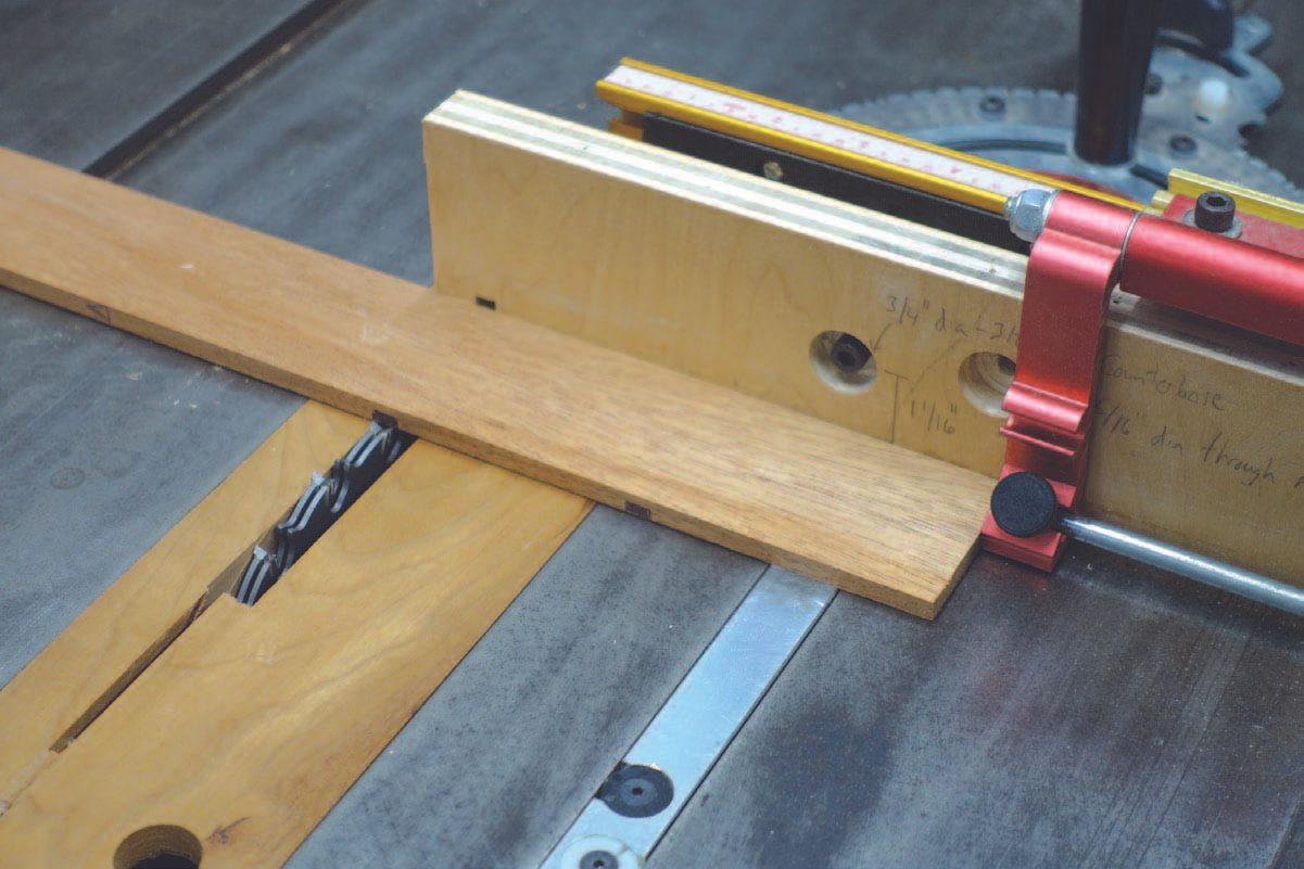

Stop Blocks Are Critical
A stop block on the miter gauge ensures the joinery will be spot on across the various pieces. Make sure to clearly mark where the joinery will be cut, as it’s easy to put the wrong edge on the stop block and cut the joint incorrectly.

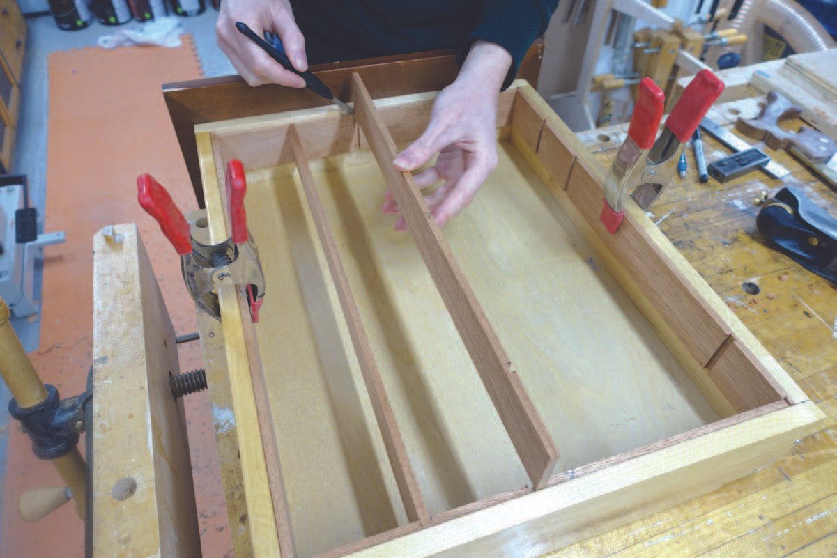

Use the Drawer as a Reference
Using the actual drawer for marking and fitting joinery ensures a snug fit and reduces the need for measurements. Here, Kosonen marks where to cut the central vertical divider which was left full length to cut the dadoes.

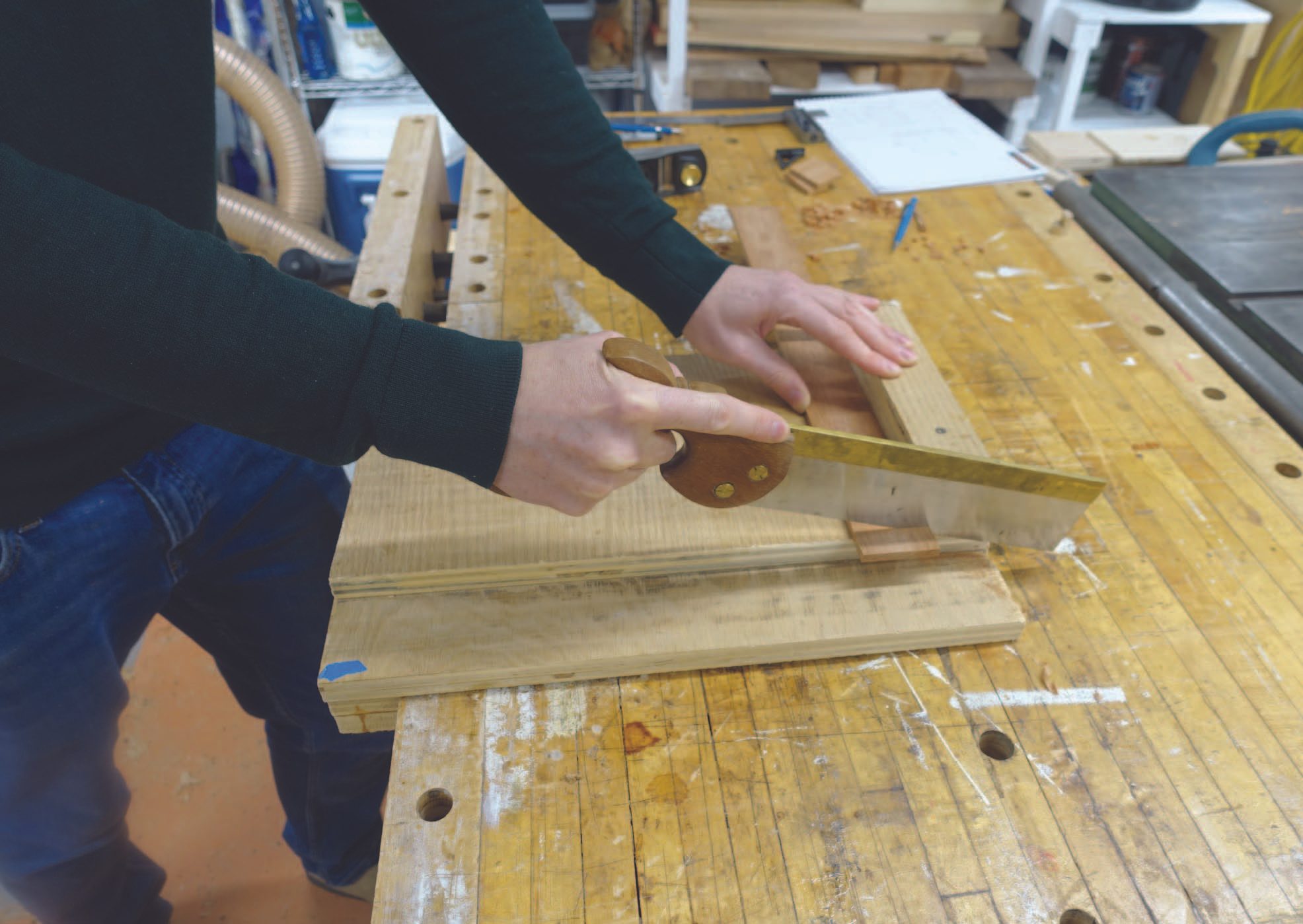

A Hybrid Approach
Kosonen cut and planed the dividers to length with a shooting board. This allows the perfect fit to be snuck up on one shaving at a time. First, trim the part close to length with a hand saw (above), then use a sharp block plane to make small adjustments to the length so it fits nicely (below). A table saw or miter saw could also be used for this step, though they don’t tend to have the fine-tuning ability of hand tools.
A Hybrid Approach
A Hybrid Approach

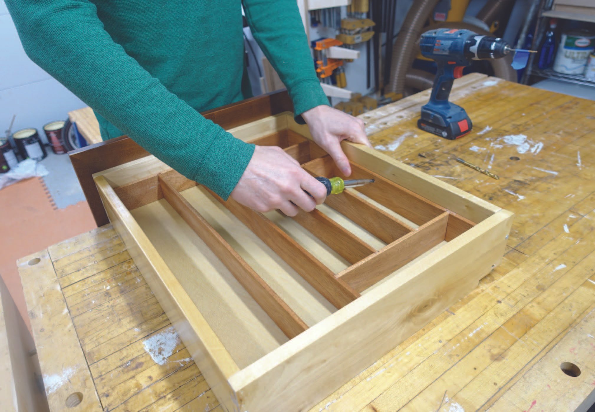

A Strategic Screw
A single small screw into each drawer side is all it takes to ensure the tray won’t slowly work its way up over time as the drawer is opened and closed.
A Strategic Screw
