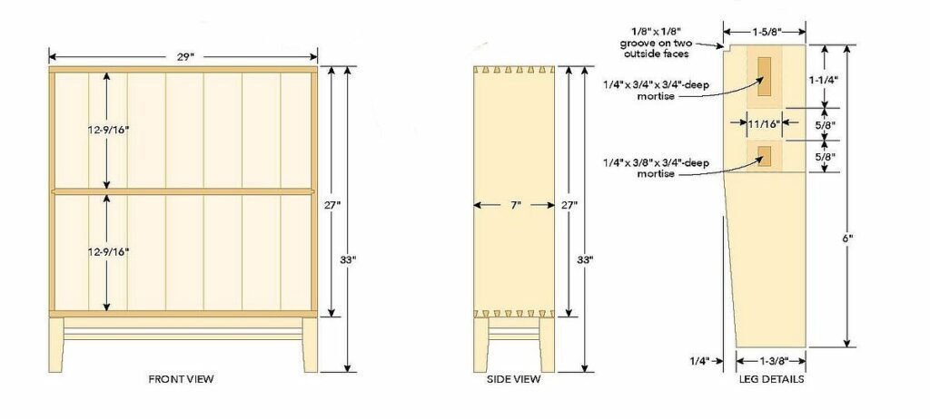

Illustration by Len Churchill
Dobson bookshelf
Dobson bookshelf
Dobson bookshelf
