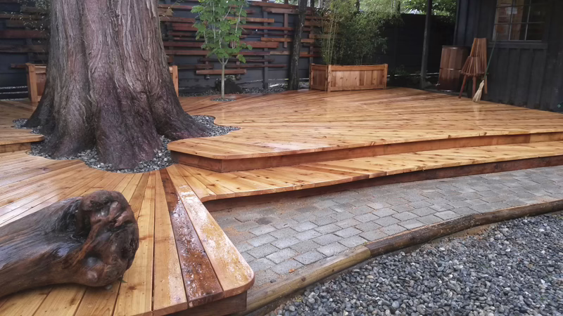

Cedar Deck
Toso was given full freedom to design and build a deck to join two cabins on Bowen Island. He wanted to accent and honour the giant cedar tree the deck was to surround. He was able to fan the boards out from a central point within the tree and keep the angles consistent.

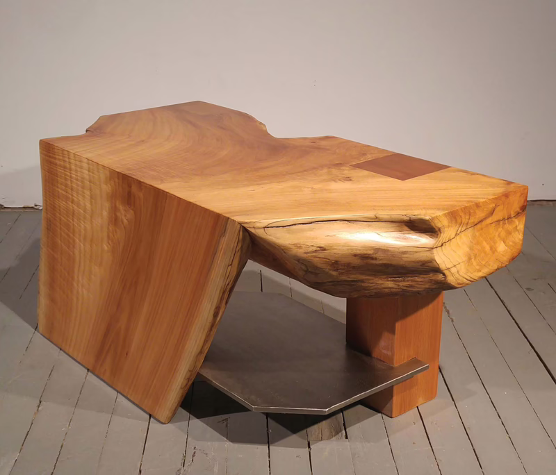

Mighty Mitre
This coffee table is made from a piece of western red cedar driftwood salvaged off the west coast of Vancouver Island. Toso was interested in making a large mitre joint to emphasize the grain pattern. The lower shelf is a reclaimed piece of stainless steel.
