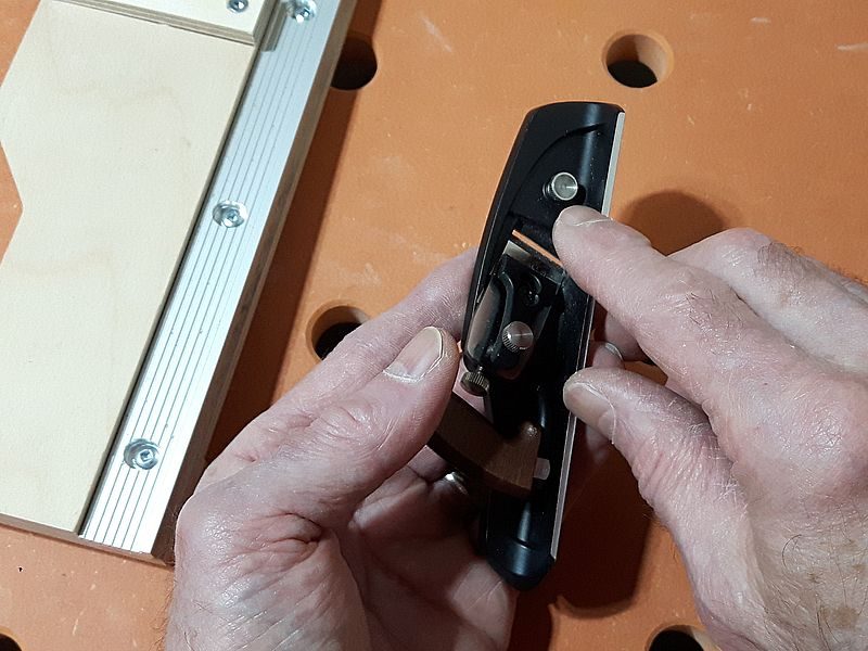

The Norris-style blade adjuster, which has a single arm to move the blade laterally and vertically, works beautifully. The only issue I find is that because the adjuster knob is so small, it’s a tad finnicky to maintain the blade parallel to the mouth while manipulating the adjuster. It helps to keep a finger pressed down on the lever cap as you adjust the blade forward or backward.

Veritas mini shooting plane
Keep a thumb on the lever cap when adjusting blade depth.
