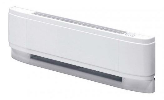

Convection heating draws air naturally over a heating element or plate and then releases it back into the room. The heating and cooling of the air creates a circular air current, eliminating the need for fans. Some examples of convection heaters are baseboards, oil-filled heaters and even radiators.
Pros: These heaters are readily available and tend to be inexpensive to purchase. They are absolutely silent to operate and because the air currents generated are so mild, there is no chance of the units stirring up dust.
Cons: While great for maintaining a constant temperature, these units are slow to heat a cold space and are best suited to well insulated shops that do not see a lot of in/out traffic. Fixed installations such as baseboards will require professional installation and operating costs can be quite high.
