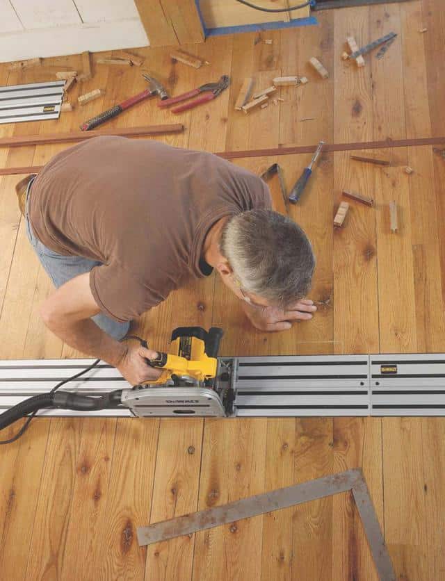

All three companies use lightweight aluminum tracks with a groove that holds a clamp from below while guiding the saw above. The track bottoms have slip-resistant rubber padding so that they will not mar the surface of the workplace beneath them and for some cuts you may use the tracks without clamp­ing them down. Plastic runners on the top of the track reduce friction so the saw glides along with minimal resistance. On the edge of the tracks, a replaceable zero-clearance splinter-guard stops the blade from pulling wood fibre upwards as it exits the cut.
Makita and Festool’s tracks are simi­lar. The off-set between clamp and blade, and therefore the narrowest clamped cut you can make, is 5 ¼”. DeWalt’s track is unique in two notable ways: it is nar­rower than the others, making possible clamped cuts as narrow as 3 ¾”, and it is double-sided, allowing you to cut in either direction, saving you the hassle of removing clamps and spin it around between cuts. Festool’s eight tracks come in a variety of lengths from 32″ to 197″. DeWalt’s three range from 46″ to 102 ” and Makita’s two on offer are 55″ and 118″ long. It’s possible to connect tracks of different lengths for extra-long but still accurate cuts. The guide rails are also compatible with other tools like routers, and each company sells a mitre guide for setting up angled cuts.

Smaller Can Be Better – The DeWalt track (top) allows the user to make a narrower clamped cut than with the Festool and Makita style track (above).
