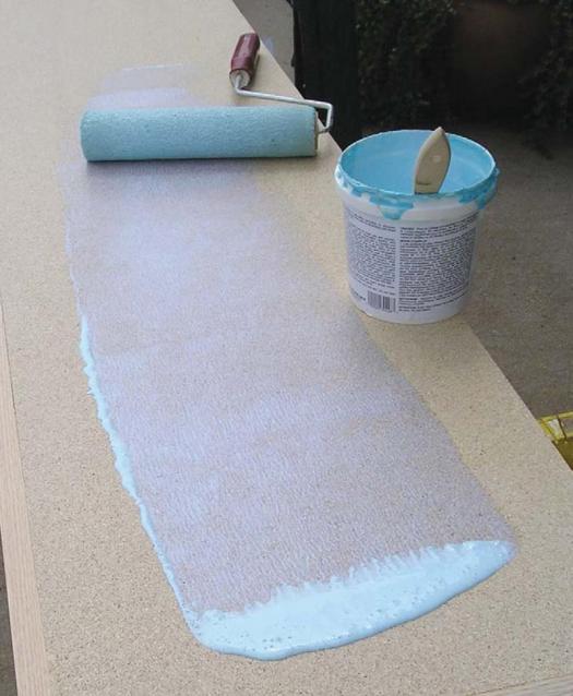

Roll out the glue
Using a paint roller to spread the contact cement will give you an even coat every time.

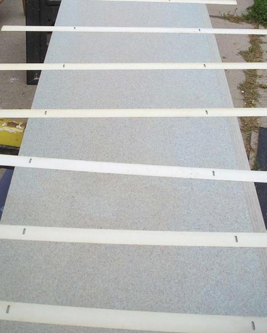

Venetian spacers
You only get one chance to attach the laminate to the substrate once the contact cement is dry.

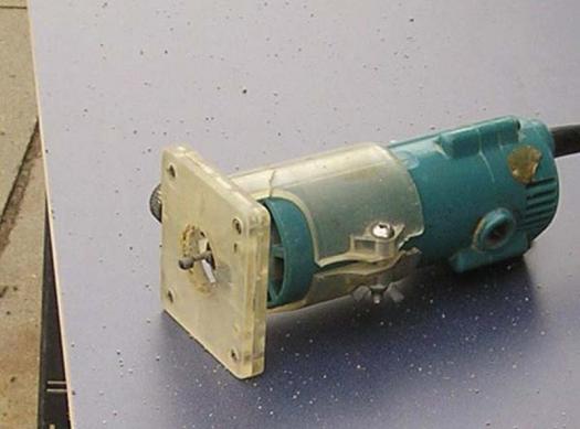

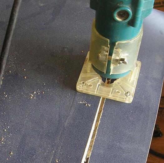

Flush-trim
A laminate trimmer, as the name suggests, was designed for this task. You can follow up with a file to remove any sharp corners.
Cut to size
The laminate trimmer fitted with a flush-trim bit is the easiest way to dimension the fragile laminate material.

Laminate is relatively fragile, and must be handled with care. A work surface the size of the sheet is highly recommended. Laminate is easy to cut to size. The best way is to clamp the sheet to a flat surface, overhanging the edge, and using a laminate trimmer with a 1/4″ flush cutting laminate bit riding along the work surface edge. Smaller pieces can be cut on a table saw with a carbide crosscut blade and a zero clearance insert for the throat opening to prevent chipping the laminate.

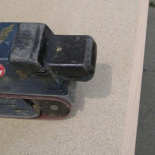

The first step in constructing a laminated surface is to build the substrate to the finished dimensions with the appropriate edge in place. The example shown has 1″ x 2″ solid oak added to the edges for a small countertop. After gluing and nailing the oak to the particle board, the entire surface is sanded smooth with a belt sander with an 80-grit belt and swept clean.

Contact cement is rolled on to the substrate and laminate and allowed to dry. A roller tray is not needed, just pour some cement on to the surface and roll it out evenly. A thin, even coat is important, and then allow the cement to dry until it is clear. A second coat is recommended on the substrate because some of the first coat will have wicked into the substrate. A 2″ disposable nylon brush works well for smaller pieces; just keep it in the contact cement between uses.
Contact cement adheres instantly upon contact, so aligning the sheet over the substrate is critical. Once the two surfaces touch, it will adhere permanently. Place some spacers over the substrate about 6″ apart and lay the laminate on top of the spacers. I prefer to use venetian blind slats for this job. Move the laminate so that the substrate is covered properly and remove the spacers a few at a time without moving the laminate, pressing down on the laminate as you go. On a large surface, work from the middle outwards, pressing firmly to prevent air bubbles under the laminate. After the sheet is adhered to the substrate, use a J-roller to firmly press down on the sheet, especially around the edges, to ensure a good bond.
The laminate can now be trimmed to the size of the substrate using the laminate trimmer and the 1/4″ laminate bit, followed by a light filing to relieve the sharp edge.
