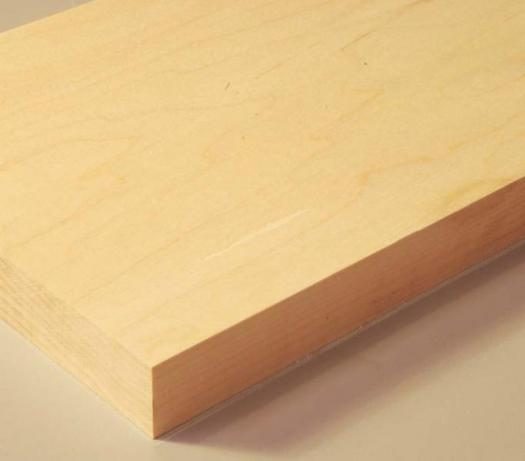

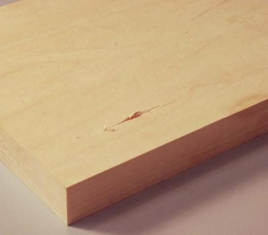

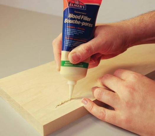

Gouged workpiece
Filler applied
Filler dried and sanded

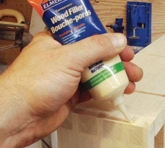

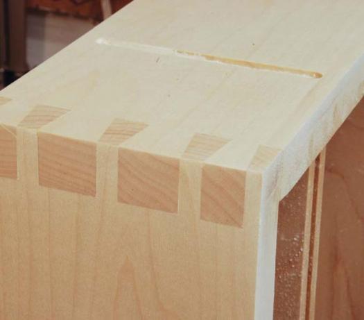

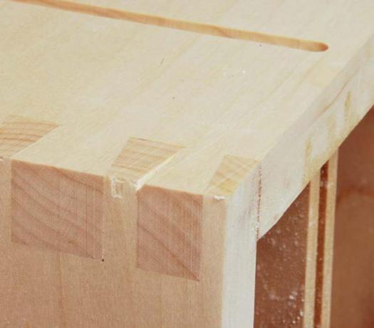

Chipout in dovetail
Filler applied
