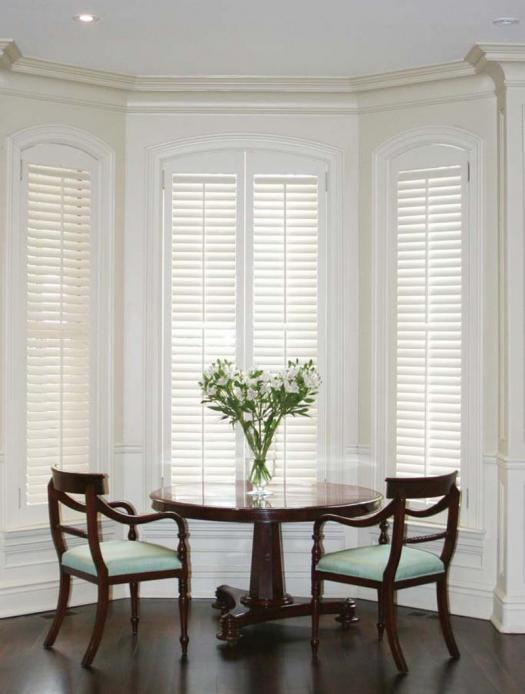

‘Louvre’ shutters consist of a frame with horizontal slats (blades). The blades can be fixed or operable (the blades tilt up and down). You’ll also find ‘café’ style shutters that have operable louvres only in the bottom half of the frame; the top half of the frame is either open or has an insert (often glass). As well, for tall windows you can have ‘tier-on-tier’ shutters; one louvre shutter installed on top of another louvre. This enables you to open either the top or lower shutter independently. Louvre shutters, more often than not, are mounted so that you can swing them open or closed. You’re also more likely to find them on the inside of windows, particularly in living rooms, dining rooms and kitchens.

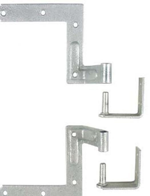

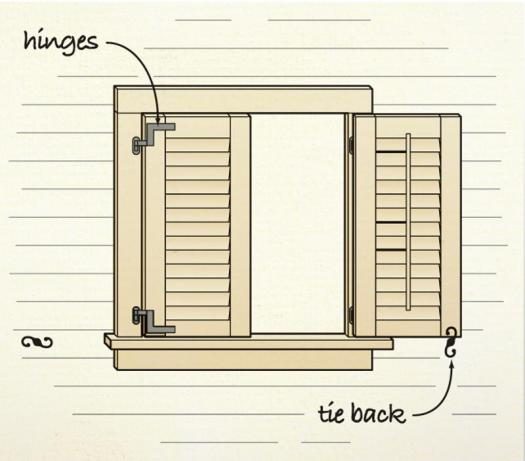

Traditional style (Colonial) shutters have narrower frames and louvre blades (usually 1-1/4″ wide), while plantation style shutters use wider blades (up to 4-1/2″). Depending on the hardware you select, you can mount shutters on the inside or outside of the window frame. A variety of specialized shutter hardware is available, (stanleyhardware.com, timberlaneshutters.com). Exterior hardware is typically galvanized, enamelled cast iron, or powder coated stainless steel. For exterior shutters the hinges pivot outwards until the shutter rests against the surface of the house. Tie backs (shutter dogs) then hold the shutters in place. On interior shutters conventional hinges are used. The style, size and colour of shutters, and the hardware you choose depends as much on personal preference as it does on the size and depth of the windows and the style of your house – think of shutters as eye makeup for the house.

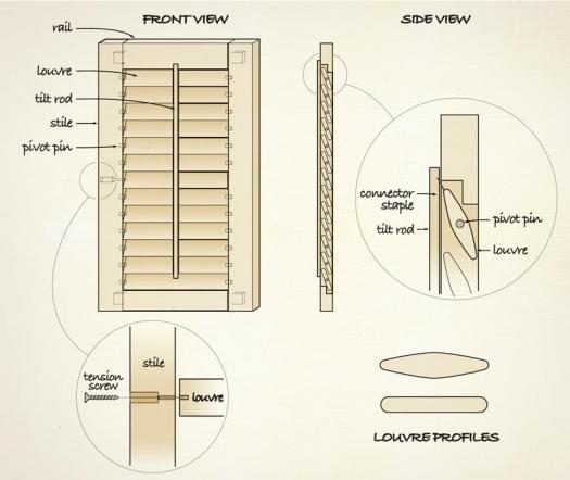

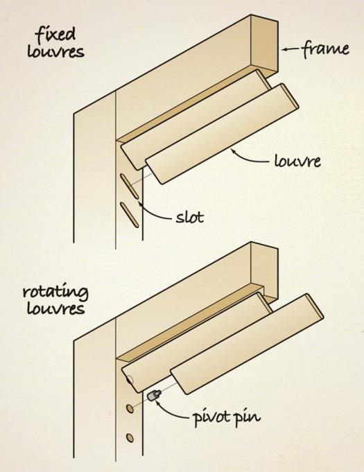

The blades for fixed louvre shutters are held in 45º slots milled in the stiles. You’ll need to construct a simple jig to rout these slots, or if you have the Leigh Frame and Mortise Jig (leighjigs.com), you can purchase a template to rout 1/4″ x 1-1/4″ slots. For rotating blades you install pivot pins (cordscanada.com, shuttermedic.com), into the stiles, and into the ends of the blades. A tension screw is installed through a stile into the middle blade. Tightening or loosening the screw affects how smoothly the blades open and close. A tilt rod is attached to each blade, either by eyelet screws or connector staples.

Basic shutter styles
Fixed and rotating louvres
Shutter anatomy
Exterior shutters
