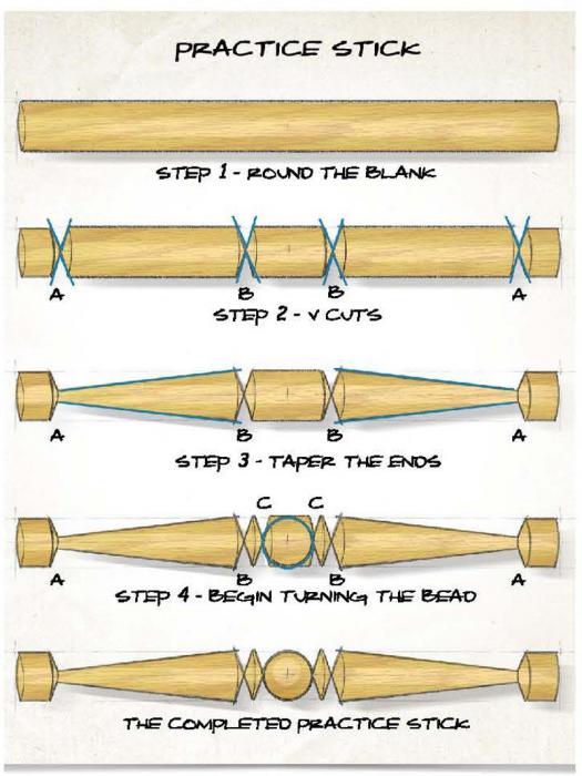

In order to become proficient with the skew, it’s important to get a feel for the tool and the techniques for using it properly. The project I’ve selected is a “practice stick”. This piece is turned exclusively with the skew. Practicing it again and again will give you the confidence you need to use the skew without fear. Start with a blank approximately 1-1/4″ square by 8″ long. Mount the blank between centers or in a chuck with the tail center in place. You’ll notice that I didn’t include dimensions on the drawings that accompany this article. If you wish to calculate and mark out the intended design, then do so.
However, I find it advantageous to practice this piece by eye. Doing so helps improve your eye for dimension. Remember, this is a practice piece.

The first step is to turn the blank round. While you can use a roughing gouge for this stage, I’ll show you how to round it with the skew. With the toe of the skew pointing up, tilt the shank approximately 45° left of vertical and swing the handle approximately 45° to the left. The cutting edge should be at a sharp angle to the axis. Adjust the tilt and angle of the tool until the bevel is rubbing. (You may want try this with the lathe turned off at first). Continue making slight adjustment until you begin to get a cut on the bottom half of the cutting edge. Never make a cut above the center of the tool. Once you have established the cut, hold that position and advance the tool to the right. You can cut to the left by mirroring this technique. Continue in this manner until the blank is round.

The next step is to define the major diameters by making V-cuts at each end (A), and on each side of center (B). Position the tool with the toe down, and the skew tilted slightly toward the center of the intended V. Begin with the handle low and raise the handle to drop the toe into the cut. Cut as deep as you can, but don’t force it. Move the tool to the other side of the V and mirror the cut. The object is to meet in the center at the bottom of the V. Continue in this manner, enlarging the V until you reach about half the depth of the blank. Make all four cuts like this.

For the third step you use a planing cut to taper the two sides. Start close to the small ends (A) and make a few light cuts toward the ‘V’-cut. Progress towards the middle, taking longer cuts until the last cut is along the whole length of the taper. Do the same for both sides.

Begin the center portion by making a V-cut (C) beside the two center V-cuts (B) you made earlier. Make the cut in the same manner, and expand the width until the two Vs meet at the top. Try to match the depth at the same time. The last cut will be the most difficult as there is very little material there to support the tool when you begin the cut. Complete the two V-cuts, then begin to form the ball in the center.

Begin with your skew in the ‘planing cut’ position. Start the left side of the ball just to the right of the V you just made. Lift the handle and roll the skew counter clock wise so that the shank ends up close to vertical, with the toe up. Take light cuts, improving the shape with each cut. Move to the other side of center and repeat the process in the opposite direction. You’ll find it easier to cut in one direction, then the other, but you need to practice both directions.
