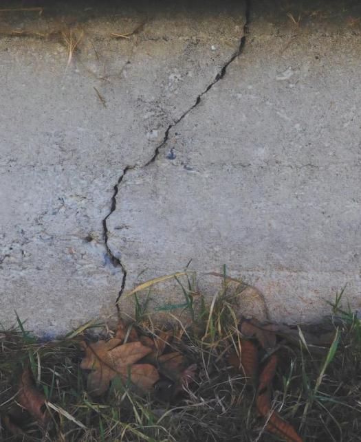

Bigger Problems
 This foundation crack is a problem. Notice it is wider at the top. This indicates the ground has subsided at one end of the wall. The reason for that settlement should be investigated.

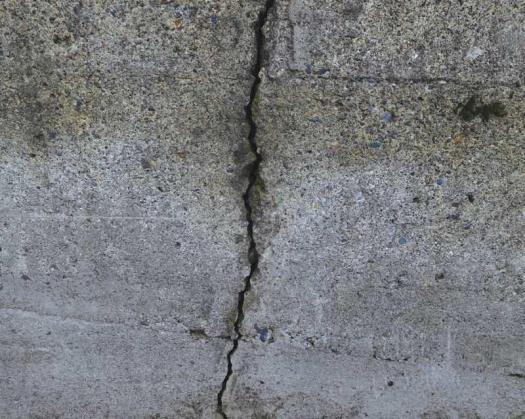

Not So Bad
 Cracks are never a good thing, but this one is less worrisome from a structural point of view. The width of the crack is not too large, is consistent top to bottom, and the wall is not out of alignment. The issue of possible water penetration should be addressed, though.

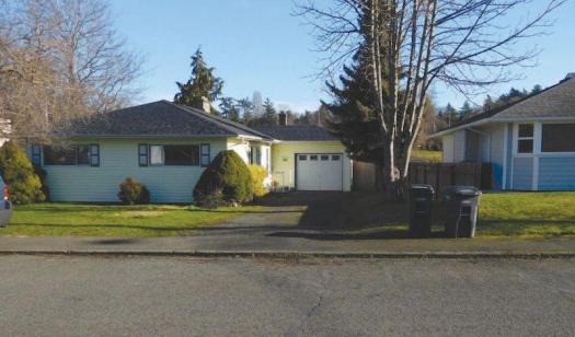

Minor Differences Can Be Bad
It doesn’t take much of an elevation difference to cause problems between properties. The house on the left had water entering the crawlspace. The home on the right did not, even though the floor level is only about a meter higher.

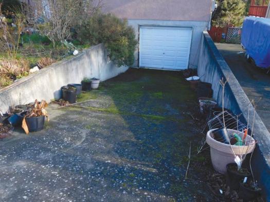

Looking for Trouble
 A severely sloped driveway such as this should be avoided. The drainage system would need to be well thought out and professionally installed to avoid a flooded basement.

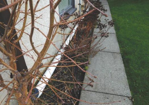

Keep the Water Away
 A 3-diameter PVC pipe has been installed to collect roof water and direct it away from the foundation, greatly reducing the likelihood of basement water problems.

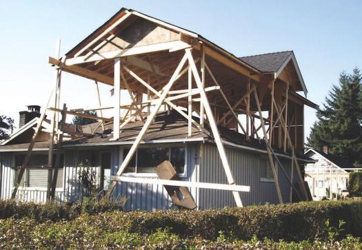

Plan Accordingly
 The steps needed for this addition are definitely not in the correct sequence. The existing roof should have been removed before installing floor joists, building walls, and then starting work on construction of the new roof.
