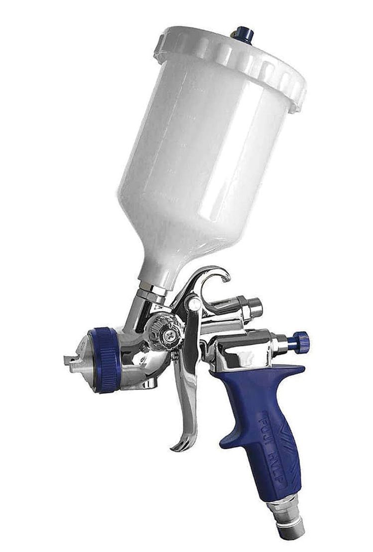

Gravity Feed
A bit lighter and more maneuverable than a bottom feed gun, a gravity feed gun can be used at lower pressure than a bottom feed gun. These types of spray guns are commonly used in fine furniture making situations.
