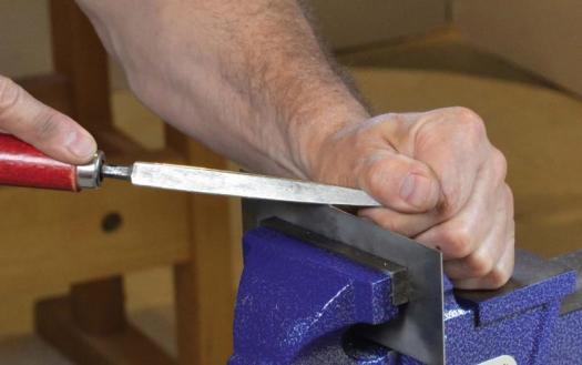

Preparing a card scraper
Joint the long edge of the card scraper, by taking six strokes with a mill bastard file. Remove any burrs by placing the broad face of the scraper on a 1000-grit stone and taking several passes on either side. Now, put the scraper on edge and move the scraper across the stone to remove the file marks.

After filing the edge, take several passes on a stone to flatten the two broad surfaces of the card scraper. Tilt the scraper 90° and take several passes on the same stone, removing the file marks. At this stage, you’re ready to create the hook on both sides of the scraper with a burnisher. Though this step takes some practice, it doesn’t take long to produce a proper hook.
