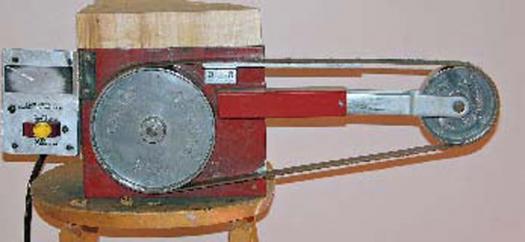

By establishing a flat bevel, all subsequent honing will repeatedly refine the cutting edge without any blunting. I have found that a belt-sander with a suitable selection of belts works beautifully.

Modified 1 inch belt sander

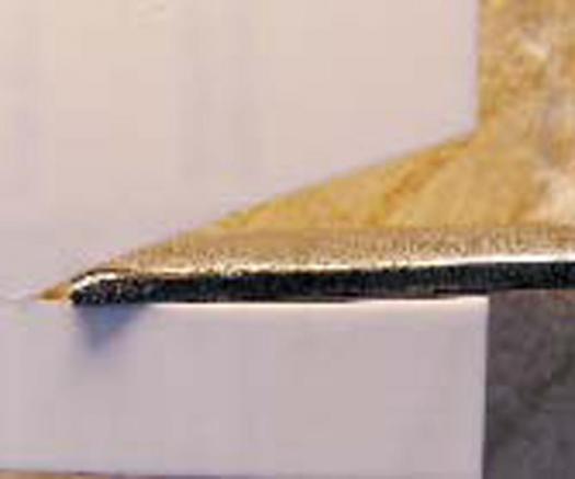

A plastic guide helps you to see when you have obtained a 15 degree bevel

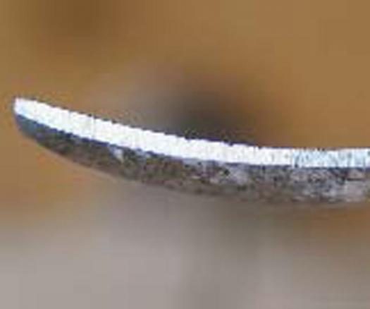

Sharpening creates a finer cutting edge

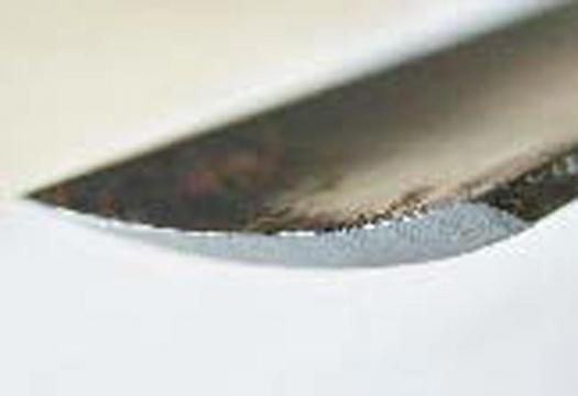

The surface of a sharpened gouge
Honing creates a highly reflective surface

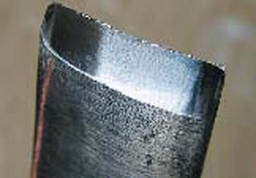

For many, the first action is the hardest. To see what you are doing, you must first blunt the cutting edge of the tool. Do this by pressing the tool vertically onto the belt sander. By doing so, a reflective surface is created. I sharpen my tools at an angle of approximately 15º and make a guide from a plastic margarine bucket lid.

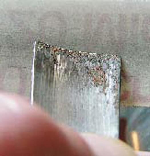

Now that there is a visible edge, the goal is to grind it away at the desired angle until the flat, reflective surface disappears. I do this grinding freehand; however, it would be much more consistent to make a bracket upon which you could rest the tool and ensure a precise angle. When grinding, ensure that the belt is always moving away from the cutting edge.

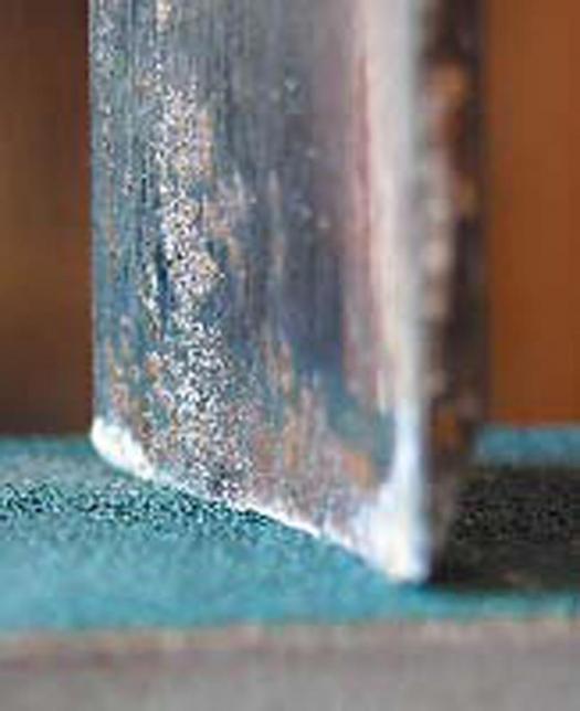

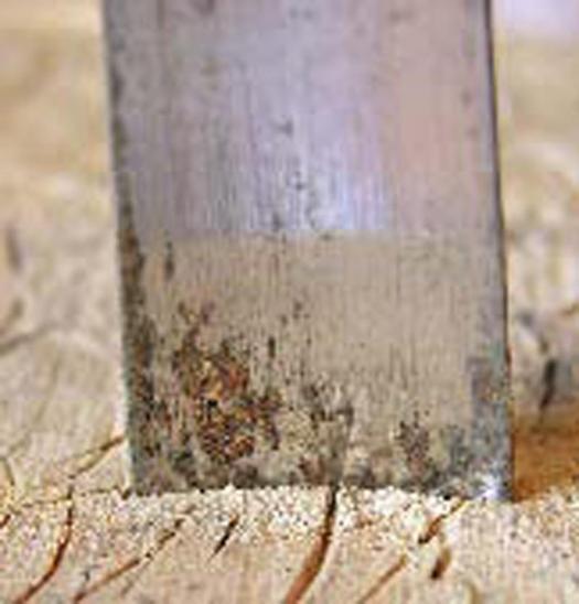

For grinding, I use a 120 grit belt and apply very light pressure because this belt is quite aggressive. As soon as the reflective surface has disappeared, a burr that looks like a thin line of tin foil will be created (notice the grooves made by the 120 grit belt). To remove the burr on the cutting edge, thrust the gouge vertically into a block of wood and rock the tool to-and-fro. When the end of the gouge no longer reflects light and the desired cutting angle has been established, the grinding step is complete.
Remember: the goal is to remove the reflective surface – this requires careful and patient effort, flat tip while retaining the straight edge of the gouge – this requires care and patience.

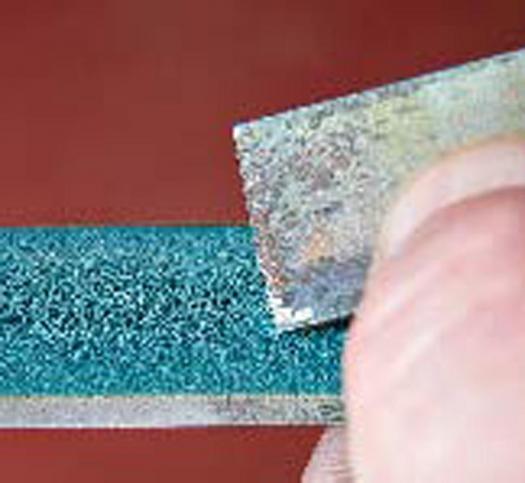

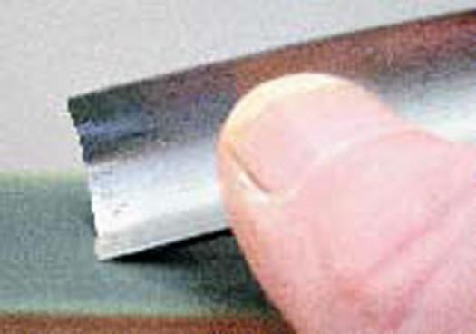

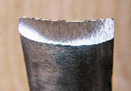

The “sharpening” step refines the shape created with grinding, and establishes a finer cutting edge. I use a 20 micron belt for this purpose. In my belt-sander, there is an area between the flat surface and the pulley wheel where the sanding belt is unsupported. This is the area I use for sharpening. I hold the gouge perpendicular to the belt. Using light pressure, the coarse grooves made by the 120 grit grinding belt are removed and a much smoother surface is achieved.

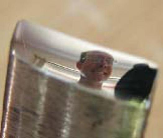

With a flat bevel and a well-prepared surface, an exceptionally sharp cutting edge can now be established by honing. I use a leather belt thoroughly coated with green chromium oxide (jeweler’s rouge). For honing, you can use as much pressure as you like because the leather belt carries heat away and the tool will not overheat. The belt should be turning away from the cutting edge. The result is a highly reflective surface and a keen cutting edge. As a final step, I polish the inside of the gouge using a cloth wheel coated in chromium oxide.
