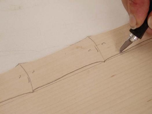

Cut with the knife blade perpendicular to the veneer and cutting surface. In theory, the beveled blade produces pieces with a slightly angled edge, but at the end of the day I find it’s not a big deal. Maybe when you’re an expert in the field of marquetry you can concern yourself with these tiny details. If the largest gap in my marquetry work was 1/128″, I would have been more than happy when I was just learning. Heck, even now I would take those results! A grip very similar to holding a pen or pencil should be employed, as it’s comfortable over the long term, and you have a lot of control over the knife. When cutting always orient the grain of the veneer so you’re cutting ‘downhill’. There will be much less tendency for splits to occur in the piece you’re keeping. Cut on top of a piece of Masonite or Melamine-covered particle board. When it gets too damaged, just cut a new piece.

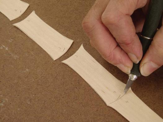

Layout and Cutting
With the full-size drawing in front of me, I start to draw some of the larger, background pieces out on the veneer. It may be handy to use tracing paper to transfer the design to the veneer. Don’t leave a heavy, dark pencil line when you draw on the veneer because it may return just as you apply the first coat of finish. I think a fine mechanical pencil is a must for almost every woodworking application, but especially here. It’s accurate and always sharp. While drawing these cutting lines on the veneer, keep grain direction in mind for two reasons. The most important reason is that the grain direction will go a long way to tricking everyone who sees the finished piece into thinking it looks even more alive and life-like. A secondary reason to consider grain direction is because you have to eventually cut these pieces out. Pieces with short grain will be more difficult to keep intact, but it might be worth it for the overall look of the piece. If you can orient the pattern in such a way as to keep the short grain to a minimum, especially for your first project, you will thank yourself. If the piece has some short grain, you can apply veneer tape or Scotch tape to the area before you make a cut. It will help hold those fibres together until the piece is pressed to the core.
When cutting across the grain, you may have to make two or three passes in order to cleanly sever the grain. Don’t force it with one pass or you’ll likely ruin the piece you’re cutting.

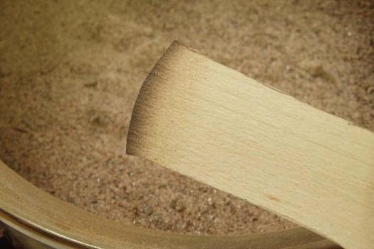

Sand Shading
Shading individual pieces adds an incredible sense of depth to your work, and with a bit of practice is fairly easy to do. Put some clean, dry sand in a pot. Place the pot on a hot plate (or a stove element) and allow the sand to heat up. Determining the correct temperature requires some experimentation. With scraps of the same species of veneer as in your project, test each piece by dipping it into the sand. The deeper you go, the hotter the sand is, and therefore the darker the shading will appear. If the sand is too hot, the piece will tend to shrivel and crack. The correct temperature will allow you to dunk the piece in the sand for a few seconds while manipulating its position. This movement gives a shade line that fades away, giving a better 3-D effect. It will take a while for you to dial in the right temperature, and get comfortable with this technique, but it’s nothing but practice at this stage. As you’re sand-shading, do your best to have consistency. If one tree trunk is shaded on its left side and the tree beside it is shaded on its right side, the image will be much less believable. It’s a simple, but important thing to keep in mind.
When a piece of veneer is put in hot sand, most of the moisture is removed from it, causing it to shrink. Sometimes I will shade a piece first, then cut the mating sections, to ensure the fit is tight. You can also cut the piece slightly oversize, shade it, then cut it to final size.
I use tweezers to hold the piece of veneer, as even touching the sand for a split second is painful. Hold the piece away from the area to be shaded, as the metal tweezers will suck away heat from the piece of veneer, causing blotching where it was being held.
Sand shading should be done over the duration of the project on a “need-to” basis, so it’s good to have a hot plate on at all times. Otherwise, you forget what piece goes where and these little pieces start playing tricks on your mind. One final word of caution – don’t go overboard. You don’t want too much of a good thing.

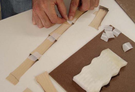

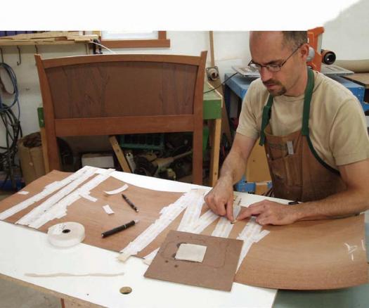

Start to Assemble the Pieces
Once you have a number of pieces ready to go, you can start to assemble them with veneer tape. Some people use a tiny dab of glue on the mating edge of the two pieces to help keep the edges aligned after taping them together, but I have never had the need to try it. I find proper veneer tape is strong enough to hold the pieces securely, allowing me to pass on the glue at this stage. Feel free to use low-tack painter’s tape to temporarily hold pieces in place so you can cut or assemble different sections. This tape acts as a third hand. It should be removed before pressing, so don’t apply veneer tape over it.
I tear off a bunch of small pieces of tape so they are ready and waiting. With a damp sponge or paper towel by my side to moisten the tape and activate its glue I start assembling the pieces, keeping them as tightly together as possible. Before pressing the sheet to the core I like to make sure all the seams are covered with one layer of veneer tape. This stops glue from squeezing out, and helps keep the work together during pressing.

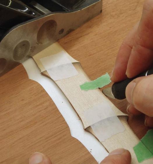

Depending on the design you may have to assemble a number of pieces then cut out the cavity where those pieces will go. That was the case with the bamboo marquetry I turned into a headboard. I cut, shaded and assembled all the maple bamboo sections, then let them into the mahogany background. It was far easier to work with the pieces of bamboo taped together, as opposed to each piece individually. Each situation will call for a slightly different approach. At this stage, just continue cutting, shading and assembling the pieces similar to a jig-saw puzzle. Sometimes when the sheet you’re working on gets a bit large it may tend to curl. I use heavier objects to keep the veneer surface flat, so the sheet will press flat when complete. I also use long, straight strips of plywood or a straightedge to help hold an area down while I’m cutting or assembling pieces.

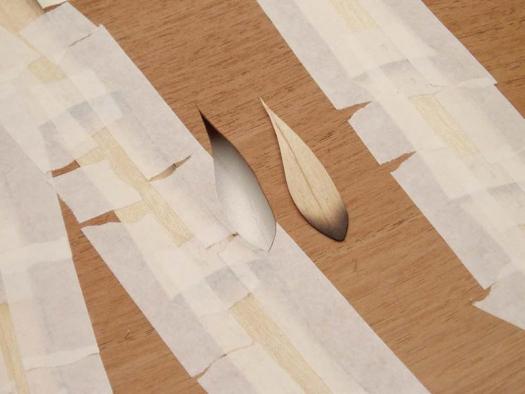

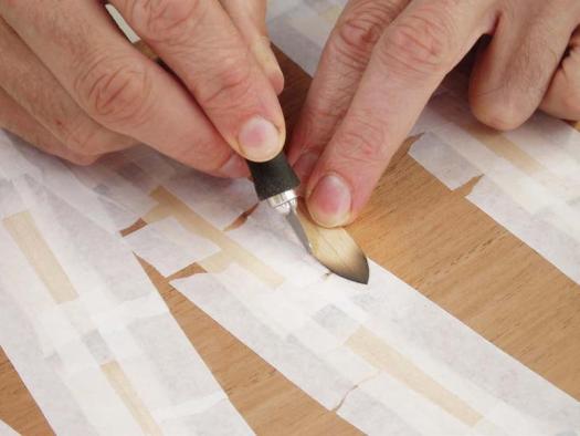

I usually leave smaller, foreground pieces that I can let into the surface until last. This allows me great precision when placing them, as sometimes the best location for them can be slightly different than in the initial drawing. You can even use what’s called the ‘window method’ to cut these, and many other pieces. To do this, you first cut out the cavity. Then place the piece of veneer you want to let into the cavity underneath it. Shift the upper piece to see what grain orientation will look the best, then mark or cut out the piece through the opening.
It’s easy to say, but try not to get frustrated. If you find you can’t for the life of you keep the gaps to a minimum, don’t be too hard on yourself. Once the piece is pressed to the core the glue has a way of working into the seams, helping to fill gaps and level the surface. It will not fill ⅛” gaps, but it will improve everything just that little bit. And even more importantly, with a bit of practice you’ll see an improvement.

Draw Right on the Veneer
To make things easy, mark light lines on the veneer then cut them out. When making multiple parts, I number them to make sure they go back in order.
Cross Grain Cuts are Tricky
 Sometimes you will need to score the grain first then make an additional one or two passes to sever all the fibres.
Sand Shading
This is the perfect way to add depth and shadows to your work. Practice with scraps first to get the right temperature and technique down.
Sticky Stuff
 Veneer tape will hold all the pieces together as you work your way along. A bit of moisture on the underside of the tape is all that’s needed.
A Helping Hand
With low-tack tape to hold the bamboo in place, I cut the mating mahogany edge. There are times when having a couple of relatively heavy (block plane) or long and straight (ruler) objects around is a good idea. They can act as another set of hands, keeping the sheet flat.
The Foreground is Usually Last
To keep perspective as realistic as possible you will need to let in the “closest” pieces last so they will overlap the rest of the image. I also leave small items that only mate with the background, like this bamboo leaf, until the end. I prefer cutting the piece then cutting the cavity, but it can also be done the other way around.
