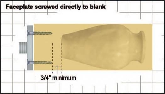

Using Faceplates
You can screw a faceplate directly to your blank if it is deep enough. Use the longest and thickest screws that will leave at least ¾” of material between the end of the screws and the bottom of the finished piece. Alternatively, you can use a “false faceplate”, a piece of scrap wood that’s screwed to the faceplate with your blank glued to it. I keep several false faceplates on hand, and use hot melt glue for quick mounting of small pieces. It gives a fair bond but will not survive aggressive turning. Cyanoacrylate glue (instant glue) works extremely well on small to medium sized pieces. (approx. 6” diameter or less). It bonds quickly and holds well on long grain but can pose some problems on end grain. Epoxy is a good choice for larger pieces and for problem pieces, such as end grain. It also gives a very reliable bond in a fairly short period of time. The “paper method” gives a reliable bond. Apply wood glue to the false faceplate and to the bottom of the blank. Clamp the two together with a piece of paper between them and allow to dry overnight. Use standard writing paper, printer paper, or paper bag. Do not use heavier paper, like card stock, as it will separate too easily. Once turning is complete, a sharp blow to the false faceplate separates it from the finished piece. There will be some remaining residue that will need to be sanded off.

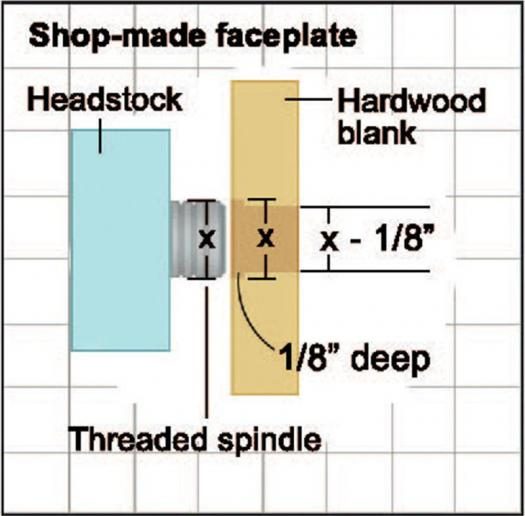

Shop-made Faceplates
I often use a shop made faceplate when mounting turnings up to 16″ diameter. It’s handy and simple to make. Start with a circular blank of dense hardwood (I use hard maple) approximately 6″ diameter and 1″ thick. Bore a hole in the center about ⅛” deep, the same diameter as the drive spindle on your lathe. Bore a second hole, ⅛” smaller in the center of the first hole, all the way through the blank. Place the larger hole over the spindle thread and force thread the blank on to the spindle until it’s seated (a little wax helps here). True up the edge and face of the blank and use it as you would a regular faceplate.
