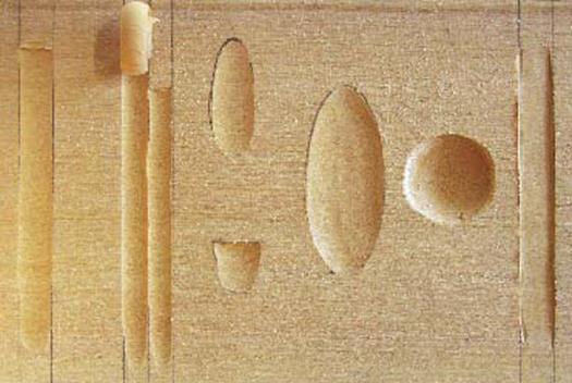

Let’s follow the painters’ example and make a study board. The following seven exercises introduce the fundamentals of intaglio. The first six exercises are performed using a #7/14 gouge; however, a #5, 8, or 9 would serve the purpose equally well. The seventh exercise is done with a #12/8 parting tool (V-gouge). The exercises are done across the grain of the wood.

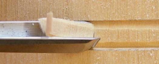

Single Pass Trough
Draw two parallel lines narrower than the width of your practice gouge. In a single pass, carve a trough the length of the lines keeping the cutting edge of your gouge on both lines at all times.

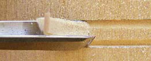

Double-Pass Center Ridge
Draw three parallel lines with the distance between each pair less than the width of your gouge. Carve two troughs side by side. Aim to preserve a straight consistent ridge where the two troughs touch. (For this example, I used a #9/12 gouge.)

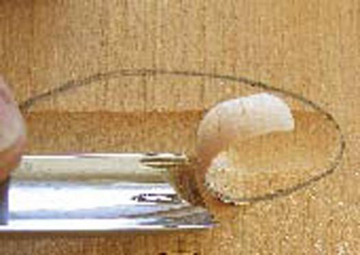

Single-Pass Ellipse
Draw a long elliptical shape with the width narrower than your gouge. Enter the wood with precision at one end of the ellipse and carve the length of the ellipse in one pass. Aim to keep the cutting edge of the gouge exiting the wood on the line on both sides of the ellipse. To obtain a precise shape and to finish the cut carefully, you might need to break off the wood chip in order to see the lines.

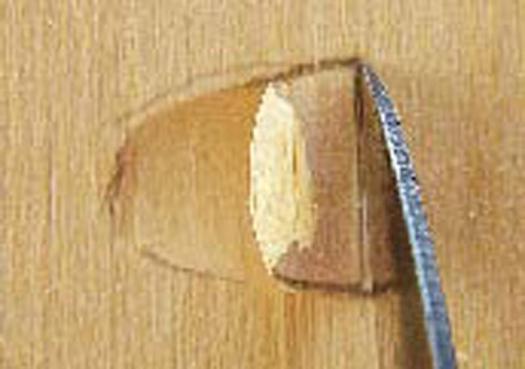

Cup
Draw half of an ellipse with a flat top. Using the same technique as for a single pass ellipse, carve the shape of the ellipse until the cutting edge of your gouge reaches the straight line. Use your knife to cut straight across the top of the ellipse and remove the wood.

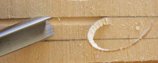

Multiple-Pass Ellipse
Draw an elliptical shape with the width wider than your gouge. Make your first pass down the centre of the ellipse entering and exiting the wood smoothly. Follow with another pass on each side.
The objective is to have each pass of the gouge join the curve at the bottom smoothly. As with the other exercises, keep the cutting edge of the gouge on the outline of the ellipse.

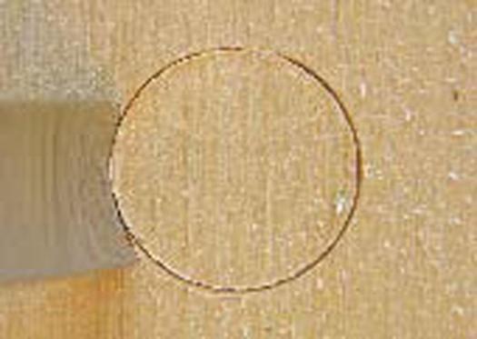

Circular Globe
A well-made gouge will inscribe a perfect circle when rotated on its cutting edge.

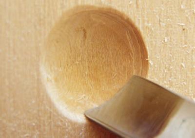

Try it! Then, using the same gouge, make a series of passes from the outline of the circle toward its centre. A few passes of equal depth and arc will excavate a globe of wood. You can tell how round the hole is by observing the shadow cast into it.

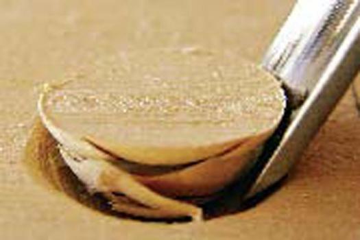

Square-Sided Trough
Draw two parallel lines slightly further apart than the size of your parting tool. (In this example, my parting tool was a 12/8, i.e. 8 mm size; so, my lines were 1 cm apart.) Using care to keep the depth of cut equal, carve a vertical edge on each side of the trough. You will need to hold your Vgouge on a slight angle to keep the cutting surface running straight down your line.
Then, using one side of the parting tool, carve away the wood in the centre of the trough thus joining the two vertical side cuts and forming a square-sided trough.

Lines narrower than gouge
Cut edge on both lines
Carve two parallel troughs
Create precise ridge between troughs
