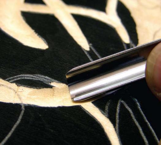

Remembering our guideline to carve the most distant part first and shallow, use a #7/5 gouge to carve the small portions of plant stem that pass behind the treble clef. This is an excellent exercise in carving technique – one must keep both points where the gouge emerges from the wood on its pencil line. Use the same gouge with the same precision to carve the second layer – the thin stem of the treble clef. Carve the wide stems of the treble clef with a #8/14 gouge. Because the width of the feature is wider than the gouge, a number of passes will be needed.

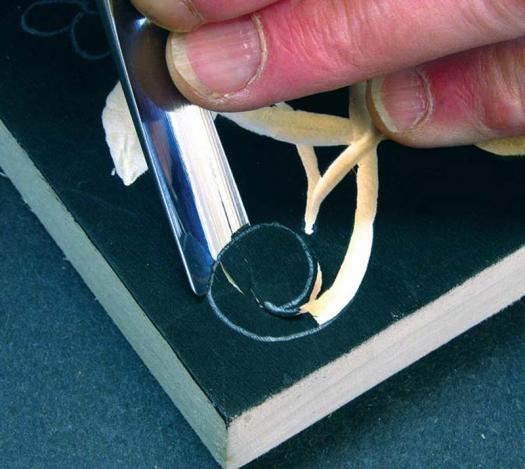

To make a good impression, a few elements benefit from some special attention. Where features overlap, (i.e. where a #8 gouge cut across a #7 feature), use a small #9 gouge to sharpen the edge. To make the treble clef’s tail, twist your #8 gouge in a circle. Finally, use a small drill (or a Dremel tool) to make the centre of each flower. A deep hole will look totally dark while a shallow hole will look like a button.

Wide areas require multiple passes

Carve tail with a twist of the gouge
