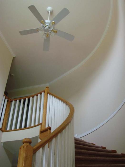

The crown job in our home involved a short convex wall in the lower washroom and a long concave wall in the staircase. I will begin with the short convex wall and then follow with the procedure to create a curved piece for the long concave wall.

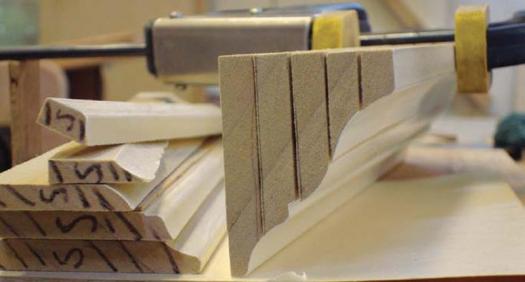

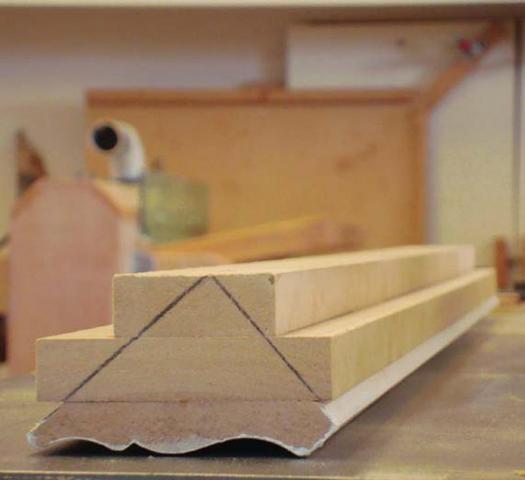

You need to create a filler behind both crowns by gluing strips of similar material to the back. By using a similar material you will reduce the chance of creating stress and twisting action during the shaping on the mould.
You now need to trim the filler to the spring angle of the crown (38/52) so set your table saw to the correct angles and rip the filler so you have two pieces.

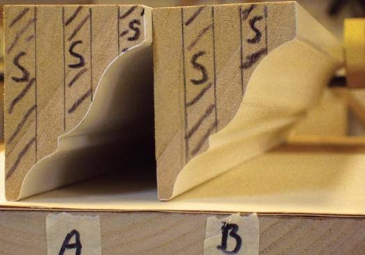

I have divided both crowns into five segments, each about ⅜” wide. This thickness is not critical but may have to be reduced to ¼” for a tight radius. You only need to consider two things as you are creating these spacings. First, it needs to be thin enough to bend easily, and second, the saw should not cut into the sharp profile of the moulding. Try to stay at least 1/16″ away from the edge of this profile. Label the crowns ‘A’ and ‘B’ and pencil in an ‘S’ for each scrap segment. Now, because you will be cutting and keeping every second piece to restack to the original thickness, you need to determine the width of your band saw kerf as you are making one crown moulding out of selected segments.

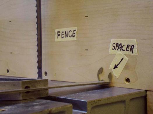

I determined the width of my saw kerf to be .058″, which happens to be the thickness of the snap ring.
All cuts are performed so that the cut off piece falls away from the blade. Set up the fence the width of the crown less the thickness of the first waste segment.
Because the fence needs to be moved after every cut, I use the combination square as an adjustable stop and index it into the mitre slot.

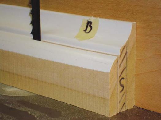

  1. Take piece ‘A’ and remove the first segment (approx ⅜”) and set it aside as scrap.
  2. You now need to move the fence the width of the saw kerf by using the combination square and the spacer or washer that you determined was the thickness of your saw kerf. Index the body of the square in the mitre slot, place the spacer against the fence and extend the blade till the spacer is contacted and lock the square. Remove the spacer, loosen the fence and move it towards the saw blade till it contacts the square, which is still indexed, and lock it in place.
  3. Take piece ‘B’ and make the cut. This piece you keep. It should be the thickness of the scrap piece plus the width of the saw kerf. Reposition the fence approximately ⅜” for the next cut on the same piece ‘B’ and scrap the off-cut.
  4. Reposition the fence the width of the kerf as before. Now take piece ‘A’ and make your cut and keep the off cut.
  5. Reposition the fence again, about ⅜”, and make another cut on piece ‘A’ for the scrap cut.
  6. Continue the procedure until all cuts are done.

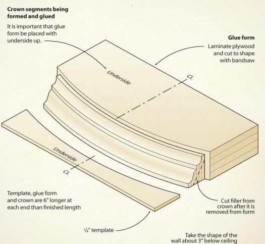

The convex curve gluing form that you need to build should be the height of the crown, by 12″ wide and the length of the crown pieces. I took a profile of the wall with ¼” plywood and shaped it with a rasp until it conformed to the wall at a point three inches below the ceiling and then transferred that shape to the gluing form and cut it out on the band saw.
Because it is unlikely that the curve of the wall will be a perfect arc and symmetrical, it is important that you mark the topside and the underside of the gluing form you just made and place it upside down on the bench because you will be gluing the crown upside down.
During the glue-up I found it easier to glue and clamp one or two pieces at a time instead of all at once. Placing a brad nail at one end also helped keep the moulding aligned.
With the crown still attached to the form, clean the dried glue and fill the joints with Spackle drywall filler. Sand the profiles smooth with curved sanding blocks. Take your time here because the glossy paint top coat will highlight any dips and hollows. This step is not as difficult as one might think because you are only filling the saw kerf and following the profile with the sanding block. Seal the surface with two coats of shellac.
Once the crown is off the form, set the band saw table to the spring angle and cut the filler piece away from the back of the crown to create a curved crown moulding. This is performed freehand on the saw. If the filler is not removed, it will interfere with the corners and the crown will not fit tightly to the wall and ceiling.

Having completed the convex curve, I was now faced with a long concave wall over the staircase for which I could not possibly make a glue form. The solution is a modification of the previous method and now I use the wall as the form.

Take this moulding and fill the back as before to form a triangle shape that can be resawn.

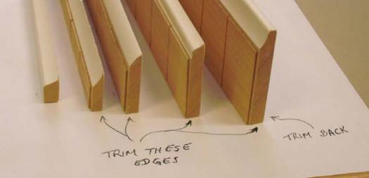

Take the 6″ test piece and place it on the scarf joint of the moulding that is on the wall to determine the fit. You will likely find the dry wall filler is causing a misalignment of the crown surfaces. You will need to take the block plane to the back side of the first segment and also the top edges of the next three where they contact the ceiling. Do this with the test piece before performing the same to the entire length of the long crown segments.
