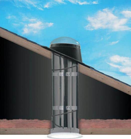

Cross Section
This mocked-up cross section of a typical sun tunnel shows the dome and flashing above a shingled roof, the sheet metal tunnel extending between the roof and the ceiling, as well as the diffuser at the bottom of the assembly.

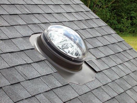

All Finished
A properly installed sun tunnel will keep the rain, snow and sleet out, and not be an eyesore. Depending on the distance between the roof and ceiling, you may need to cut the tunnel section to fit, or use multiple tunnel pieces to bridge the gap. Once your tunnel is assembled and cut to length (again, following the manufacturer’s specific instruc­tions), slide the tube down through the opening in the flashing. Note that the tube components are covered in a protective film. Do not remove this until immediately before installation. If exposed to the sun uncovered, the sheet metal can become hot enough to burn you.
