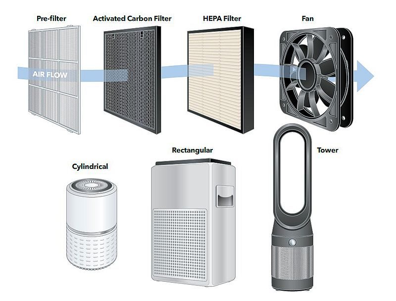

Portable APs, designed to be used in homes and offices, aren’t overly complicated devices. They typically consist of a pre-fil­ter that traps large particulate matter; a HEPA (High Efficiency Particulate Air) filter that traps particulate matter; an activated carbon filter that remove odours, chemicals and gases; and a fan that draws air across the filters, releasing cleaned air into the room. In many APs, all three of these filters are combined into a single main filter that makes filter replacement more convenient.

There are three broad styles of APs: compact cylindrical (a.k.a. desktop) models best suited for small rooms; larger rectangular or console floor models for large rooms; and tower-style models that are also suitable for large rooms. I tried out three popular AP brands using each over a period of two weeks in a 280 sq. ft. living room.

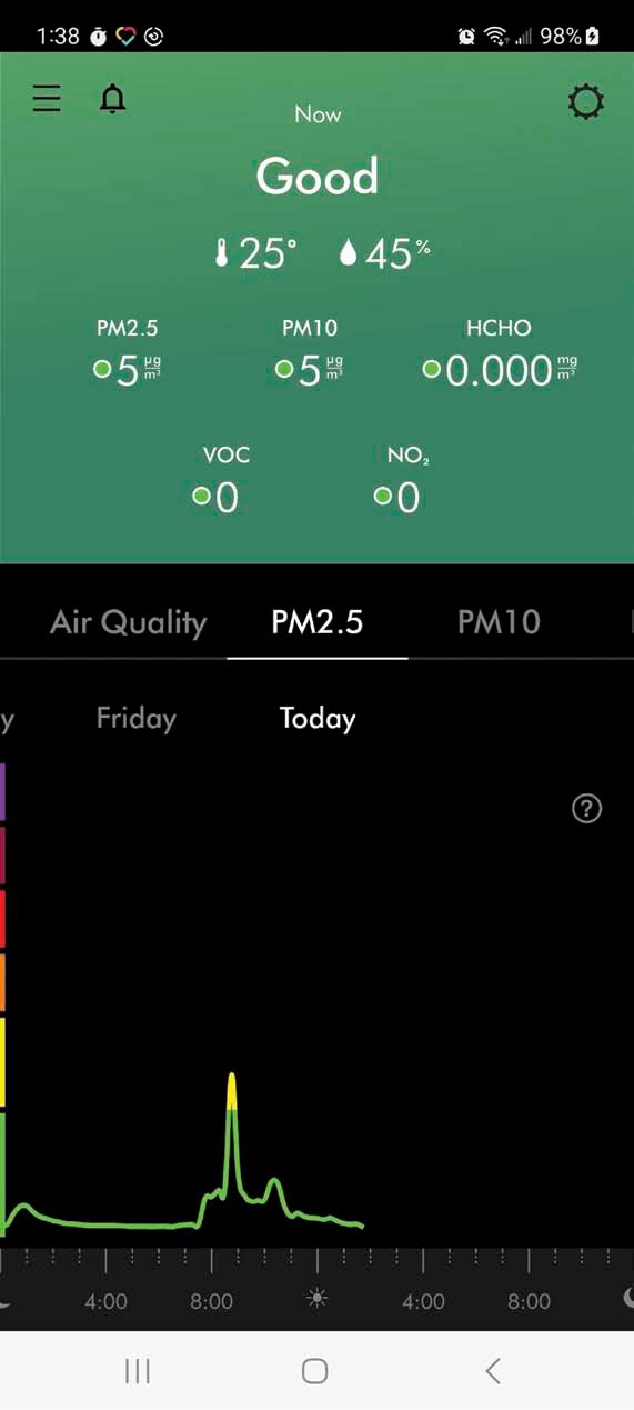

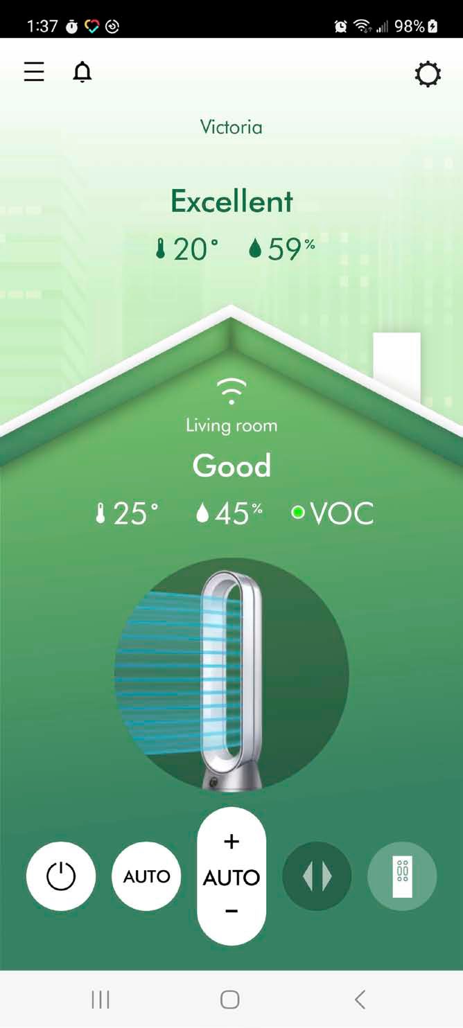

Each unit includes a sensor that measures the amount of par­ticulate matter in the air. The Winix reports air quality in general terms via three LEDs on its display panel. The Mila and Dyson have additional sensors that report on air quality through their apps. You get various graphs and data displaying air quality over time for different indices, including micron sizes of particulate mat­ter at 1 micron, 2.5 microns and 10 microns, and levels of VOCs, carbon monoxide and carbon dioxide, along with humidity and temperature.

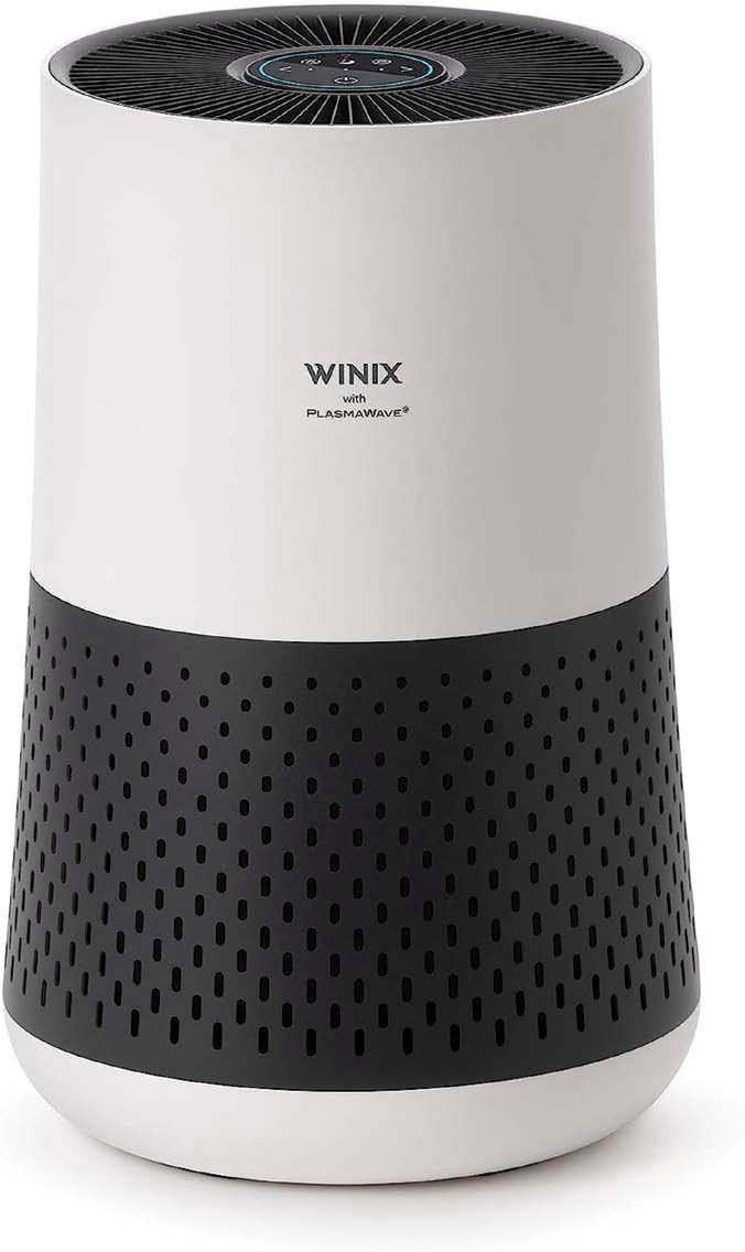

Winix
Small and easy to move from room to room. (Photo by Winix)
The Winix A231, at under 15″ high, 9-1/4″ wide and only 9 pounds, is compact and light enough to be easily moved from room to room. It’s also the simplest AP to use – plug it in and turn it on. It has a fine mesh pre-filter that covers the main filter and a PlasmaWave ionizer that doesn’t have to be replaced and can be turned off. The ionizer emits about 1.0 ppb (parts per billion) of ozone. Health Canada recommends a maximum exposure limit of 20 ppb. Three LED lights (blue, orange, red) indicate the air qual­ity (good, fair, poor). There’s also a manual mode that enables you to select one of three fan speeds, along with a whisper-quiet night mode. The filter lasts 12 months, but you have to clean it every 14 days for optimal performance.

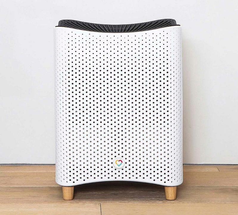

Mila
Stylish and highly efficient. (Photo by Mila)
Mila looks more like a piece of furniture than an AP. Visitors to your home might think it’s a fancy sofa stool. Like the Dyson, it’s meant to be controlled via your mobile device, though you can operate it manually. The base price doesn’t include a pre-filter or main filter; you purchase them separately. You can choose from seven filter types for differ­ent home environments and you can control up to 11 Mila APs via the app. Unlike the Dyson, you can’t power the AP on or off remotely. The on/off switch is located underneath the unit. Mila reports both indoor and outdoor air quality based on an AQI of 0 to 300 and displays fan speed. The lower the AQI number, the cleaner the air. A built-in motion detector can sense when you enter the room and reduce air speed. In auto mode you can select from eight different settings. For example, in Quiet mode it reduces fan speed when you’re in the room; in Housekeeping Service it deep cleans the air when no one is in the room and in Sleep mode it turns off the display screen and reduces fan speed during your set sleep time. In manual mode you can only select the fan speed; Mila then calculates a target AQI and how many minutes it will take to achieve that target. You can’t set your own target AQI.

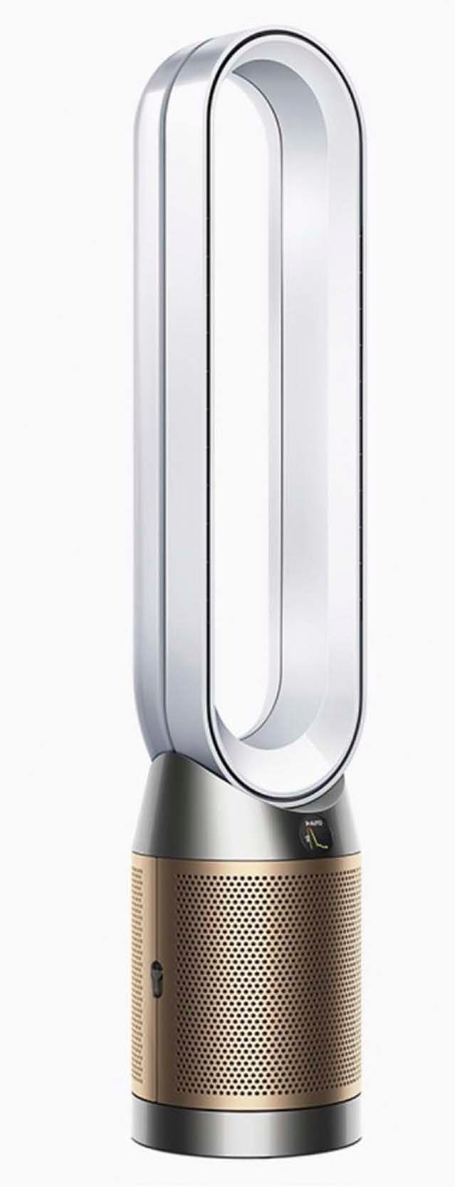

Dyson Purifier Cool Formaldehyde
A classy AP that also incorporates a fan. (Photo by Dyson)
The Dyson TP09 is a sleek modern-looking unit that is both an AP and an oscillating fan that uses bladeless technology, which makes it surprisingly quiet compared to a conventional fan. It comes with a conve­nient remote control that you can use to turn the unit on and off, control fan speed (there are 10 settings), oscil­late the fan, change direction of air flow (towards the back or front of the unit), and turn auto mode and night mode on or off. Like the Mila, you can also operate the Dyson using an app. I found the Dyson easier to pair to the app than the Mila. I also found the app easier to circumnavigate. Unlike the Mila, which uses activated carbon to trap formaldehyde, Dyson has a built-in catalytic filter that converts formaldehyde into water and CO2. The converter never needs replacing. The Dyson doesn’t report air quality using AQI; it uses a six-level scale (good, fair, poor, very poor, extremely poor, severe). As with the Mila you can also see a variety of data and graphs. It reports both indoor and outdoor air quality. There’s also a convenient timer that lets you run the unit for 30 minutes, 1 hour, 2 hours, 4 hours or 8 hours.

Apps Are In
The Dyson and Mila APs have apps that allow the user to control their filter from their smartphone. This is the Dyson app, but the others show similar information.

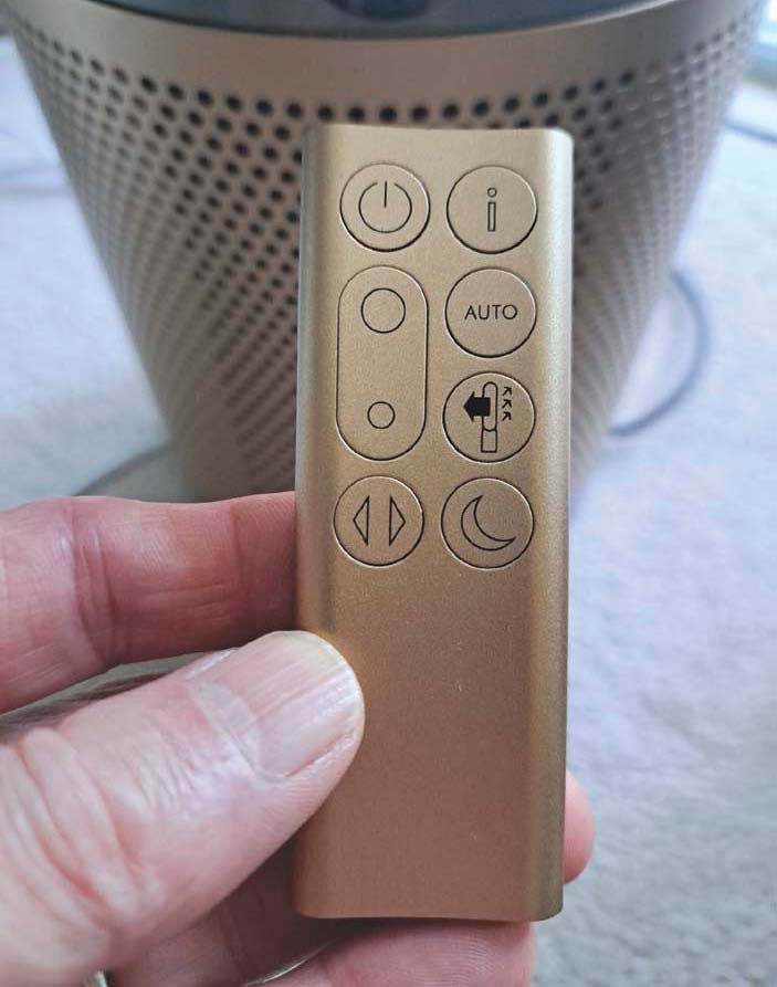

Remote Usage
The Dyson filter is the only one tested that comes with a remote control, making it easy to use from anywhere in the room even if your smartphone isn’t nearby.

Detailed Data
All of the apps show detailed historical data that the user can use to increase or adjust the performance of their air purifier.
Detailed Data
