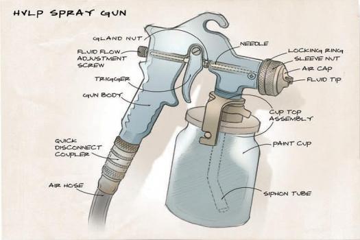

An HVLP gun differs from a conventional gun in a couple of key ways. It’s a bit bigger, with the extra bulk allowing room for the larger volume of air that the system provides. The other difference is that the cup is pressurized via a tube from the main air supply. Most of the supply air passes through the body of the gun and is directed to the holes in the air cap at the front of the gun. A small pressure tube runs from this airway, through a one-way valve, to the cup and pressurizes the cup. When you pull the trigger, the finish is forced up the supply tube and out the fluid tip. As it is squirted out the fluid tip, the air coming out of the holes in the air cap atomizes the finish in a very controlled manner, and directs it at the surface.
HVLP Spray gun
Conventional compressor driven guns operate in a range from 5-12 cfm at 40-70 psi. The HVLP system driven by a turbine will operate in a range from 50 -130 cfm at 4-8 psi. By adjusting the airflow to the gun, you can fine-tune these systems to use only as much air as you need to atomize the finish. Reducing the pressure and airflow allows precise control over your spraying. By reducing the turbulence as the finish leaves the fluid tip, the atomizing air is able to maintain the finish in a tight pattern, which increases the transfer of your finishing material to your project. With conventional high-pressure systems, typical transfer rates can be as low as 30%. By maintaining better control over the atomized finish, transfer rates with a turbine driven HVLP system can be as high as 90%, meaning more finish on you project and less finish all over your shop.
