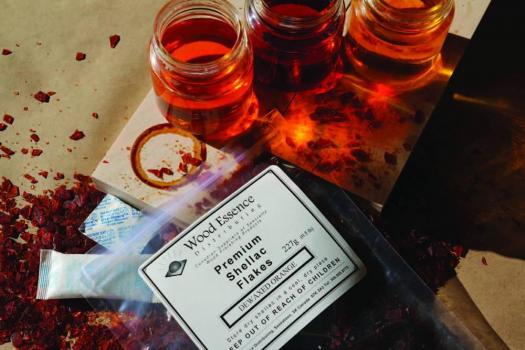

Shellac – develops a beautiful patina over time
There seems to be a certain mystique associated with shellac. Perhaps it has to do with “French polish,” the traditional technique for applying shellac. Or the smooth gloss-like finish that gives an exceptionally deep luster. Whatever the reason, shellac is a versatile finish made from a natural resin secreted by the female lac beetle. The resin is processed into flakes that are dissolved with alcohol to form a fast-drying, moderately wear-resistant finish with excellent water and moisture resistance, but susceptible to damage from alco­hol and heat.
Shellac has a short shelf life (whether premixed or mixed in your own shop). Fortunately, it’s easy to dissolve shellac flakes as needed with alcohol (isopropanol, methyl hydrate or ethyl alcohol) in a mixture called a “cut.” A typical one-pound cut consists of one pound of flakes dissolved in one gallon of alco­hol (or any proportionate ratio, such as 1/4 pound to one quart). Flakes are available in a range of sheens, from clear (super blonde shellac) to rich, darker reddish brown (garnet shellac). Choose dewaxed shellac especially if you plan to top coat the shellac finish with polyurethane or lacquer, as neither will bond well to waxed shellac.
Shellac is easy to apply and repair, and buffs (or rubs out) to a wonderful finish. You don’t have to sand between coats of shellac unless there are bumps caused by dried dust on the surface. If you need to colour-match the wood, you can add an alcohol soluble dye to shellac or you can stain over the shellac.
Sources: leevalley.comwoodessence.com

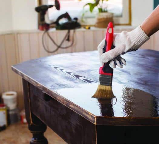

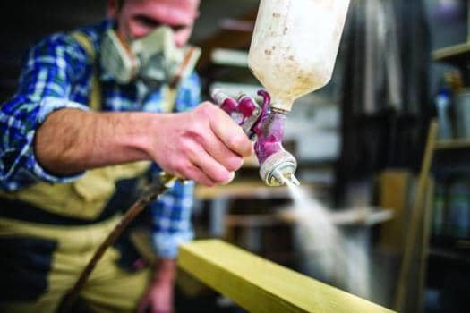

Application Type
It’s common to both spray and brush on film finishes. There are pros and cons to each approach, so do your research before deciding on an option. (Photo by Old Masters)
Brushing is Common
Brushing on a film finish is a very common approach in a small shop. As long as you can keep the dust down, it offers a simple, cost-effective way to apply these types of finishes. (Photo by Old Masters)
