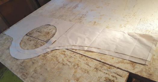

Door swing was critical, as it was very close to my vanity, so I went directly to the bathroom floor to start drafting the countertop full-scale with a roll of newsprint. In this way I was able to mark the swing of the door, the centerline of the sink and plumb the outside lip of the bathtub directly onto the paper. Along with sink size and faucet placement, these were my constraints.

These days, sinks come with templates that give you all the options for layout and faucet placement. My finished drawing contained basin and faucet placement, accounted for the thickness of the backsplash, and included top view plans for cabinetry. Typically, the countertop template is made after the cabinets are already installed, but due to space constraints in this bathroom, the countertop dictated the cabinet shapes.

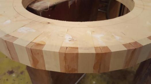

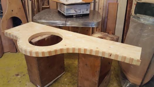

You will need two different 1/4″ plywood templates. The first template is full sized for the copper laminate. The second template is for the countertop substrate (a double layer of 3/4″ spruce plywood, construction grade), which should be cut back approximately 1/4″ to allow for a finished wood edging. Glue and screw the 3/4″ plywood together. This will be the main thickness of the countertop. I did not have any cherry appropriate for a bent horizontal edging, so I milled up some short lengths of cherry to 1/4″ thick and used masking tape to glue pieces to the edge in a vertical fashion. I used my stationary belt sander to angle and fit the pieces one by one around the curves. After cutting the rough hole for the sink (according to the template that came with your basin), set the sink in and trace around the edge of the lip. This is where the plywood must be relieved to allow the sink to sit flush with the plywood surface.
Cut the copper

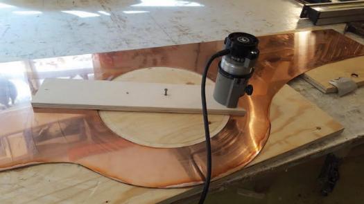

I had a friend rough cut the copper with a plasma torch but have since discovered that a jigsaw with metal blade is easier and less problematic. At this point, it did not appear that this shiny, much-scratched, heat-burned piece of rough-cut copper would ever be pretty . Here, the rough edge of the copper is the same size as the base below, and the hardwood edging is also still rough. The front edge will be machined after glue-up, but the sink hole must be perfect and sanded prior to glue-up. I made a rudimentary circle jig for my router and slowly cut the sink hole to size. My personal preference was to make the sink hole about 1/8″ smaller than the manufacturer called for, to have a bit of an overhang on the sink. Sand the sink hole edge by hand or with a palm sander prior to glue-up, as the sink may be damaged when sanding afterward.

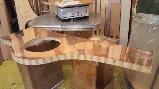

Once the sink has been fit flush into the plywood base, the copper countertop can be test fit. If you are satisfied with how the finished sink hole and sink line up and the other edges look roughly flush, you are ready to glue up. I used Surebond SB-190 Everseal for the glue, but silicone would probably work great too. Clean the back of the copper with solvent, and rough it up by sanding. Set the sink into the plywood on a generous bead of silicone. Smooth a fairly even layer of silicone over the surface of the plywood and over the lip of the sink and apply the copper sheet. Use squeeze clamps, clamps and cauls as necessary to coax into position. The 19-gauge is thick enough to not require hard and perfectly even clamping as veneer would. Clean up any squeeze-out, especially around the sink. Leave overnight to set up.

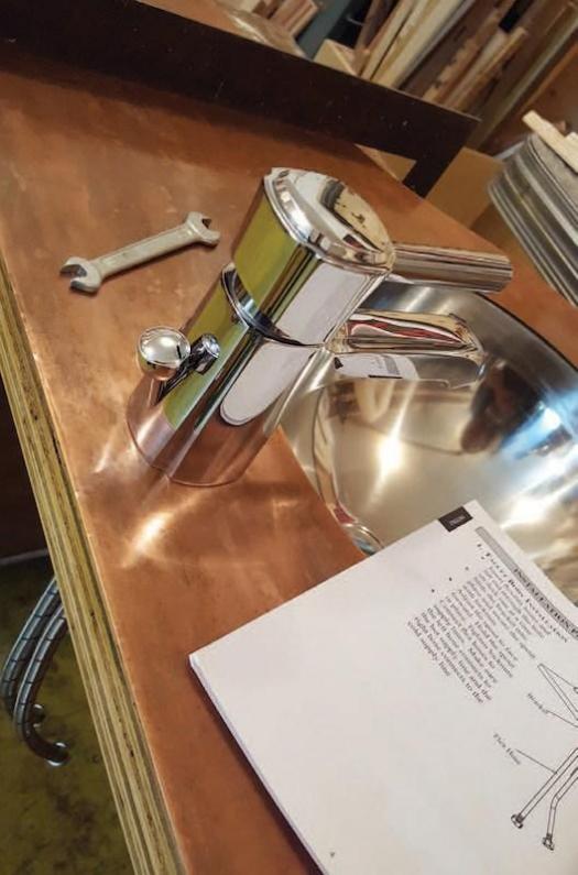

Now would be a good time to cut the hole for the faucet. A 1-3/8″ hole saw is typical for this purpose, although a pilot hole and jigsaw works in a pinch.

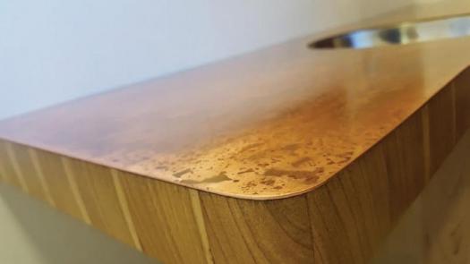

Once the copper countertop edge is shaped, sand the edging as is your preference. I used a random-orbital and palm sander for both the edging and copper top. Sand the copper until it is quite uniform in appearance and soften the front and side edges. Varnish the cherry edge and underside of the counter prior to creating the copper patina, but try to avoid touching the copper after it is sanded as it is easily marked.
Create a patina
On the freshly sanded copper surface, start by wiping away any copper dust and residual oils with solvent. Create a patina by splashing on vinegar and salt and letting it dry. I made multiple applications over a few days until I was happy with the results. I especially liked the effect of sprinkling cheesecloth with vinegar to create bits of random pattern. Play around with your offcuts to find a patina you like. The blue dust created by this process should not be inhaled, so it is very important to wash down the surface with clean water and a soft cloth until the residue has been washed away. Lightly rub out the surface with 0000 steel wool. An occasional application of beeswax and oil keeps the finished surface from changing too much with use, but it will evolve further over time, especially with harsh cleaning chemicals. Install your cabinets to the sink centreline and scribe and fit the countertop to the wall. Attach the countertop to the cabinets with screws from underneath.

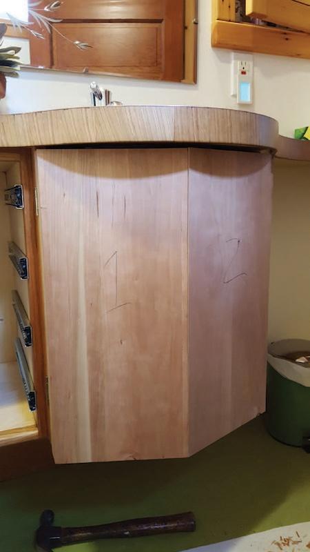

As I was working on the countertop, I was also building the somewhat simple cabinets to support it. I went with a bank of drawers and a pair of curved doors below my sink, but your requirements will likely be much different from mine. I did find the curved doors added a lot to the overall appearance, and they weren’t overly hard to create, so I will share some tips on how to make them here.
By measuring my initial top view drawing, I found that I could get away with shaping the front of 8/4 material for the doors rather than a bent lamination or coopering. Loose pin butt hinges allow for mounting and dismounting the doors multiple times during fitting.

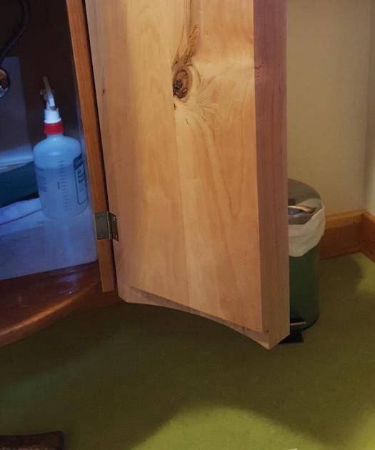

After milling the cherry roughly to size and cutting to final height, set a sliding T-bevel from the drawing and mark the angle on the centre edge of each door.  Stand the doors together on top of the drafting to mark the hinge edge angles. Make the doors slightly larger than finished so that the centre edges can be adjusted once the doors are hung. Use a stress curve to mark the bottom of the doors and chisel out material to accommodate the cabinet bottom, rather than curving the entire inside faces of the doors. Relieve for the sink, if required.
Once the doors are fit, use a stress curve to transfer the curve from the drawing to the top and bottom of the doors. Curve the fronts using a handheld power planer, hand planes and belt sander. To keep the fronts true, I made a jig to hold the doors in position for final smoothing with a random orbital sander. Confirm the fit one last time before varnishing.

Final Design Template
 You can include a lot of information on a top-view drafting. You can even cut out parts to use as sub-templates, like this under-the-counter shelf Schmidt may add later.

Rough Cut Copper
 Rough out the countertop shape and sink hole.
Finish Cut Sink Hole
 To avoid damage to the sink, this edge needs to be final and finish sanding before the copper is glued down.
Faucet Test Fit
 Cut hole(s) for faucet based on manufacturer’s instructions, and test the fit.
Ready for Patina
 The countertop is sanded to a smooth look, and the wood on the sides and bottom are sealed with polyurethane.

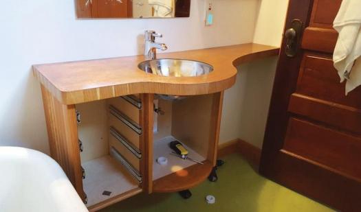

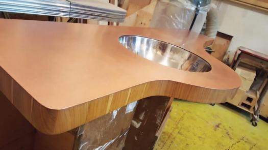

Install Cabinets and Countertop
 Installing the faucet before the countertop is often easier.
Patina
 Splash-effect patina is easily created with vinegar and salt. Play around with some copper offcuts before using the real thing.
Rounded Door Fronts
Small doors can be made from thick material rather than coopering or laminating. Here, Schmidt has bevelled both edges of the two doors, and hung them on hinges attached to the cabinet.
Relieve Bottom Edge
 Chisel a curved area out of the bottom of the doors rather than curving the entire inside surface.
