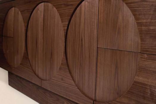

Lately I have noticed my aesthetic in furniture moving towards pieces with subtle contrast. So, when commisÂsioned to design/build a sideboard entirely out of walnut, I couldn’t pass up the opportuÂnity to create a subtle contrast using a single species and my knowledge of how grain reflects light. How the light reflects off the grain direction in the board is what gives it certain tones, and why woods such as curly maple have that striped pattern throughout. Those dark/light contrasts are segments of the board where the grain switches direction. It’s also what makes planing figured boards without tear-out so difficult.
The brief on the commission was a sideÂboard of a certain size containing doors and drawers without visible handles. The circuÂlar cut-out pattern was a way to incorporate handles into the design, as well as add some curvature to an otherwise rectilinear piece. Switching the grain direction inside the circle cutouts from horizontal to vertical produced a subtle contrast in tone; the result is what gives this piece its identity.

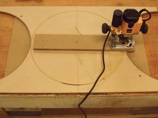

I then took one sheet of 3/8″ MDF the full size of the front of the cabinet (total surface of the doors and drawer fronts) and laid out the doors, drawers, and circles in pencil. Once satisfied, I routed the outÂside two circles using a compass jig and a router. I used a 3/16″ bit, the same thickness of my edging. This allows me to use the off-cut as a caul later, when gluing on the edging.

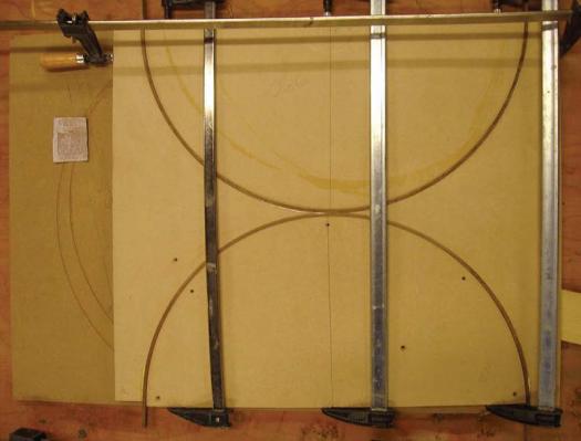

Next, I cut those two outside circles in half vertically where the doors and drawers meet. Using steam-bent edging and the off-cut from the routing, I glue the 3/16″ thick edging onto the circle cutouts. Once the edging is dry and has been flushed, the center circle can be routed.

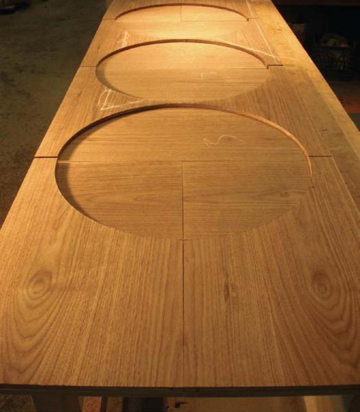

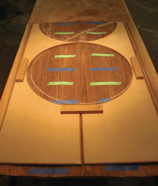

Once the edging is flushed, the veneer is laid out and the panels are ready to be pressed. In order to keep the grain runÂning continuously throughout panels, I pressed them in two halves with location blocks pin-nailed to the back to keep things from sliding around once in the bag.
With the veneer cleaned up and panels pre-sanded, it was time to press the cut-out panels to the backer panels. This was done in the vacuum bag using 3/4″ blocks pinned all around the backer panel in order to keep the cut-out from movÂing off of the backer panel. A glue resist was used to make clean-up easy.

Rout Outside Circles
With the 3/8" back panels cut, Hansuld starts to work on the circular panels for the fronts of the door and drawer panels. Careful layout is essential for the circular panels to finish properly.
Same Thickness Bit
A 3/16" bit was used to rout the circular panels out; the same diameter of the steam-bent edging that was glued back onto the edge. This allows the off-cut to be used as a caul to apply even pressure during the glue-up.
Continuous Grain
The circular panels are machined to size and edged. Now the face veneer has to be applied to their front surfaces. In order to keep the panels aligned, and ensure the grain is continuous, Hansuld secures each circular panel with simple cleats during the vacuum pressing operation. For the sake of simplicity, he presses the left three panels first, then presses the right three panels later.
 Cut them to Size
Now that the face veneer has been applied to the circular panels, they can all be adhered to the rectangular back panels. The doors and drawers can then be cut to size and edged.

 Notice the continuous grain across the circular panels. All that hard work finally pays off. (Photo by Janelle Falconer)
