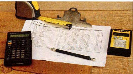

Once the choice of species has been made, the hunt for the perfect boards begins. However, before heading off to the lumber dealer, it is best to do a little preparation. After years of board stalking, I’ve come up with a kit that I always take with me to the lumberyard. Now, returning to the lumberyard to pick up those ‘one or two’ extra boards, has become a thing of the past.
A key part of my kit is the shopping list. After I have worked out the design of a project, I create an inventory of the parts, using Cutlist Plus software. The rest of the kit consists of: a pencil, some white chalk, a pad of graph paper on a clipboard, a calculator, and a moisture meter. I also have a small digital recorder I take along with me, which I use to record special notes or reminders.
At the lumberyard, with the list in hand, I begin to select boards for the project.

Lumber for your projects can come from many sources, but before you can use it to build anything, it must be dry. Lumber that is kiln dried will have a moisture content right out of the kiln of 7 or 8%. However, by the time the lumber is delivered to your local dealer and arrives at your shop, the moisture content may have changed dramatically. Storage conditions between the kiln and your shop are clearly out of your control, so it is always a good idea after purchasing lumber to acclimatize it in your shop for several weeks. To avoid using lumber that is still in the process of adjusting to its new environment it is best to use a moisture meter to verify the moisture content of the wood. Most dealers don’t mind customers checking the moisture content at the yard as long as they are using a pinless meter. The meter in my lumber kit uses electromagnetic waves to calculate the moisture content of a given piece of wood. Its use couldn’t be simpler or quicker – simply turn it on, enter the species, and place the meter on the wood to be measured. The result is displayed right on the screen instantly without the need for conversion tables and other calculations. Typically, I check a couple of areas on each board as I select them just to confirm they are all in the same moisture range. Back at the shop I once more check each piece of wood and note it in chalk on the board. Every few days I’ll recheck the boards, and when the readings have stabilized, I can be reasonably certain there won’t be any surprises when I start the milling process.
Moisture meters available at electrophysics.on.ca
Lumber kit
