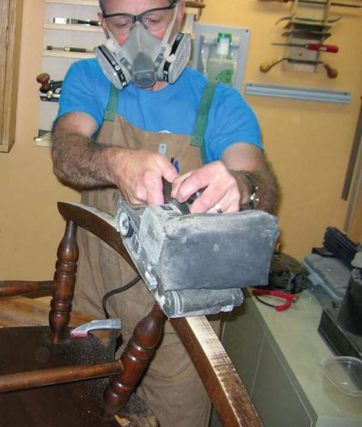

Machine Marks May Date a Piece
If milling marks are visible, you may want to get rid of them. A belt sander makes fast work of marks on the bottom of these curved rails.

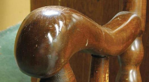

A Few Years Old
Before you add patina, a high-wear area may only have a few scratches and scuff marks.

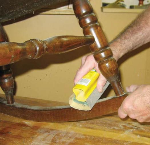

A Century Old
After hitting the area with sandpaper and applying stain, you’ve started to reverse the hands of time. Using some tools to add some wear marks will only add to the look.

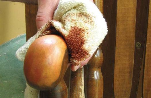

Seeing Is Believing
Adding certain high-wear spots is crucial. Whether it’s feet, hands or objects that would have come into contact with the piece over the years, seeing a certain amount of wear is necessary for the overall look to be believable.
