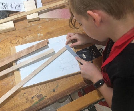

Draw your idea on a piece of paper, then decide the size of the tag and write it onto the page. You can even draw the tag to scale if you think that will help you visualize the project better. We made our tags 4″ long × 3/4″ wide × 1/4″ thick, but feel free to adjust the sizes of your tag.

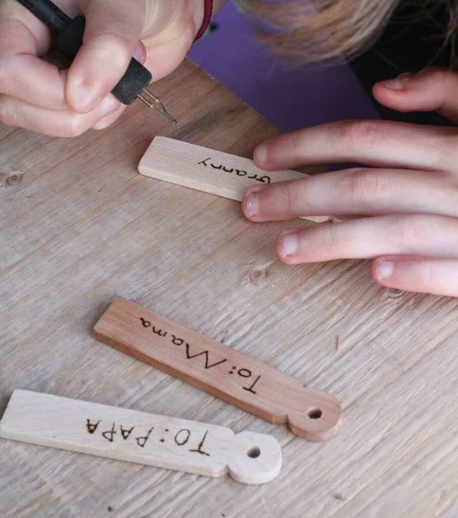

There are a few different ways to add names to your tags. The simplest approach is to just write the name on the tag with a pen, pencil or Sharpie marker. A more complex approach is to draw the names on the tags with a pencil, then carve them out with a V-gouge. A third approach, and the one we took, is to lightly draw the names in pencil then use a pyrography pen to burn the names on.
Once the tags have been labelled you can apply a coat of finish. Just about any clear coat will do, but we chose to wipe on one coat of OSMO Top Oil. Finally, cut and tie ribbons through the small hole.

Name Names
Although you could use a regular pen or pencil, we chose to label the tags with a pyrography pen.
