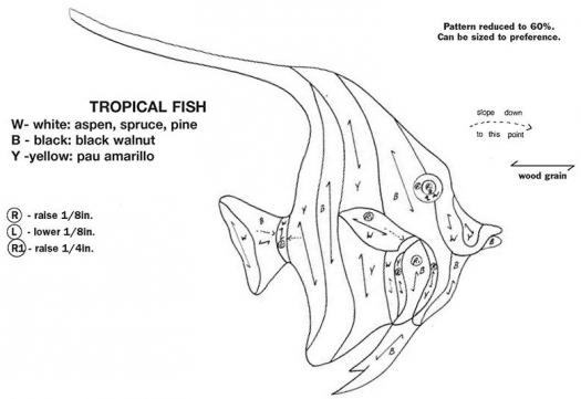

It’s a fairly straight-forward intarsia project: Find the woods of your choice or follow the pattern suggestions.
Tropical fish
Transfer the pattern to the wood
Use one of the following methods:
• Trace directly to the wood with carbon paper.
• Make a template of the pattern from ⅛” plywood, MDF board or plexiglass. Trace carefully, holding your pencil or pen at a 45-degree angle and cut the pieces with a small blade such a #1 or #3 double tooth.
• Make photocopies of the pattern, cut out the pieces and spray glue them onto the wood.
I like to make a template. I find that I get a better fit.

Assemble and check for fit
The fit will work if the pieces are within a saw kerf or 1/16”. Try using a light box to see which places are holding the pieces apart. You may have to sand, trim or even remake a piece to get an acceptable fit.
Raise and lower any pieces the pattern suggests. Glue some scrap to the bottom of the pieces to be raised. To raise the pieces, glue scrap ⅛” plywood to the bottom of the piece. I raise and lower in increments of ⅛”. To lower pieces just resaw them thinner or sand them thinner on a belt sander, again in increments of ⅛”. Resaw any pieces thinner to lower the piece.
After all the pieces are raised or lowered, assemble the project and mark on reference lines. These lines will help with the shaping.
