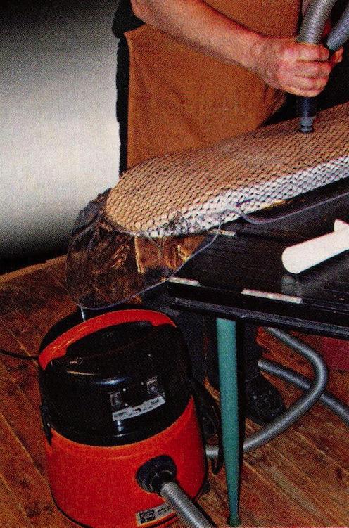

I use my Fein vacuum to remove most of the air – the nozzle just happens to be the same size as the manual pump. The Fein has a separate fan to supply ambient cooling air to the motor. If your vacuum does not, you could cause heat damage to your motor. The manual vacuum pump will evacuate any remaining air quickly. As the air is evacuated from the bag, atmospheric pressure forces the maple veneer to conform to the shape of the Styrofoam mould.

Shop vacuum removes air from veneer bag
