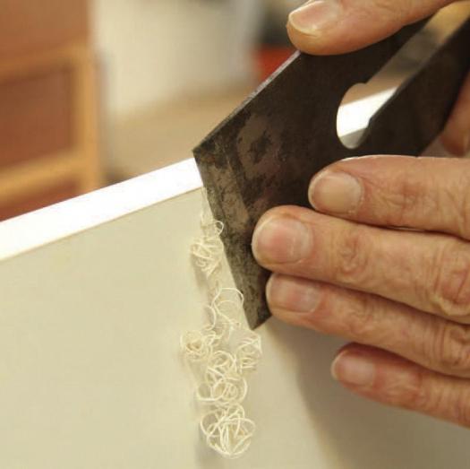

Iron-on tape is easy to use and does a pretty good job at covering the edges of sheet goods. Iron it on, trim the excess with a plane iron that isn’t overly sharp, and sand the edges so it doesn’t chip off.

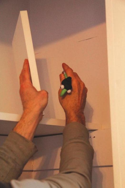

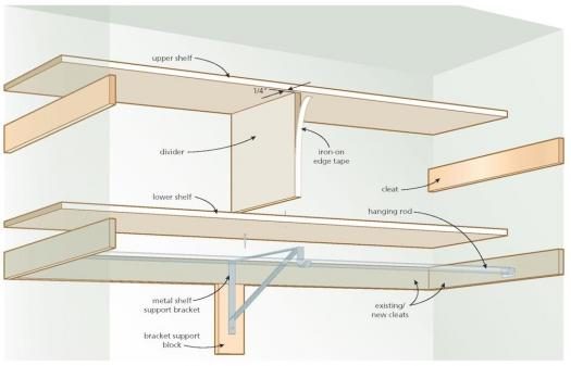

With the lower shelf in place, position the center divider on top of the lower shelf, and against the wall, then draw lines on the wall to mark the top of the center divider. The top edge of the upper shelf cleats will align with these marks.
Center Divider

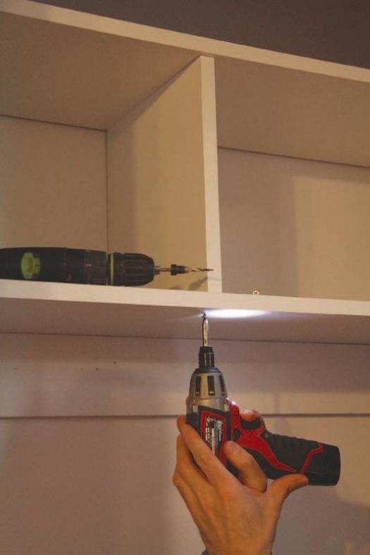

Once Brown has the lower and upper shelves in place, he positions the center divider between them, drills pilot holes, and secures the divider with four screws.

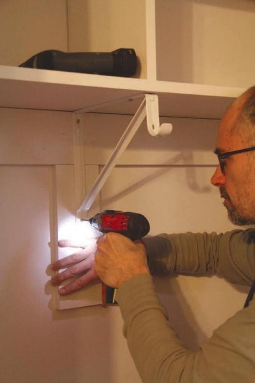

Shelf Support Bracket
A simple 12"-deep metal bracket, with a rod-hanging hook on its front end, supports the shelving assembly. Since the rear cleat keeps the bracket off the back wall, Brown added a piece of material the same thickness as the cleat to the back wall. This piece will transfer weight from the shelf to the back wall, eliminating sag.

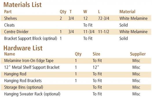

Next, I paid a visit to my local home improvement store and bought a sheet of 3/4″ white melamine, some white iron-on edging tape, a new hanging rod, the brackets to hold the hanging rod and a 12″ deep shelf bracket that would accept the hanging rod.

With some room to move around, I was able to take accurate measurements between the two side walls. In the shop I ripped the two 12″-wide shelves to width, then crosscut them to length at 1/4″ less than the exact measurement, applied iron-on tape to their front edges and sanded all the sharp edges, making extra sure the edge tape was flush – or even sanded slightly below the mating face – so it would not be damaged by sliding out the storage bins.

I placed the lower shelf on the existing cleats, but didn’t secure it in place just yet. I then positioned the center divider on top of the bottom shelf, and against either side wall, and marked lines where the bottom surface of the upper shelf would be located. The upper shelf cleats were then screwed to the wall so their upper edges were flush with the lines marked on the wall.
To fit the upper and lower shelves in place required some logistics. With cleats for both upper and lower levels now in place, I removed the lower shelf and positioned the upper shelf in place. In order to fit the lower shelf in, I had to raise one end of the upper shelf to allow the same end of the lower shelf to be raised above the upper cleats.
Doing this allowed me to fit the far end of the lower shelf above the lower cleats, then bring the raised end of both shelves down onto the cleats. With everything in place I screwed both shelves to the cleats.
Next, I marked the location of the center divider, positioned it in place, counter-bored some holes through the upper and lower shelves and fixed the divider in place.
To create a sag-free shelf I added a 12″ bracket under the center of the lower shelf. Because the cleat on the back wall interfered with securing the bracket directly against the wall, I cut and installed a spacer the same thickness as the cleat behind the bottom portion of the bracket. This would provide something for the bracket to press against when the shelf was loaded with weight. Cut the hanging rod to length,  and use the brackets to install it. Make sure the rod finishes level, so it won’t be an eyesore every time you use it. Cap all the screw heads with white press-on covers to hide all the screws. They’re not for fine furniture, but they’re perfect for this situation.
