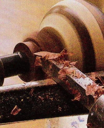

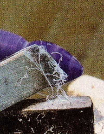

- Size a tenon on the acrylic toe using a skew chisel and a pair of calipers. You also need to turn a tenon on the top knob and then drill holes for the tenons on the body.

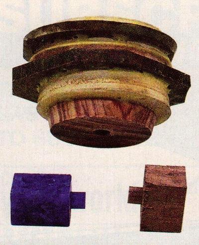

- Glue the three parts of the bob together.
- Shape the bob. Remember to always turn from large diameter to small – this avoids a nasty catch.

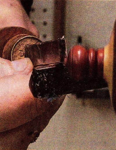

- You can add different decorative features such as a cove or bead. I chose to turn a small bead on the acrylic

- To shape the smaller parts I used a 3-3/8″ spindle gouge, which can also be used to roll a bead.
- Remove the tailstock to finish the toe end of the bob with the toe of the skew. This cut requires absolutely no finishing.

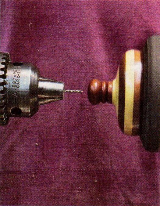

- Drill the hole for the brass eyelet.

Size tenon on acrylic toe
Project parts ready to assemble
Turn bead on toe

Finish toe with skew chisel

Drill hole for brass eyelet
