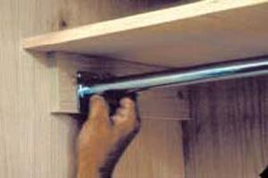

The shelves are all adjustable and I’ve used a little different technique for the supports in place of the usual holes. These metal shelf standards are installed in a groove and are capable of handling heavy loads. They are available in a number of finishes including gold, silver, black, and white. I used the white finish on mine so it would be easier to see in the photographs. However, the gold colored standards might be more suitable with the natural clear polyurethane that I’ve applied.
I suggest you purchase your shelf standards before cutting the grooves. There are size variations depending on the manufacturer and you’ll want to be sure the cut is correct. My standards are available in 8’ lengths and have been cut to size. You should be able to find them in any large hardware store.

Each side A requires a rabbet on the rear inside face that’s 3/8” wide by 1/4” deep. They also need two grooves, 1″ in from the edges, for the shelf standards. Verify the width and depth of each groove by measuring your standards.
Step 2
The shelf standards should be cut 78” long. Install them in the grooves and use the small nails provided to secure the standards.

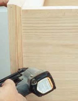

Attach the stiles flush with the outside face of each side board. There are a number of methods you can use to attach the stiles. Glue and clamps, glue with biscuits, or simply glue and face nailing with finishing nails are all acceptable. I used the glue and face nail method and filling the nails holes with colored wood filler to match my final finish.
Install one stile at this time. The other side will be attached after the upper rail is secured.

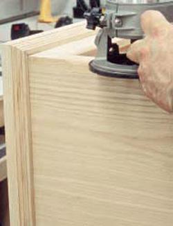

Before installing the top trim, round over the inside edges of the two stiles and top rail with a 3/8” round over bit. The router base plate will be stopped by the base trim and determines the point at which the round over stops on each stile.

Before standing the bookcase upright, round over the outside edges of both stiles. Use a 3/8” round over bit in a router. The upper and lower trim boards will stop the router travel and determine the cut length.
