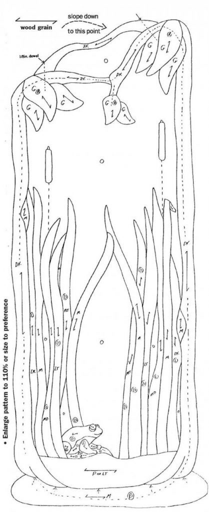

As an Intarsia project it is fairly straightforward. The challenge begins when you add the mirror.

Choose your woods carefully. The pattern provided makes suggestions, but feel free to use your imagination. Your choice of woods is what gives the look and feel of your project.
Transfer the pattern to the wood with one of the following methods: trace with carbon paper, make a template, photocopy the pattern and cut out the pieces and glue them on the wood with spray glue or a glue stick.
Make sure your blade is square to the table, then cut out the pieces. I like a #7P/S blade or a #5H/T. Take your time and cut carefully. Try for as good a fit as possible.
Assemble the pieces and check for fit. Spend some extra time on the fit. The more area that pieces touch each other, the more glue surface there will be. Try holding two pieces together and running a blade down between them.
Raise and lower any pieces as the pattern indicates or as your imagination suggests.

Start the glue-up. Set the project up on a very flat surface and glue it up as if it wasn’t going to have a backing. Clamp the long side pieces in place so it will be easier to hold the rest in place. Use as much glue as you can on the side of the pieces. Make sure it doesn’t come through to the surface of the pieces. Give the project at least an hour to dry. Then, turn it over and squeeze glue into any gaps between pieces. This will add strength. Make sure the glue doesn’t squeeze through to the good side. Insert 1/8″ dowels were indicated on the pattern for extra reinforcement.

Use the dotted lines on the pattern as a guide for the size of mirror required. Cut, or have the mirror cut, to size. Use either ordinary 1/8″ blade glass mirror or 1/8″ mirrored acrylic.
