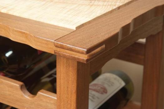

What makes this project interest­ing is that you get to choose the style you prefer. In this table, the “cloud lift” profile in the walnut frame surrounding the top was strongly Greene and Greene-influenced, while the outward-curving legs were another North American interpretation of Asian furniture treatments. If you don’t want an Asian-style piece, however, it’s a simple matter to replace the “gumby” legs with ones that are straight or tapered. The same applies to the frame around the table’s top. You can lose the cloud lift pro­files, replace the bridle joints at the corners with mitres or use a slab top instead of frame and panel.

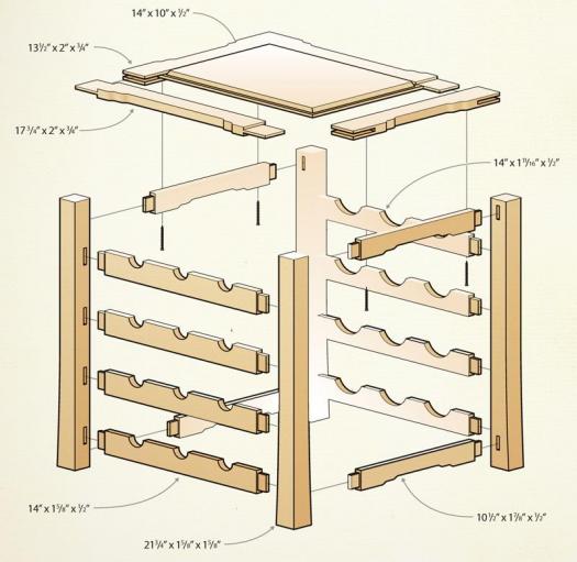

Full-scale drawings or patterns are a good idea with this piece. You’ll be cutting 24 mor­tises and fitting their respective tenons into them. Measuring each of their locations indi­vidually is a recipe for disaster; ticking off their locations from marks on a template is less risky. (It doesn’t mean you can stop think­ing; you still have to mark the correct sides of the components.) Full-size templates or models also help you to envision how the final construction will look. And if the design you’re trying just isn’t going to work, it’s less painful to scrap a piece of plywood or pine than a piece of walnut or birdseye.

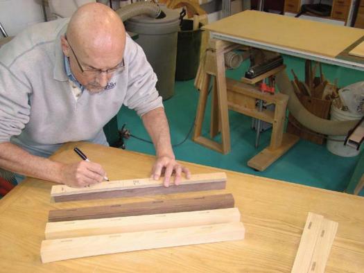

The legs are the structural elements and support the table’s framework and top, so we start with them. It’s easier to cut mortises into stock that is still square, so mortising is done before any other shaping of the legs. Begin by marking the locations of the six mortises in each piece, using the template you made. (You did make a template, didn’t you?) Pay attention to grain direction and pattern, and mark each leg with both its position and orientation so it doesn’t get turned around. How you cut the mortises is up to you. I used a hollow-chisel mortiser. Plunge routers, Forstner bits or mortising chisels do just as well.

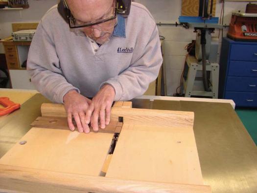

I cut the tenons with a dado set on the table saw using a single setup – a huge timesaver. With the workpieces sup­ported by a sled I could use a single height adjustment for the blade, while a stop block clamped to the sled regulated the length of the tenon. After refining the machine setup with a test scrap, cutting perfectly-thicknessed tenons was a breeze. Then I marked the width of each tenon directly from its corresponding mortise, trimmed these to size using a hand saw, and the tenons were done.
Another timesaver was to dou­ble up the width of the stretchers that would support the necks of the wine bottles. They would have a 1-1/4″ hole bored through them along their cen­tre line. Once the tenons’ thickness had been milled, these pieces could then be ripped in half, yielding two for one. With this done, the tenons’ widths were laid out directly from their correspond­ing mortises – the same as for the other components.

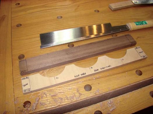

The stretchers that hold the wine bottles’ bodies had their curves cut out on the bandsaw and then faired with rasps. If you prefer, you can make a template for the stretchers, rough-cut them to size, and then use the template to pattern-rout them to final dimensions. However you make them, once they’re cut to finished size, run around their edges with a bearing-guided round-over bit on the router table.

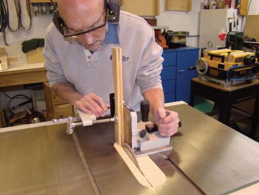

The female portion of the bridle joint for the tops’ frame can be cut by hand, on the bandsaw, or on the table saw using a tenoning jig. The mating male joint can be cut using the same tools, or they can be milled to their proper thick­ness using a dado blade set and a sled on the table saw.

Try a Template
 To increase your chances of success, make a template for the mortise locations. It will virtually guarantee all your mortises end up in the correct location.

 A sled for your table saw, designed to work with your dado head, makes cutting tenons very straight-forward. The front rails are machined in pairs, then once the wine neck hole has been drilled, they were ripped in two on the table saw.

 The back rails can be marked from the template. Then cut the arcs with a coping saw or bandsaw and clean them up on the router table.

 Perry uses a tenoning jig and a table saw to machine the first half of the bridle joint in a single pass. This joint will secure the four frame pieces that surround the top panel.
