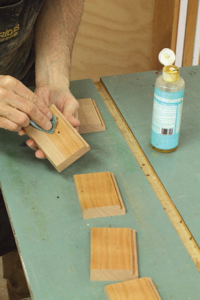

Because it’s harder to apply a finish to the inside surfaces of the sides after assembly, I applied a few quick coats of shellac to those six surfaces now. You could also use any other wiping finish. If you’re going to spray a finish on you can likely hold off on finishing the surfaces at this stage. Either way, make sure the surfaces are sanded smooth before assem­bling the box.

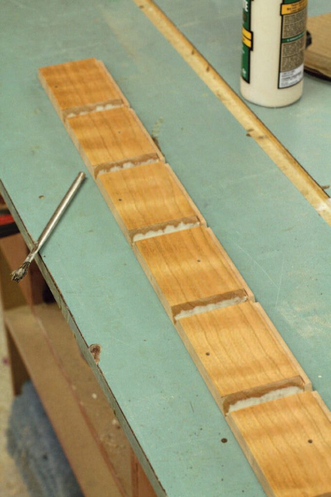

Lay the six sides down on a flat surface with their inner faces down. Apply mask­ing tape over the five mating joints. Flip the assembly over and apply a bit of glue to the end grain of all the parts. Too much glue will make a mess, but too little glue will cause a starved joint. If you did apply a finish to the inner faces already, that will help you with removing any squeeze-out afterwards. Wrap the entire assembly together and apply more tape across the last joint. Put it aside to dry.

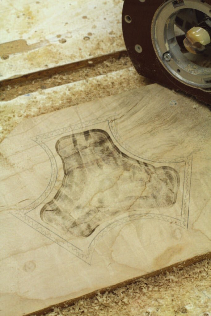

With the outer line marked on the tray blank, I added the curved edges on three of the sides. These lines will be the outer shape of the tray. Next, I offset these lines by 1/4″ towards the inside of the tray. These lines will guide me while I shape the cavity in the tray.
With the tray workpiece still large, I secured it to a work surface. I chucked a dish carving bit into my router and set the depth of cut to about 1/4″. Moving the router freehand, machine up towards the inner line, leaving about 1/16″ of material on before routing the line off. I started in the centre and worked my way towards the line as that provided better support for the router over the operation.
I used a combination of carving gouges, sanders and hand sand­ing to smooth the surface and even out the outer edges. When I was happy with the cavity, I cut the tray out and shaped it to fit the inside of the box nicely.

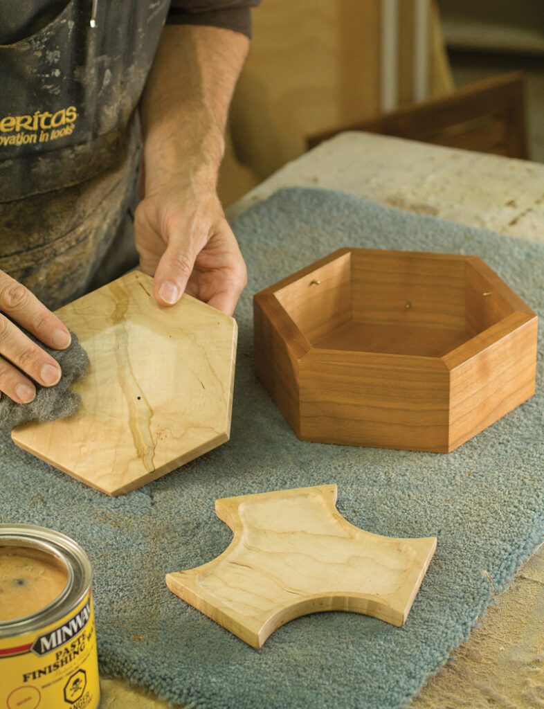

Finishing touches
Sand the box and ease all the edges. Apply a finish of your choice. The good thing about a jewelry box is that it won’t get a lot of heavy use, so wear and tear isn’t a factor when choosing a finish. Shellac goes on smooth and dries fast. I applied many coats in an afternoon and the finishing process was done. It also buffs smooth with wax and #0000 steel wool. How the finish brings out the grain and colour of the wood you chose is also a strong factor when selecting a finish.
At this stage the bottom was still not attached. I applied a finish to it after I taped off the glue surfaces, then installed it with glue.
To install the brass pins, mix up some epoxy and put a bit inside a hole, then press in the brass pin. If you put the right amount in the hole, no epoxy will squeeze out and make a mess, but enough will be in the hole to hold the pin securely.

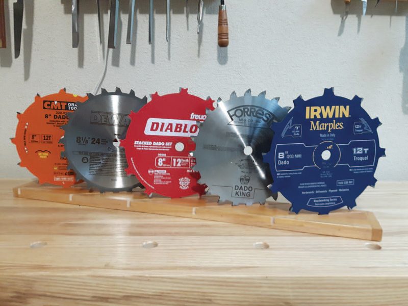

Cutting Dadoes, Rabbets and Grooves
While you can cut dadoes, rabbets and grooves with a standard blade making multiple passes, it’s a lot easier, faster and more accurate with a stacked dado blade set. This set includes a blade for the two outer sides, as well as a series of chippers to allow you to adjust the width of the cut. Thin shims will allow you to further dial in the width of the cut. Read our in-depth review of the five top dado blade sets for 2022.
stacked dado sets

First Coat Before Assembly
It’s easier to apply a finish to the inner faces of the sides before assembling the box. Brown used shellac because it dries quickly, buffs smooth and looks great, but other finishes will work well, too.

Tape, Glue and Wrap Together
With the sides taped together end-to-end, Brown applies glue to the joints and wraps the sides together. Any glue squeeze-out is easier to clean up with the inner faces of the sides pre-finished.

Rout the Cavity
A dish carving bit chucked into a router will make quick work of most of the waste in the centre of the tray. Freehand the router as close to the line as you can, though hand tools will be used to further smooth the cavity.
