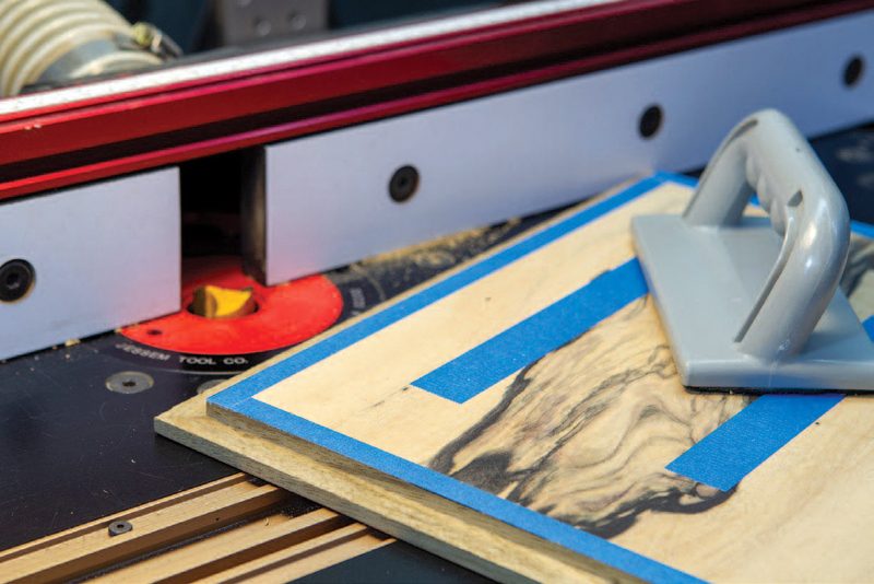

Next, create a rabbet on the edge that’s 1/2″ deep by 1/4″ thick. Part of this rabbet will fit into a 1/4″ groove in the frame for the tabletop. To help eliminate the risk of tear-out, use strips of blue masking tape along the edge of the top. I also put a couple of strips in the middle to stop the face veneer getting scratched as I slide it along the router table. Firmly push down the blue tape with a round-faced hammer. Take small incremental cuts until you reach the desired profile.

Tape Prevents Chipping
A layer of tape will help keep the wood fibres in place while you rout the rabbets on the edge of the top.
