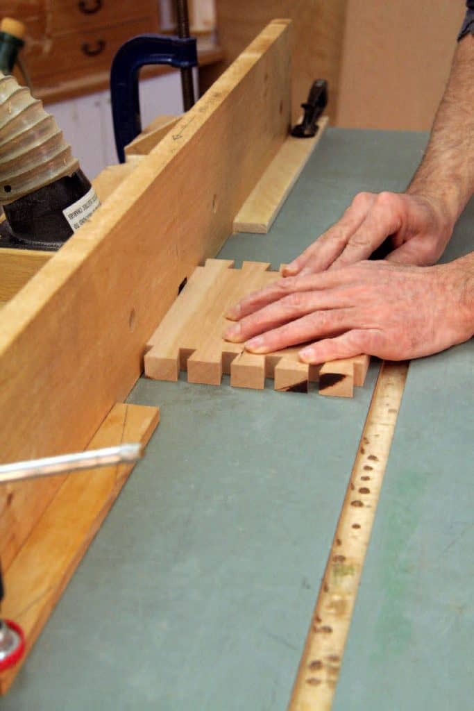

I opted to use the Leigh TD330 dovetail jig to machine the dove­tails in this project. Once the router is set up, and you’re familiar with the process, making dovetail joints with this jig is super sim­ple. The only slight drawback with using this jig is that it doesn’t allow for variably spaced dovetails. That wasn’t a big problem, as I had some flexibility as to how wide to make the joints. Making the sides and ends 3/4″ lower would have made it easier to grasp the cans and remove them from the caddy, but that would have meant the dovetail spacing would have been a bit awkward. If I lowered the height of the sides and ends by more than an inch, the tops of the cans would interfere with your hand while carrying the caddy. I went with nice-looking dovetails on this project, as I’m sure any recipient of free beer is going to find a way to get the beer out, even if they have chubby fingers.
Dovetails are usually oriented so they will mechanically keep the parts together in a certain direction. For this project, there’s no real incorrect way to orient them. I opted to machine them so they’re visible on the narrow ends of the finished caddy, as opposed to the wider sides of the caddy. The only time this will be important to remember is when I discuss machining the grooves to accept the bottom. The groove in each of the ends needs to be stopped, while the groove in each side doesn’t need to be stopped, but that’s only true if you orient the dovetails as I did.

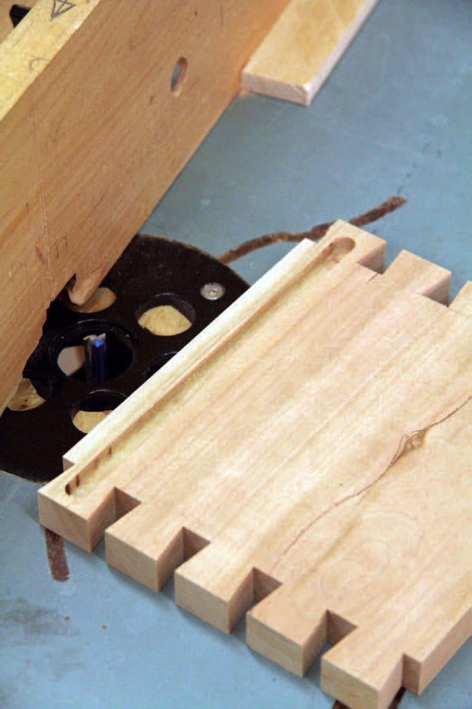

Because I didn’t want a groove to be vis­ible from the outside of the case, I had to machine stopped grooves in the two ends. The router table is a great machine for this. Install a 1/4″ diameter straight bit in your router, fix it in your router table and adjust the height to 1/4″, then set up your fence to machine the grooves somewhere within one of the dovetail portions of the joint.
Now for the “stopped” portion of this joint. Using one of your end work­pieces as a guide, clamp two stops to the router table. These stops will allow you to position these two workpieces at the cor­rect point to start the groove just inside the leading edge of the workpiece, then to stop that workpiece from travelling past the trailing edge of the workpiece. Machine these two grooves, then remove the stops and machine through grooves in the other two end workpieces.

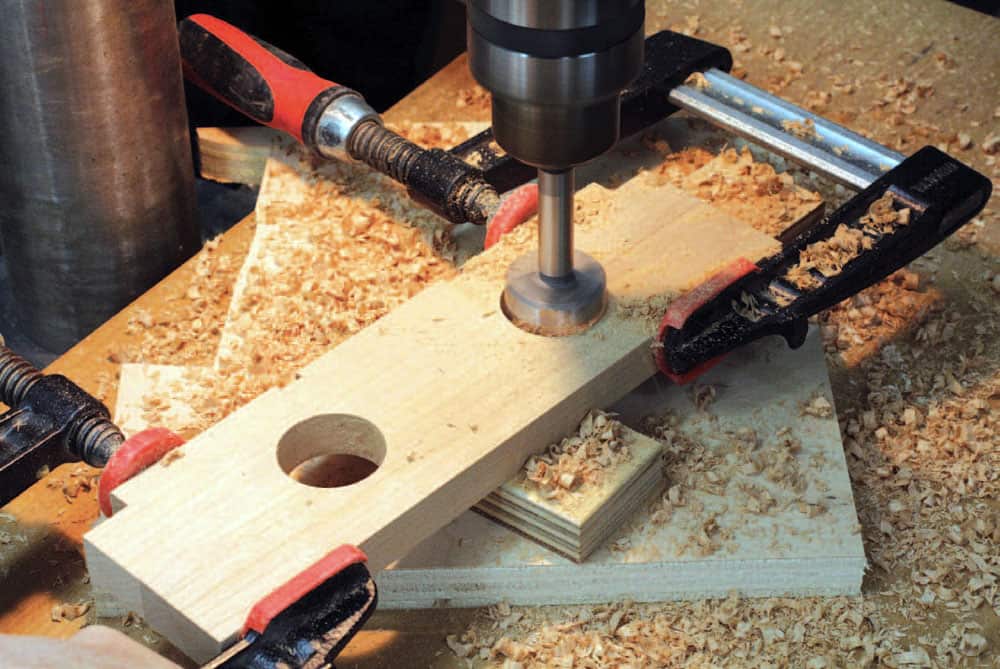

The upper handle half

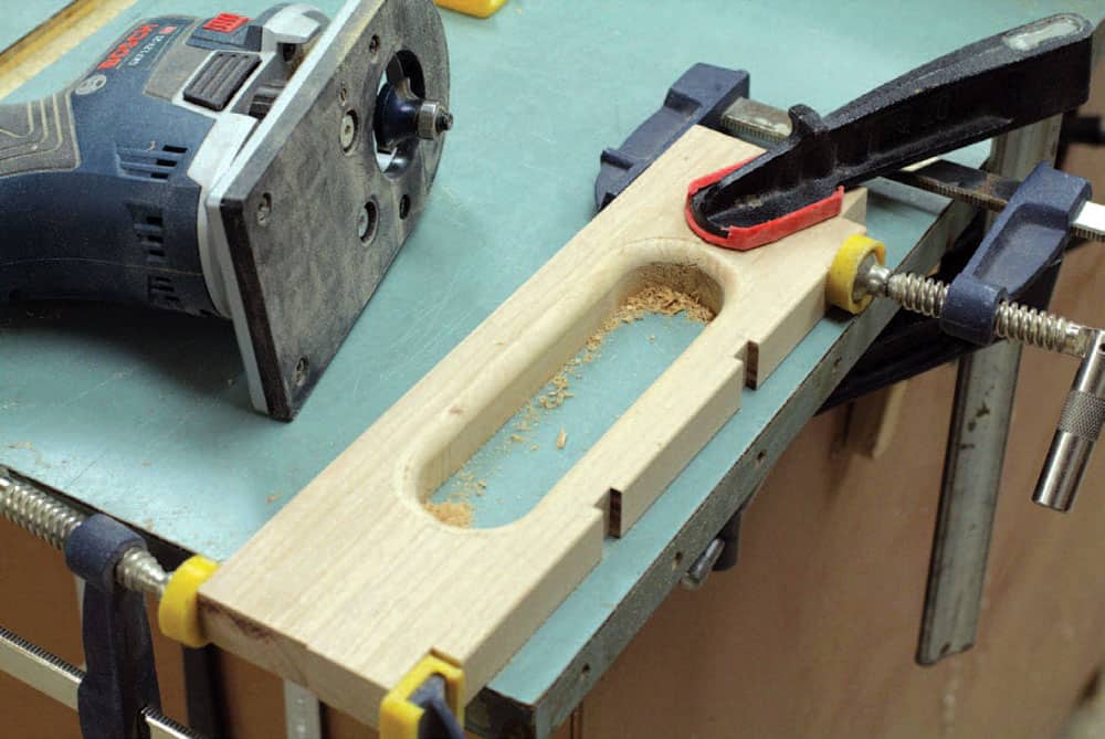

With this workpiece already broken out, clamp it to the lower han­dle half and drill two 1-3/8″ diameter holes to form the outer ends of the handle recess. The exact size isn’t crucial, as long as a person’s hands can comfortably fit inside the recess, and the recess isn’t so large that the upper portion of the handle is too weak.

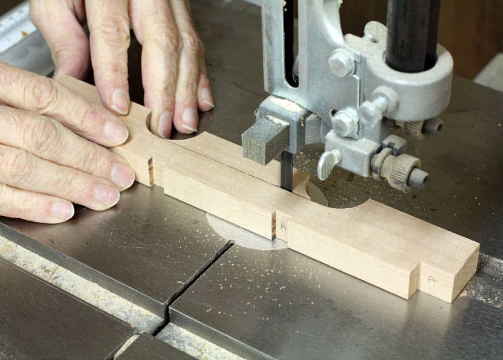

With the holes bored, unclamp the parts and remove the waste with a band saw. Clamp the parts together again, and use a small trim router to machine a small round over on both sides of the recess. You may have to adjust the location of the clamps while you rout to be able to round over the entire edge.

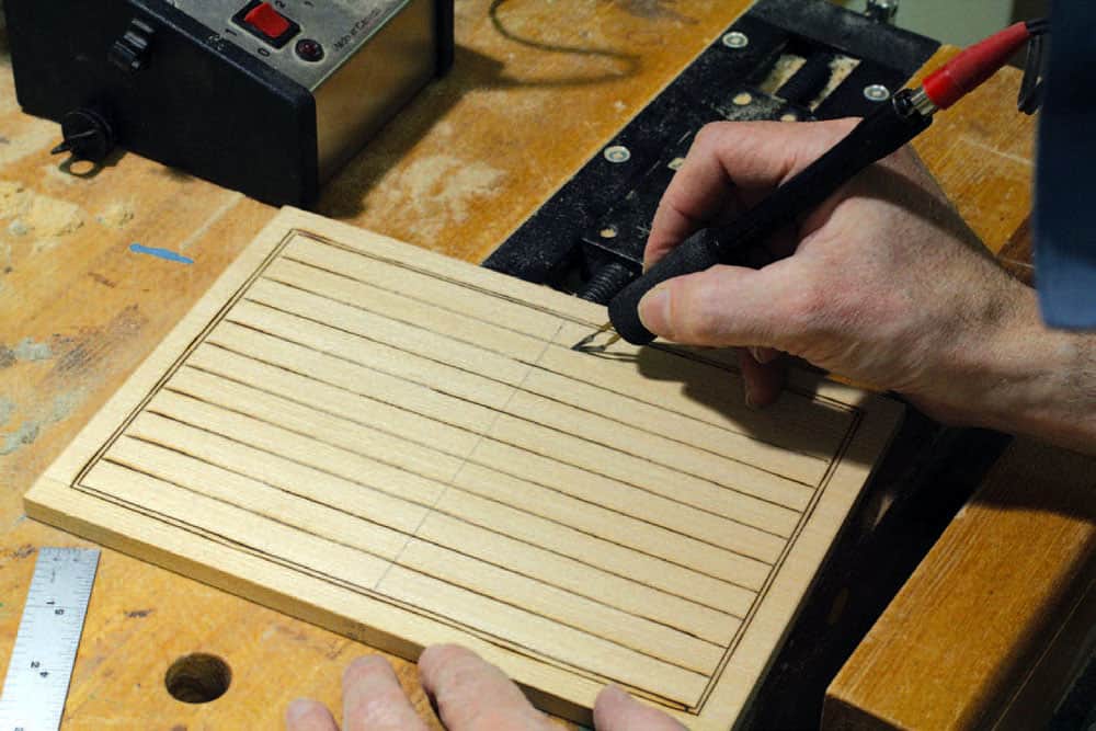

Machine the bottom to fit into the grooves. I used a pyrography pen to add lines to the underside of the bottom so folks could write their name and date in each box as they pass it on. I laid it out in pencil first, then went over it freehand with my pyrography pen. I also added my email address to the upper face of the bottom in hopes that people would send me a note as to where the caddy was as it travelled.

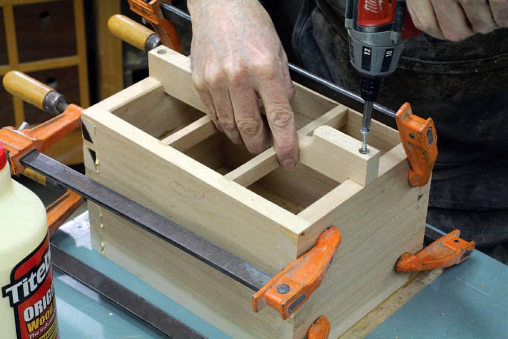

As always, a dry run to ensure all the parts fit together nicely before adding glue was necessary. I lightly sanded the inner faces of the four main case pieces, the divid­ers and the handle halves. Working quickly, I glued the dovetail joints, assembled the four case parts and the bottom, then applied clamps to bring the joints together.
While that was drying, I installed the two dividers with a bit of glue, followed by the lower handle half, and sunk two #8 × 2″ screws to fix the lower handle half in place for good. On top of the lower handle half I glued and clamped the upper handle half, making sure to align the two halves accurately so there would be mini­mal sanding once the glue was dry.

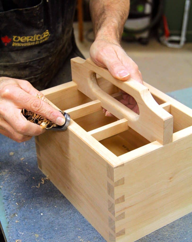

An hour later I scraped excess glue away, then waited overnight until sanding the handle so it looked like one continuous piece. A block plane added a fairly heavy chamfer to all of the edges so any wear and tear would be less visible.

Fast and Accurate Dovetails
Dovetails are not only strong and beautiful, but can also be cut quickly. Brown used a Leigh TD330 dovetail jig to rout the dovetails for the case.

Stopped Grooves
To accept the bottom panel, the ends of this beer caddy need stopped grooves. Without them the grooves would be visible on the exterior of the case. Notice the two wood stops positioned at the start and end of the cut. The grooves on the other two case pieces don’t need to be stopped, as the ends of those grooves will be covered by the dovetails in the end workpieces.

Clamp and Rout
With the two handle halves clamped together, rout a round over on both sides of the handle recess.

Handle Holes
With the two handle halves clamped together, Brown bores a pair of 1-3/8" diameter holes in them, centered on the joint.
Handle Holes
Trim the Excess
After marking a line tangent to both of the holes, Brown cuts the waste free, forming a recess for people to grasp.

A Place to Write
Brown uses a pyrography pen to create a surface on the underside of the bottom for people to write their name and the date, so there will be a record of who gave this beer caddy, and when. This could also be done with pen.

Start the Assembly
Apply glue to the dovetail joints, bring the case sides and ends together, with the bottom panel inserted into the groove. Clamp it up, then add the two dividers.
Start the Assembly
Lower Handle Half
Add glue to the joints securing the lower handle half to the case, then countersink for a screw to secure the handle in place.
Lower Handle Half
Upper Handle Half
Apply glue to the edge joints, then use two clamps to ensure the joint meets flush. Use a few more clamps and a pair of cauls to bring the joints together.
Upper handle half
